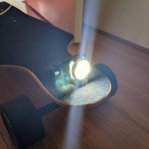

Really loving this setup. Comes on and off in 15 seconds, rechargeable, and super bright.
If I had to ride with only one light, it would be a headlight.
I recently printed this for my 2 18mm lights. They work great. I do have some issues with it making rattling noises. Does anyone else have this problem? It’s not that big of a problem but i hate it when my board makes non electric noises.
you could do a layer of VHB or glue it to the deck but then it would be stuck on there.
what’s vhb?
Very high bond tape
