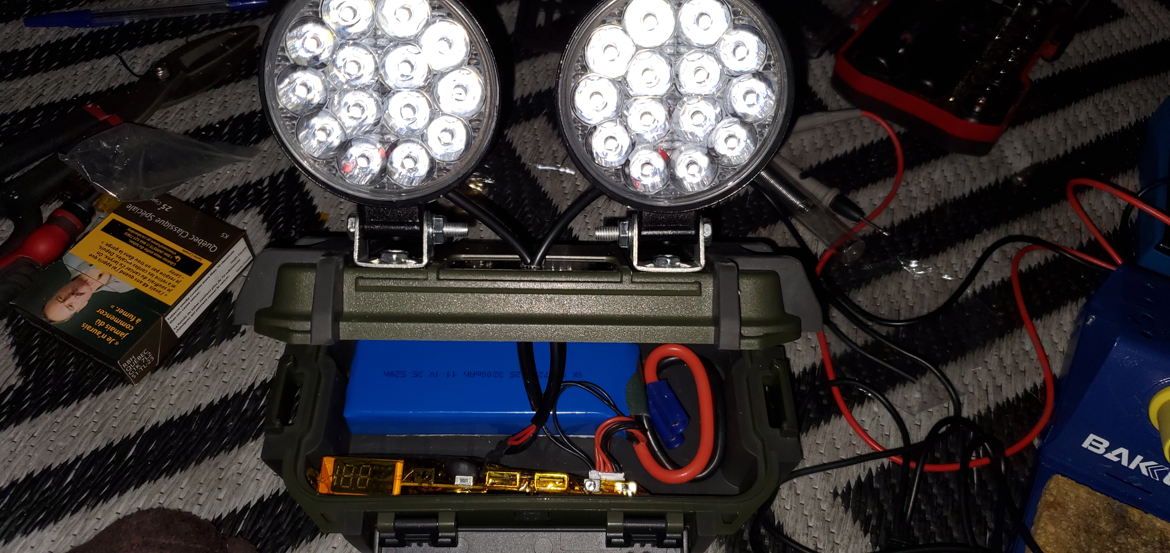

I made a portable version for my MBS build so I don’t have to keep them on there

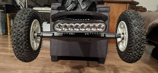

I have that same light. Did you make that mount yourself?
I used the mount that came with it to be able to adjust the angle: Nilight 2PCS 18W 1260lm Spot… https://www.amazon.com/dp/B00G620ZVU?ref=ppx_pop_mob_ap_share
Plus half of this: LAMPHUS Cruizer LED Off-Road… https://www.amazon.com/dp/B01FETT3FO?ref=ppx_pop_mob_ap_share
