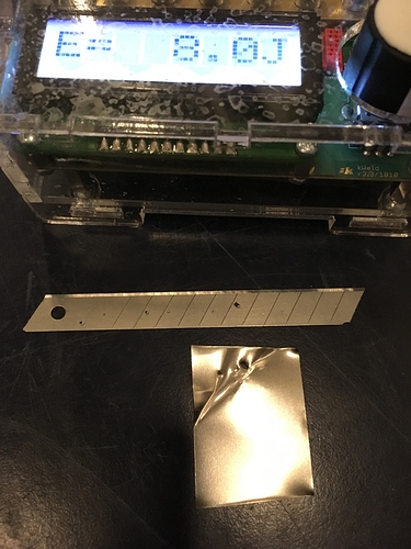

Wow that is a lot different than my settings. I think mine is at around 1100a and 27J gives a good weld single layer and i started tacking down the second layer at 50j, seems to be ok.
Around the same here in regards to the first layer. No idea how 8 could be enough lol
Starts ripping holes in the Nickle when pulled of with pliers at 6j but only on 1 terminal constantly, 8j rips a hole in the Nickle on both contacts for me

That’s a clear sign of bad calibration, please repeat that and check. 8J barely be enough to weld 0.1mm nickel.
The joule metering algorithm automatically adapts to varying situations (battery voltage, current, corrosion,…) A higher current allows to weld thicker material, and it keeps the pulse duration shorter. The latter is desirable as it avoids heat spreading out during the pulse. That causes some variation, and is generally good to experiment to find the correct setting before making large batteries. Do this for each type of connection: strip to negative, strip to positive, strip to strip. Different types of batteries again can require varying this, because they may have cans of different thickness for example.
