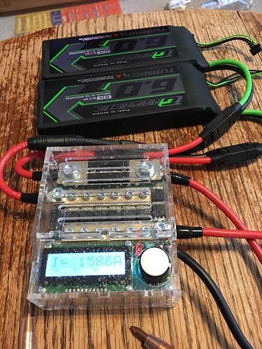

Just put the XT150 wire AWG10 cables on with a lot of difficulty tho this haven’t done any were near as much as I hoped to reduce resistance.

It’s wired is 3s2p trying to up the ampage getting a extra 200amps was at 1400 amps by paralleling the 2nd pack with XT 150 in stead of the xt90 I gained the extra 200 amps gains a extra. This is with unbalanced battery’s at 11v might get more if I charge them both up.

Do you have a photo of the setup? What power supply are you using?
I gained 20 amps by pushing the tips like this in stead of pushing the points together like I did before thought it make a bigger difrence.
There is more I could do have 2 supply wires bolted on to the K it’s self would help a bit more guessing 5-20% more amps in shorter cables and less connector resistance.

So I charged the battery’s back up last night tryed again
Calibration results
So with the battery’s up at almost the units limit 1800 amps I tryed on a craft blade
Was actually almost sticking ok so just to make sure I did a 2nd I thort would overdo it
This didn’t over do it as much as I thought one was grate the other contact was midyoka I had a few jumping sparked and the temp is quite high in the Nickle but I can still hold it and it drops down to warm in the hands after a second. You would need to go very slowly on a pack to not build the heat up to much and have brakes to let the pack cool down
So from what I can understand so fare you need a minimum of power sourse supping over 1500 amps so minimum of dule battery or dule kCapps to do 0.3mm
I’m doubtful my battery’s can sustain this for very long befor thay need charging and I would question the reliability of the weld but hoping some one can show me how there are doing it. On the other side with the alterations i have done in XT150 and using 10awg for the Ysplit I am convinced if you could purchase 0.3mm Nickle with slots this unit could weld it consistently
My conclusion can the Kweld do 0.3mm. technically yes
Would you recommend people useing 0.3mm strip with the Kweld. No as I believe that it’s at the limit of the capability’s of the unit and wouldn’t be happy with the consistency of the results.
I hope I have provided enough evidence and information for people to make up there own minds about the unit welding 0.3mm on to 18650 cells pack. I’m still hopeful some one will show me there setup and how thay achieved it but Just because some people say thay have but not followed it up with pictures I’m still sceptical pleas show us.

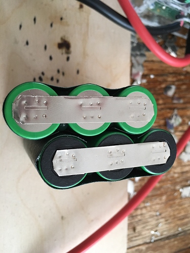

In case any one is wondering just done another 360 welds at 15 jules for the 2nd and 3rd layer of 0.15 (15 jules on the 2nd layer I fined welds the 2 layered to the battery terminal and is very strong
battery’s stone cold at 4.11v a cell
Electrons and all cables a little raised in temp the say up a few degrees the XT90 on the battery’s are a little warmer and the hottest part of the system is the XT150 so it seems that is the most limiting part of the system still but I think it’s no more than 30 degrees so I’m happy and not changing it.

Hey guys, im running this lipo with the kweld and looking to weld series connections 0.15 nickel over 0.15 nickel parallel connections already welded to the cells, any recommendations on joule setting?
Battery’s were outputting 1600-1800 amps so might need it a little higher. First layer I was doing at 8 ish jules
