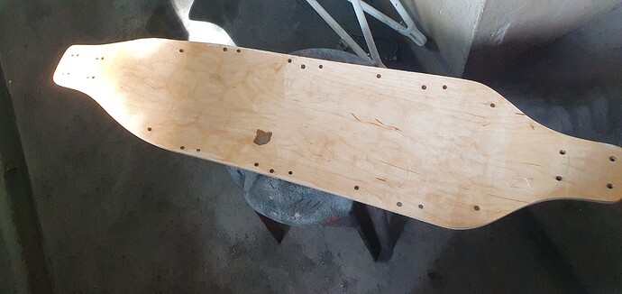

I got my hands on a used Eboosted enclosure so I had to strip it down and clean it up, and fiberglass over the existing holes.
Got it sanded down, and will paint it soon
And for the deck. As we all know, 39 Evos are not on the shelves anymore, so I had to get hold of one, luckily @Bobby had one and came thru. Don’t ask me about what happened with the deck, all I can do is give it new life.
More to come soon. But here’s what I have already! Thanks @xsynatic for coming thru
I had a pair of BN 184mms and test fit it, it fits surprisingly snug, definitely because it was CNCed.
Also tested it on a pair of 218s. Works well, i’ll order a set of BN 220s soon.

That deck was the first of my 4 evos. So many mistakes made smh… it was just sitting around and not being used. I hopped on the chance to send it to @Linny and see what that genius was gonna with it!!!
I’m excited to see what you do with those drives. Part of me really wanted to go with some 100mm+ inrunners out the back

Big mess underway, check back tomorrow
All sanded smooth, and holes are filled
Fiberglass time, lathered a layer of resin, and laid one layer of cloth. Will repeat on the bottom once this cures, then it’s time to sand it down and round all the edges, ready for paint
Fiberglass trimmed, all sanded and edges are rounded. Here comes the magic
Tadah, primer goes on now. I’m kinda out of paint colors, and am still indecisive on what color scheme to go for. The trucks will be black, motors will be chrome, and a couple pieces on the Bevel gear drive are red…
