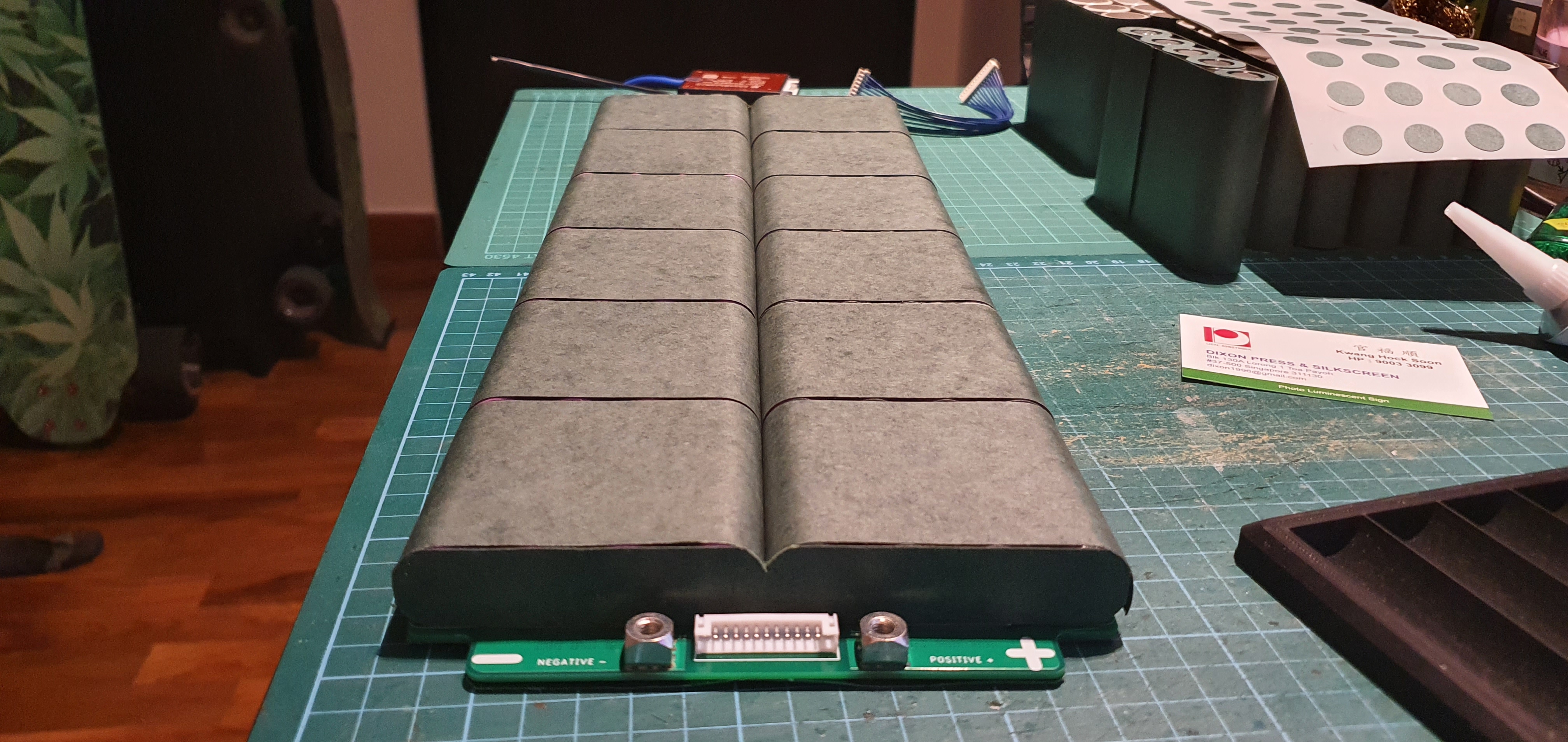

Also for the battery, a 12s4p 30q. Yea it’ll probably be the last 30q pack I’ll build. Just finishing what remaining cells I have. Using the DRI pcb. Wow that’s a lot of space left
With the remainder of my 30qs, a 12s4p will emerge. Siliconed the P groups. Gonna build with the DRI PCB for the first time soon, exciting!
Fishpaper time. Wrapping all 12 groups
Also started a bit of soldering on the PCB. The bush terminals were alright, but the 13 pin connector was so tiny I had to use my phone and zoom in and look from its screen.
Here are the p groups. Gonna start welding tomorrow.

More work on the 12s4p pack.
THE @DRI PCB kit is such a beautiful thing. Look! No wires! Well, not entirely but it cuts down the tangleness by so much. I also made sure to fishpaper the crap out of every edge. Including the bottom of the PCB
