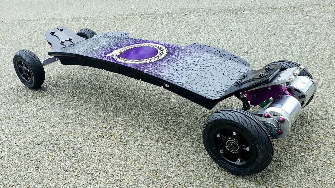

This is a build by @DerelictRobot. I rode it once. It was pretty carvey, maybe he can chime in on the exact setup and pros/cons
Very awesome build @DerelictRobot, mind to share some pro/cons with this style of build? What deck is that lacroix?
It‘s a kaly deck, but I think the direction you want to go.
Yep, its all right here.
Yes this is it, very cool looking build. Something like this what i have in mind so far but i want to try with tkp. Thanks for the share.
I would definitely use adjustable base plates in the future, here I used what I had. The major downside was height from the road, adjustable base plates mitigate some of that.

I prefer TKP’s, it take a little longer to dial in the bushing setup but the ride is carvy and very stable at high speeds.
I swapped the Trampa trucks in after I lathed the axles to 8mm. I wanted to try some different wheels on spring trucks to see how they performed and what the ride quality was like. I will probably go back to TKP’s when I build a new battery for it.
Spring trucks are fun but it takes a lot more lean to achieve the same turn radius as TKP’s. That’s fine on numies, but not so great on thane. The other issue with spring trucks is they get wobbles at speed. Im currently using dampas, which mitigate some of the wobble. I have some bushings (spring replacements) I am going to try too.
I don’t imagine it will make so much of a difference that I will choose channel or TKP trucks though.

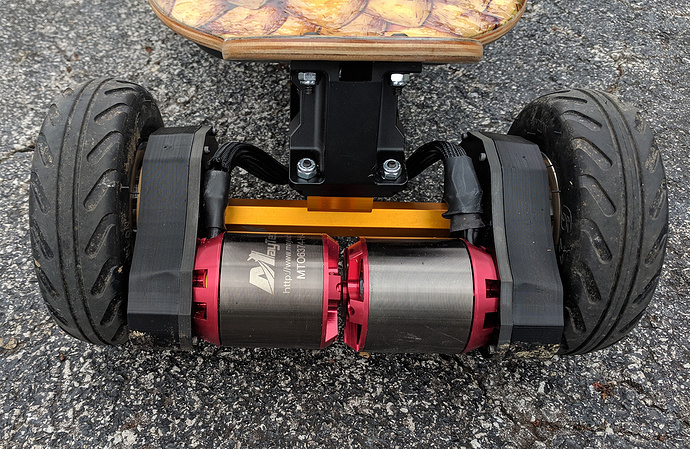

Talk to @akhlut and see if you can get some of his extended axles, assuming you are using Surf Rodz TKP’s. These axles make SR TKP’s a whole new thing. You can fit longer motors and there’s no way to get the motor alignment wrong.
Also, @rey8801’s Hammock SR TKP base plates are incredibly well built and easy to install.
