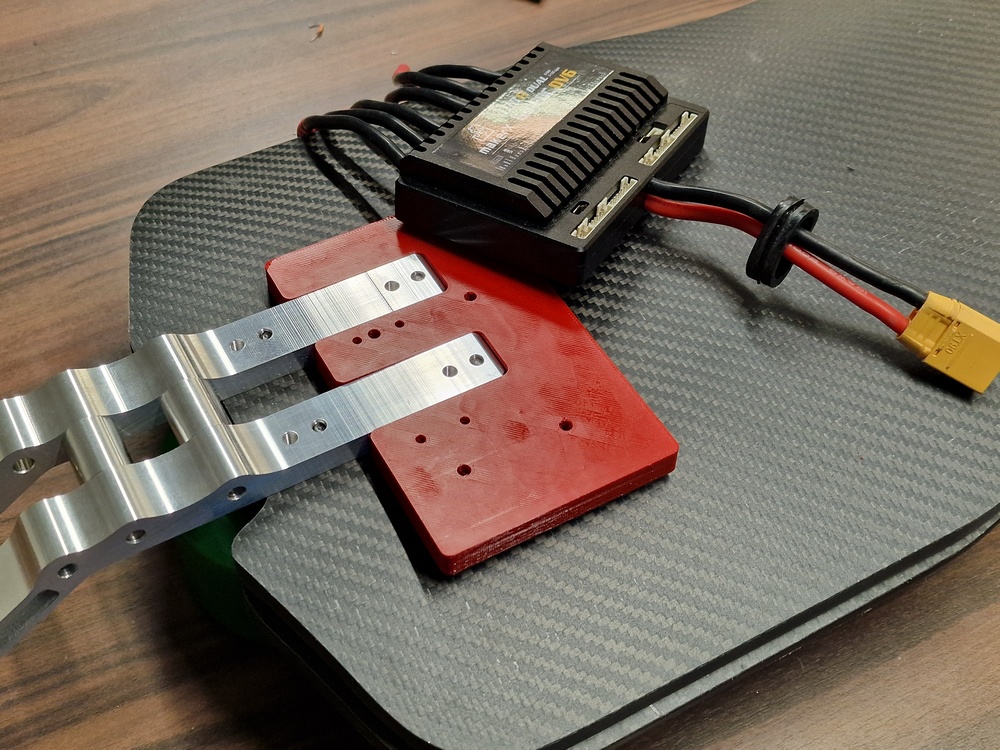

Conceptual heat sink integrated into the bracket, heat from the heat sink is transferred to the bracket
What’s in the pictures is a plastic prototype
An idea implemented a year ago in a slightly different way but tested and works.
Unfortunately I do not have a photo of the interior of the prototype but the ESC had a separate enclosure in which the lower part was made of alumunium and was integrated with the bracket

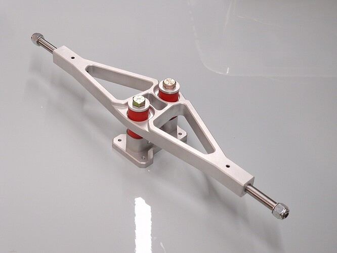

one type of bracket, two different trucks (RKP and DPKP).
12 months after the premiere of the prototype, I introduce our own DPKP trucks for sale.
It is known that this is not new, the precursor was Nosno (1992), later the idea was resuscitated by Etoxx, Apex, Trampa, Scythe and maybe a few others that I don’t know about :slight_smile:
I’ve never owned any PKP trucks so I can’t personally compare my trucks with other such trucks.
Ok… let me get to the specifics
The first version worked acceptably but had a tendency to wobble when unbalanced wheels were used.
The precision of the trucks was not good, it could be eliminated by using hard bushings, but with a hard bushings, the board was not very maneuverable and responded poorlyTo improve the precision of the trucks I added spherical bearings,
I did not know that Etoxx had done this before :confused: although not new, many trucks use spherical bearings to improve driving precision.
Now they work perfectly :grinning:

I tested various hardnesses of bushing, sometimes used mixed sets in one truck
Currently in the front truck I have bushing 80A, angle of 45 degrees
In the rear truck 90A, angle of inclination 35 degrees
I used classic 3/8 inch kingpins because I wanted to be able to use classic bushings.
Cross dimension of hangers is 20x20mm, chamfer 1mm
