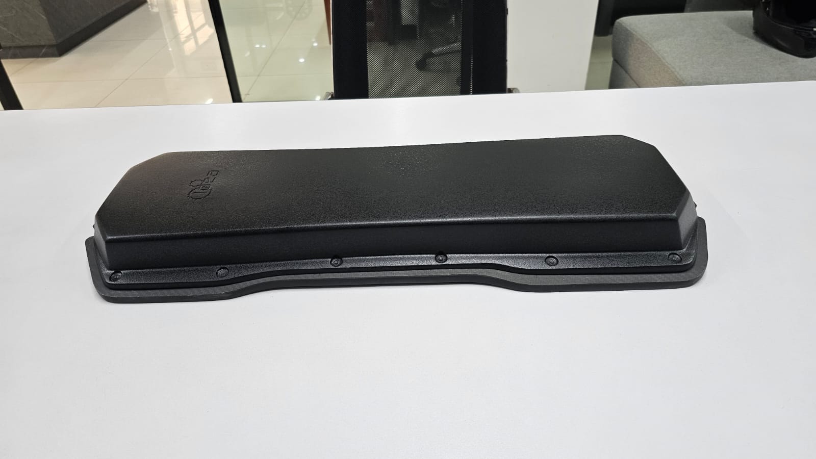

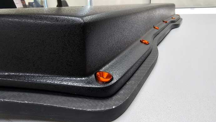

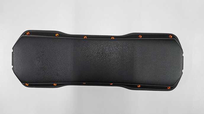

Alan @eboosted will be making the 3rd type of enclosure for the deck.
It will be a deep enclosure for the 21700 double stack (DS).
The price of the case will be the same as the MS version, i.e. $150 + shipping costs
If anyone is interested, please let me know.

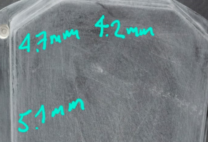

Internal dimensions similar to SS but the depth is greater.
The enclosure is flat and the deck is concave, so the depth of the enclosure is different in the center and at the edge
I reckon these measurements are in cm no?
Corrected ![]()

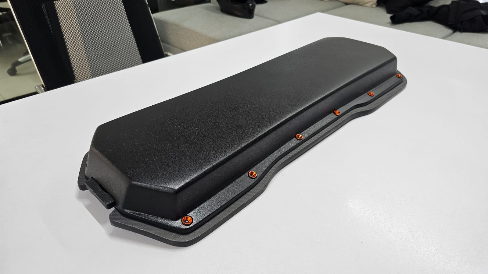

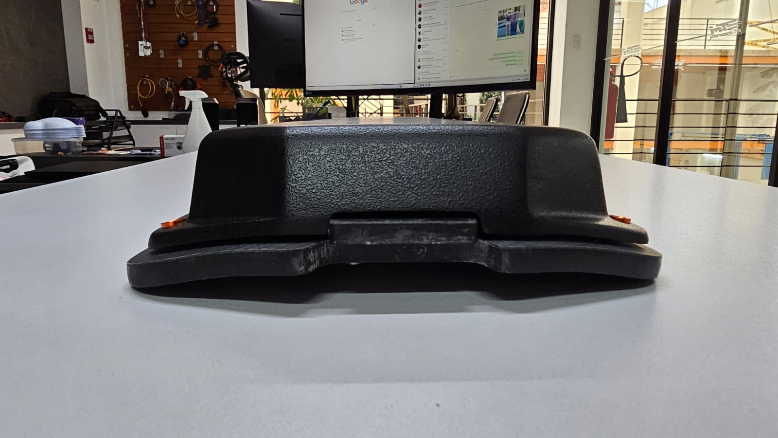

The 3rd variant of the @eBoosted enclosue is ready ![]()
Now there are three options to choose from:
SS - enclosure for single stack
MS - enclosure for mixed stack (double on the ends and single in the middle)
DS - enclosure for double stack

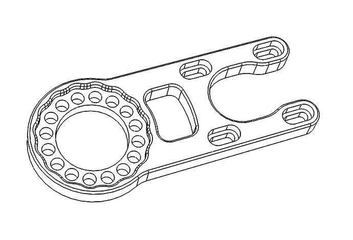

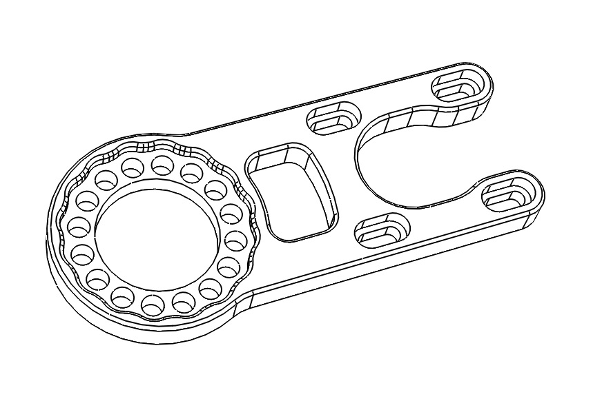

This is the most minimalist motor mount I have designed… it is primitive in its form… it has only what is needed ![]()
Adjustment range 61-67mm, 44x44 mm mounting hole pattern, so it fits 63xx motors
I wanted it to fit a gear ratio of 15/60 or less

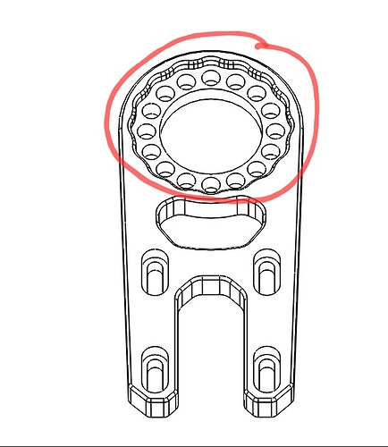

The second version, the form is still simple but I like it better.
I also increased the adjustment range to 60-68mm
Somewhat similar ![]()
Looks very thin around the clamp area ![]()
here the mounting is the same as the previous version and during 3 years of production no one has filed any complaints so I am not worried about durability, and I have sold hundreds of these mountings.
Now I’ve added a bevel and maybe that’s causing the illusion of a thin edge
Sweet! Maybe its the line drawing as well that makes it look skinny.
