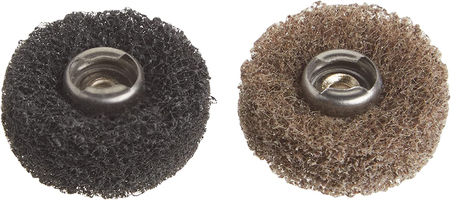

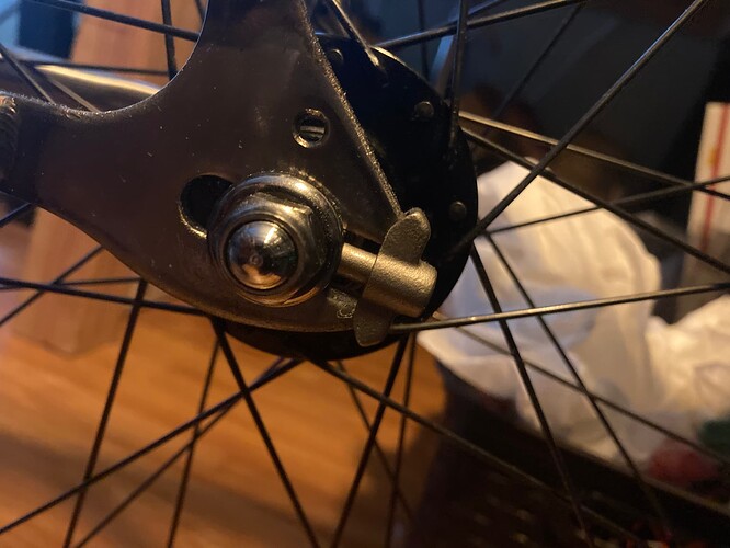

An alternative method for if your orbital sander is too big, you don’t have one, or the part you need to sand won’t work well with one:
Get a dremel and plenty of tiny sanding belts starting with new rough belts and then go through some older used belts that are no longer as abrasive up until their finer options they have (don’t know the grit and they don’t label each piece). You can then achieve a nice brushed aluminum finish using the steel wool buffing brushes.
DO NOT use the steel wool without sanding it with several different grits/ worn out bands first or else you will destroy the buffing bits very quickly. Also use very little pressure when using the finer buffing brush as those ones are easier to destroy.
To clarify I mean these things:

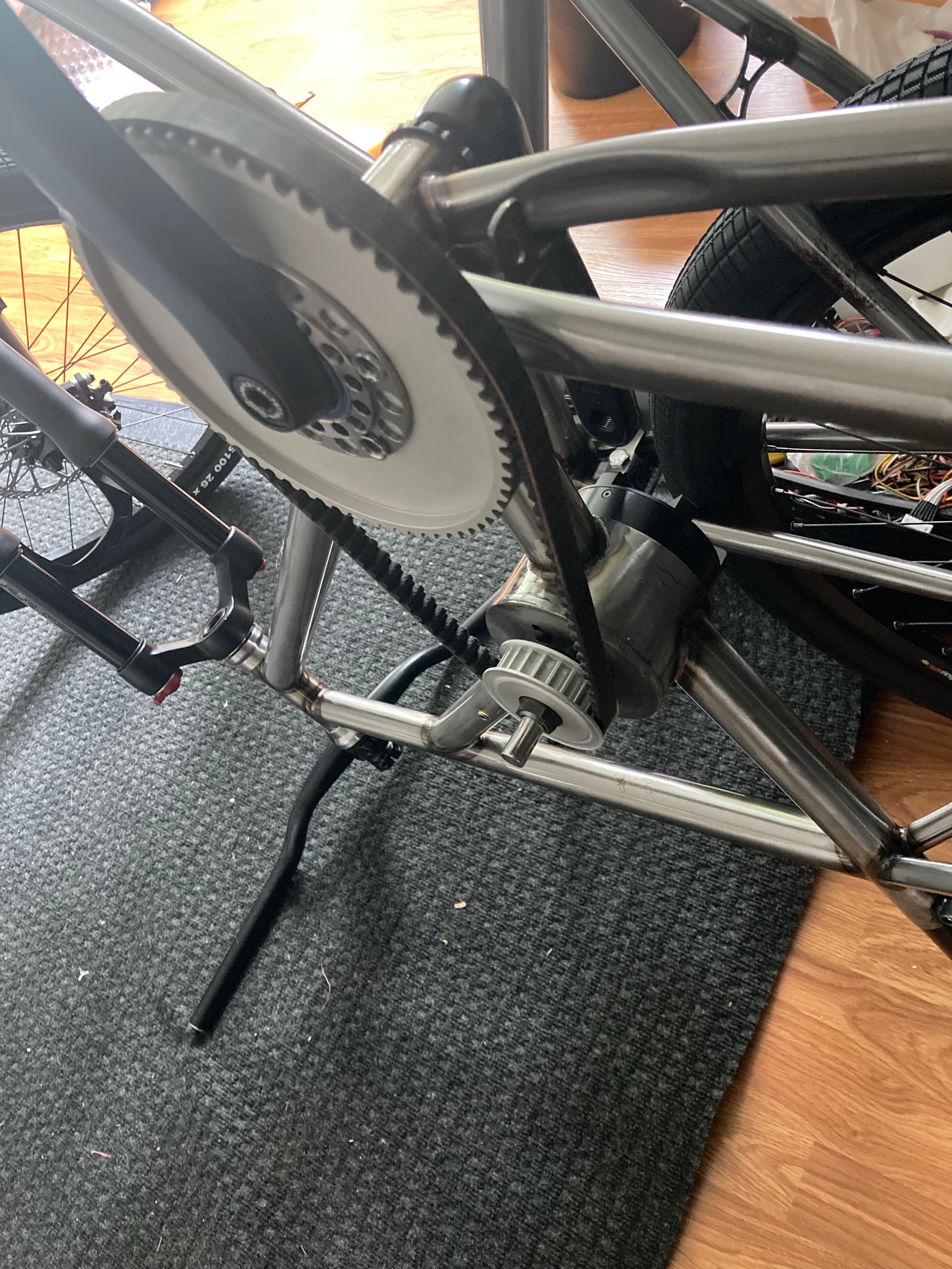

Been avoiding it and finishing electric bikes been making. As soon as done these two (selling one) I’m back on it and a lot are already done. They were all done and then the fuckups started happening, mostly being rotors somehow rubbing
I know it’s been ages. I’m sick of doing it and a lot of work. But I sold my other electric bikes figured I’d be done these and kinda need them to get to work unless I want to pedal all the time n kinda far. Should be done by Monday.

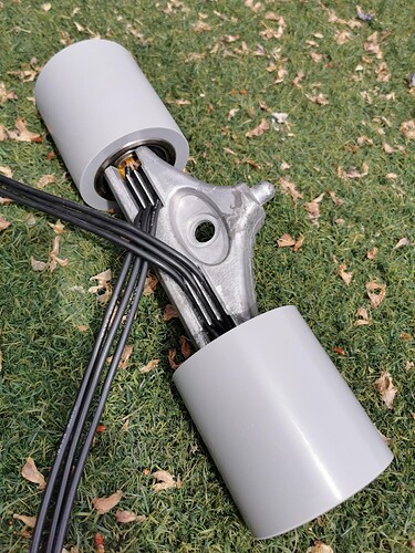

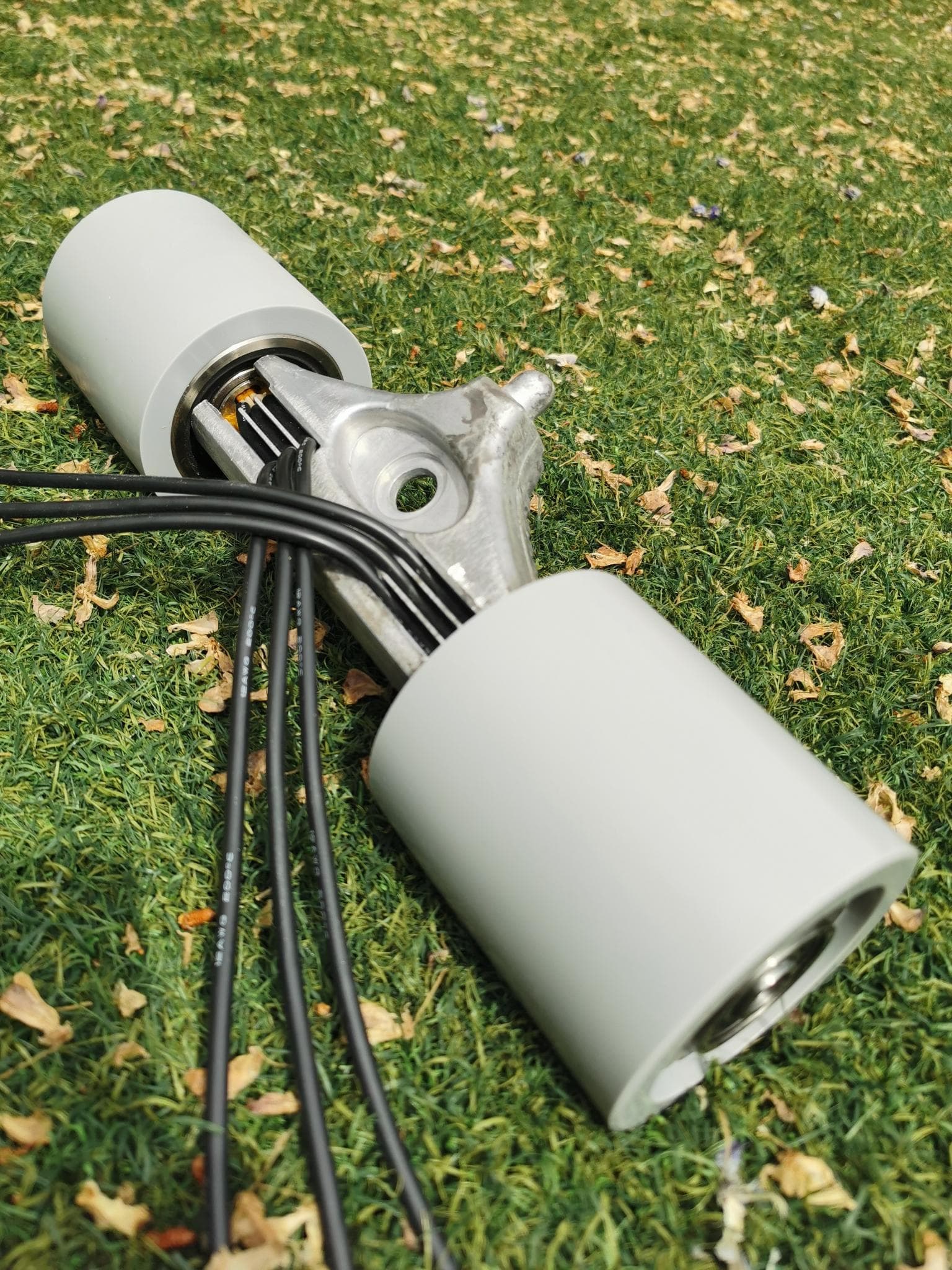

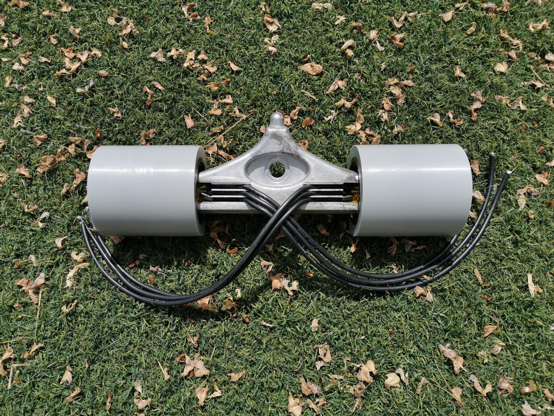

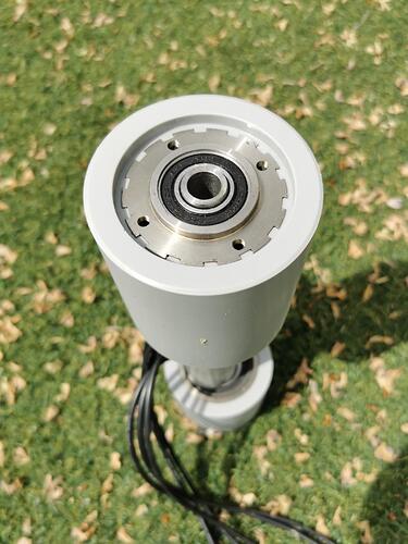

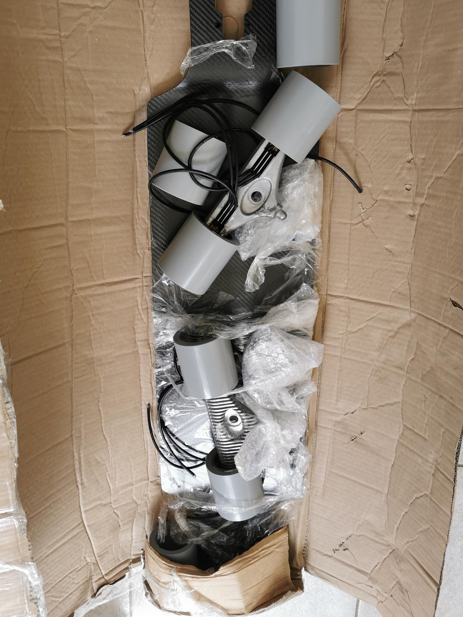

I got sent a phot of a set that a lucky UK resident has received. He has the last gen also to compare them to.
Amazing job @hummieee!
I didn’t realize the hubs were huge!
