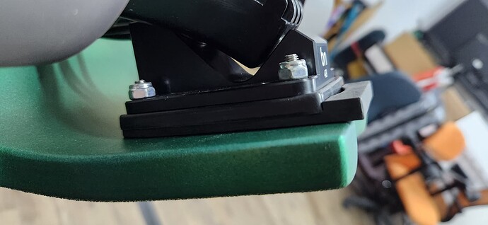

A bash guard riser for the back, dont wanna scratch up the deck.

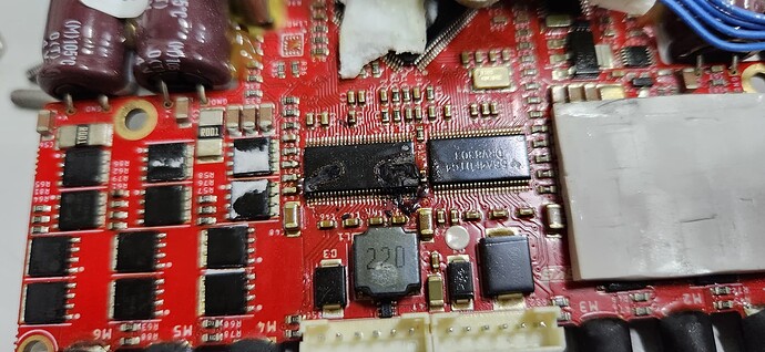

I was taking a look at the freesk8 app as i was unable to update firmware to 5.3, and then i heard a tick sound. Didnt think much of it as i thought it might have been from something else in the shop. Board auto shut off so i pressed the button to turn it on, and SMOKE. Scared the shit outta me and i immediately pulled the battery out.
Anyone got a xenith i could buy? Or should i go stormcore… hmm
I don’t think you need such a powerful esc for such a ‘tame’ battery
