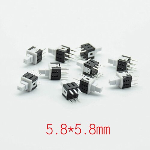

Replace the on-off switch with a 5-10mm latching switch, then the mini will outlive you.
I’m gonna do that.
Did you use a specific one you liked? A lot of the latching switches I’ve found are bulky or dip or toggle switches which I don’t want.
A non-led 3 pin spdt latching push button in a small form factor is exactly what I need.
Couldnt find the same seller I used but it was identical to these in 10mm flat head, latching, normally open only.
maybe something like this?
Thank you both, gentle sirs

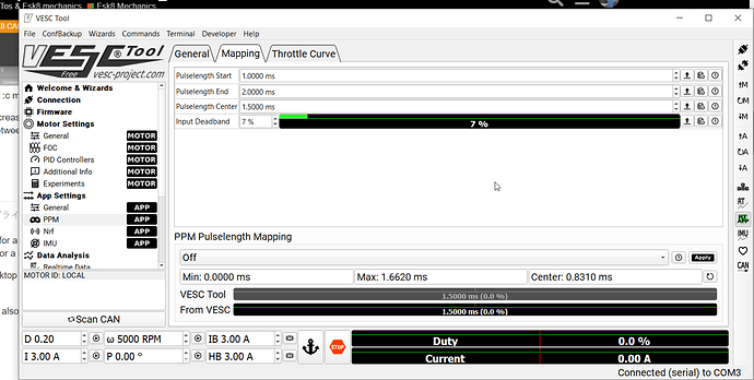

I got a same remote+receiver on aliexpress, I have a hard time binding them. The led on the receiver flashes fast when it’s unbind, so I hold the bind button and turn on the remote. Led didn’t turn solid, only turned solid when I let go of the bind button. When led is solid, I remove the binding plug. Throttle works ok(didn’t know I’m not supposed to hit throttle), as soon as I turn off receiver the motor went full throttle. I turned everything off and turn back on, they were unbind and won’t pair automatically.
On the second time, I tried to bind with the same method without touching the throttle during the process, turn everything back on they won’t pair.
The third time after checking the above video, I stopped letting go of the binding button, and it took above 2-4min for them to bind. Then I turned everything off, and turn them back on they just won’t pair automatically.
Do you think I should I get a new rx/tx?
This means you need to set the failsafe. The timing of removing the bind key sets this.
This is absurdly long. It’s typically about 3 or 4 seconds.
Thank your for the reply, I think I would have to get a new one.
Turn on “RT APP” on the right side of the tool. Change “Control Type” to Off. In the PPM > Mapping tab, look at the realtime pulselength information. Does it stay centered when you turn off the remote?
I will do this and post results tonight - thank you much
No, the left motor runs reverse and the red bar shows that
What does the “From VESC” bar do when you switch off the remote?
