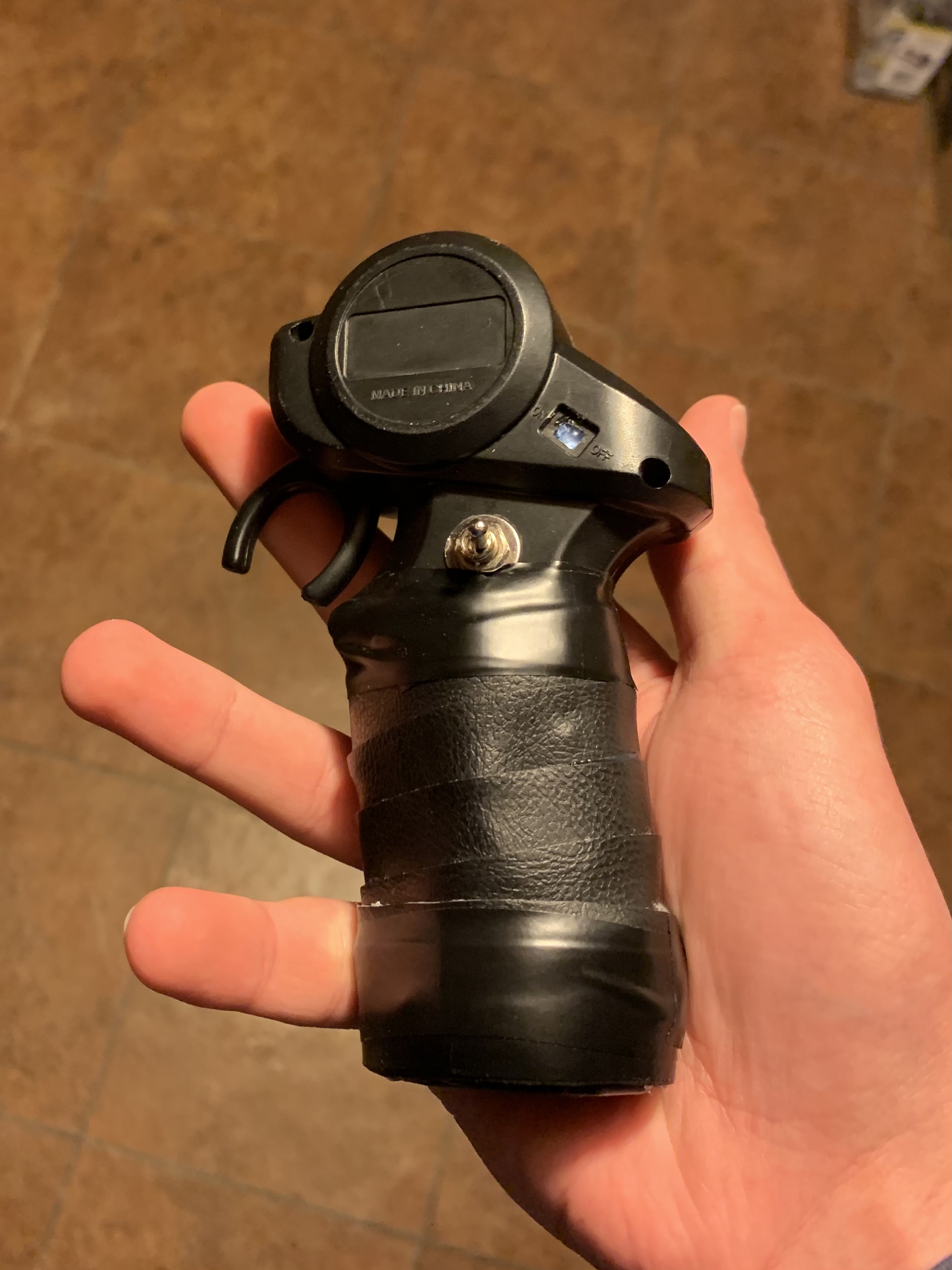

Background: Thought about how easy it would be to cram my one a123 cell into my poor- non consenting mini controller.
The picture on the top is a mock-up, and had no real connections as of this morning.
I post this here to show the final result, some recommendations, and to comply with the requests I received :laughing:
Let’s be honest, you are probably going to have these parts👇 in one of the many esk8 drawers you have

There are a few simple steps.

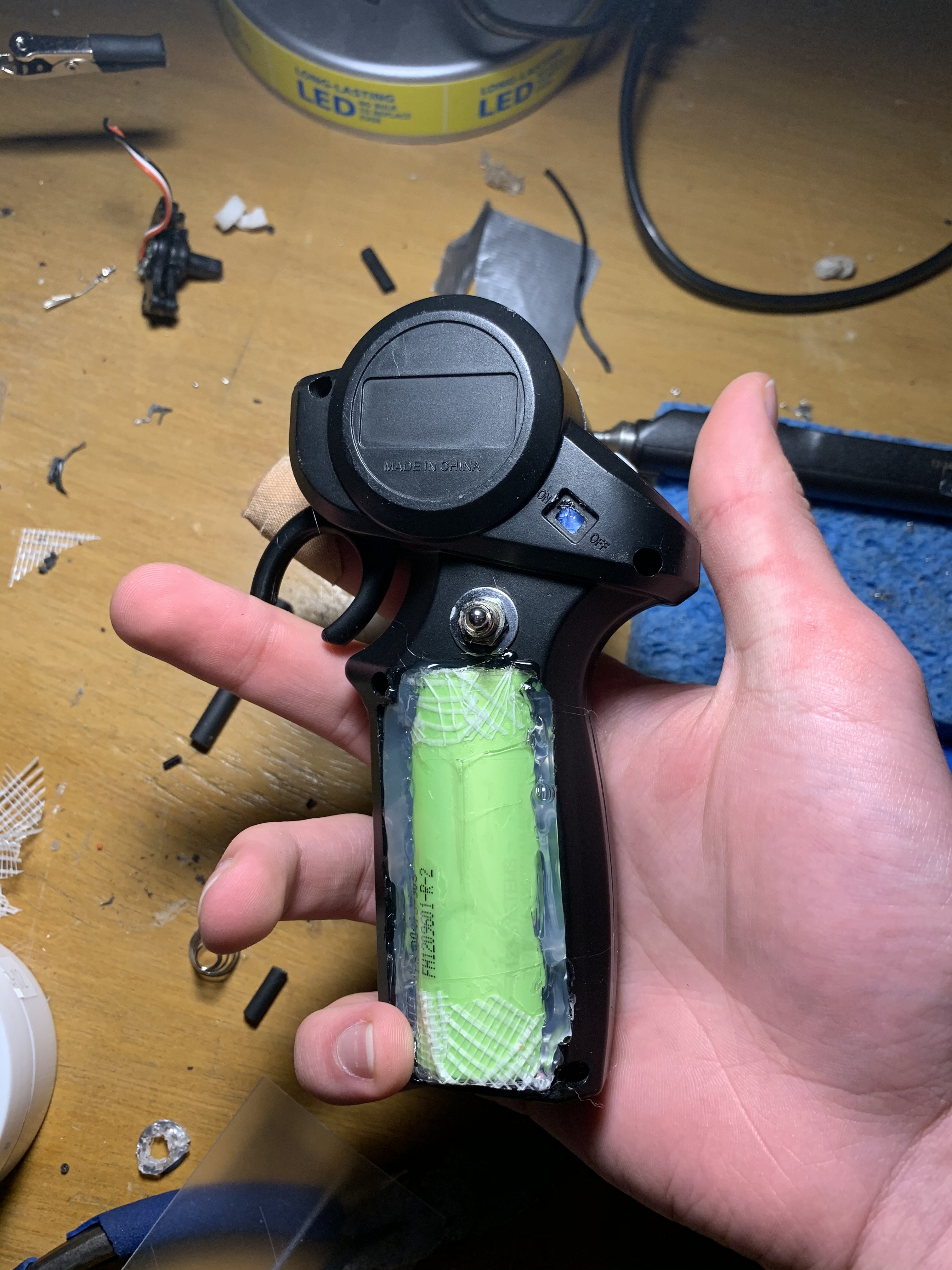

1) use a some cutting tool to rip out the battery box and trim cutout to size
2) remove ‘wheel’ plastic nob and potentiometer bracket from the remote, this area is where you will wire in your charge port and switch.
3) sand down the remaining plastic part that would restrict the motion of the plastic wheel you removed. This should leave a nicely sized hole that is perfect for this style charge port
4) make sure your battery fits well in the remote with both sides closed, and solder some wires to the cell once you confirmed a nice fit
5) next, use these long wires from the battery to connect
POSITIVE: (charge port and pcb)
NEGATIVE: (charge port and first input of latching switch.)
6) wire the latching switch output to the pcb (make sure its in the off position)
And TADA, you have yourself a reliable remote that you will have to charge yearly :partying_face:
Can charge it when it reaches its birthday.
The lifepo4 stays consistent for a while at 3.3v over its discharge, so you won’t have those micro cutouts at low voltage like you get with regular Duracell batts.
The ergo with the larger handle is actually surprisingly comfy btw.
Highly suggest anyone try it :call_me_hand:

I have a spare 30q, and could have put that in,and avoided the trimming.
I just really wanted to laugh at the fact that I got a 26650 in there :laughing:
