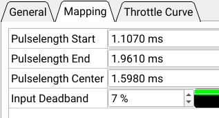

what should I set the trim to? I’m thinking of trying to get it to 0 when nothing is being done, but that only gets me 74% throttle and 97% brake. if I set the trim to the point I can get 100% brake I only get 66% throttle.
it got cranked all the way by a little kid who was messing with it, what a rascal
I set the trim when I do the failsafe immediately after binding
After that you need to adjust the Pulselength Start, Pulselength End, and Pulselength Center numbers so that your trigger moves it from about -104% to +104%
And with the Mini Remote I prefer a 7% deadband; it seems to work well. 5% is about as sensitive as you can go, and 15% leaves a whole lot of slop.
This is an example that has been tuned, but every receiver is different, so your numbers may vary:
Screenshot from 2022-01-07 03-44-46
You want those numbers set so that letting go of the trigger averages about 0%, pulling it all the way back averages about 104%, and pushing it all the way forward averages about -104%
You need to click “Write App Settings” before the changed numbers will affect the realtime app data.

I used 5% deadband last time I was using this remote and I really liked that.
should I adjust the numbers up or down?

I still cannot seem to get those 104% values you’re talking about, I have no idea how
best I can get is -90% to 70%
