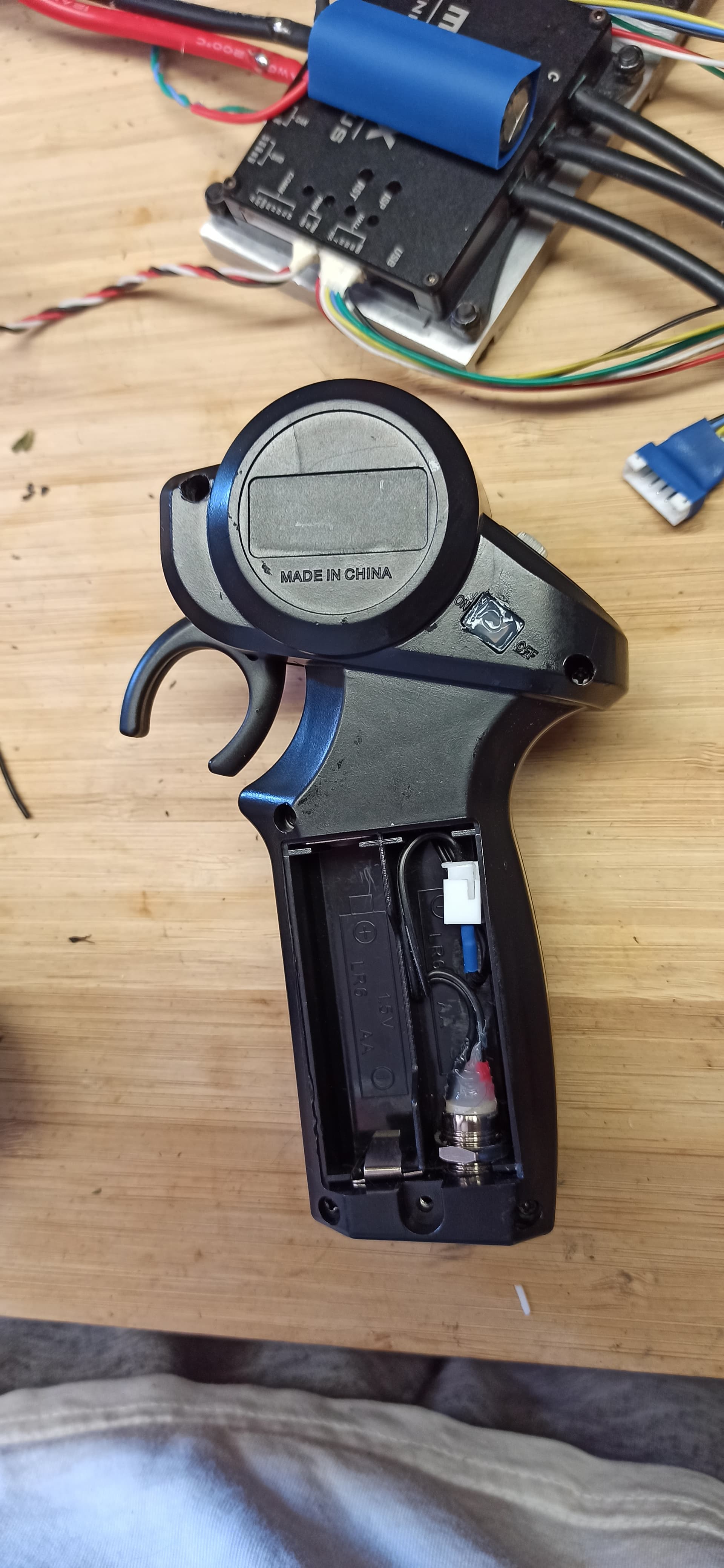

The Mini itself is easy to use this way, just get a 14500 cell and short out one of the AA slots with a small wire.
You can stick the 14500 cell right into the Mini Remote without further modification.
You can even use a 4.2V li-ion or 3.65V LiFePO4, I’ve used both and they seem to work fine, as long as it’s a 14500 size. The LiFePO4 dies abruptly and the li-ion gives a bit more warning.

But the 14500 cells drop RIGHT into the stock Mini. Like, a perfect fit. Just short out one cell holder and stick a 14500 in the other side.
Not true. For size and dimensions I feel even dual parallel 18350 can pack smaller than a single 18650, depending on the form factor I go with. I haven’t started doing the CAD yet so for now I’m open to any cell, but I’ll settle on whatever fits. Most likely that will be a single 14500 or 18350. I also want to use a battery cradle for replace-ability so that will take up space too.
Instead of shorting out one cell holder, I think you’re better off rewiring the internals and adding in a locking pushbutton to replace the stock power button with something less likely to fail at the worst possible time.
Agreed 100% on swapping the 2x AA for 1x 14500 lithium ion though.
