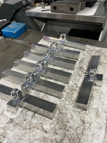

This is the progress on the hangers, a few more steps
The base plates are done.
Axels are in progress.
Hopefully, we can test and ride around the first of the year
Gonna make some hubs tomorrow though. @Venom121212
