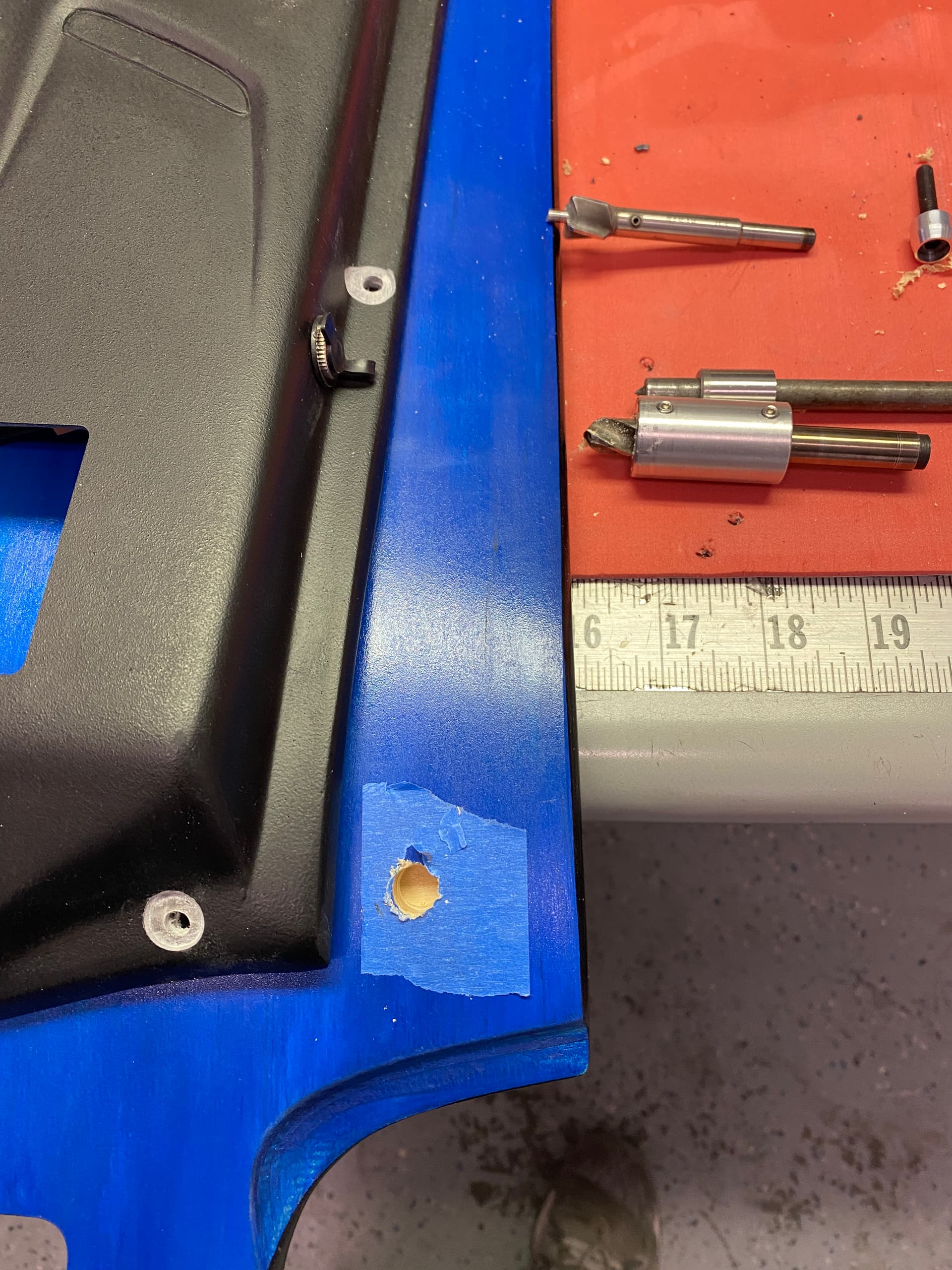

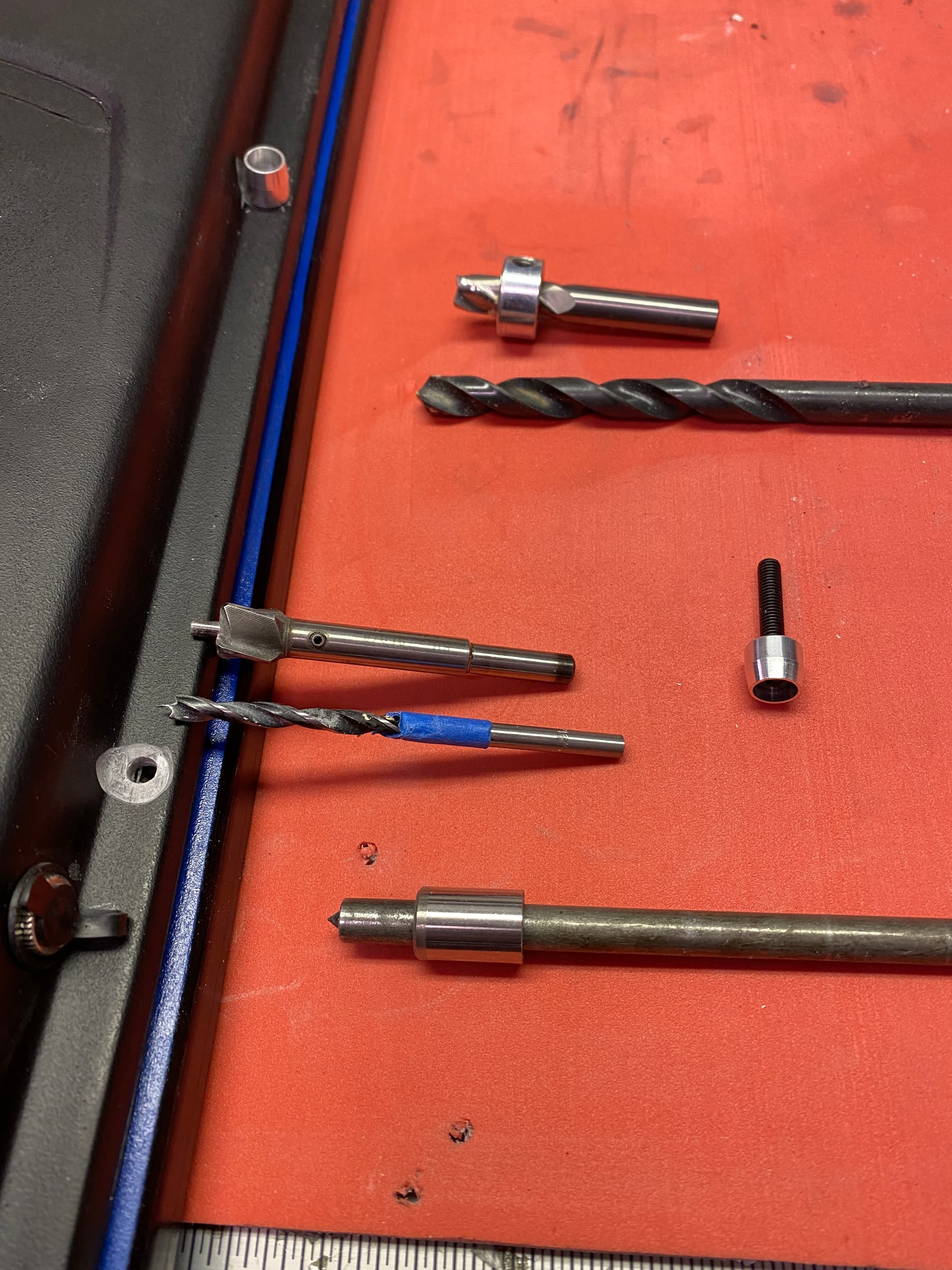

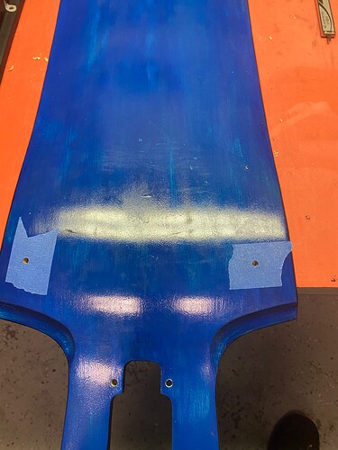

For me, securing the enclosure to the deck without drilling through the deck is most tedious.
I used a combination of these tools in doing so:

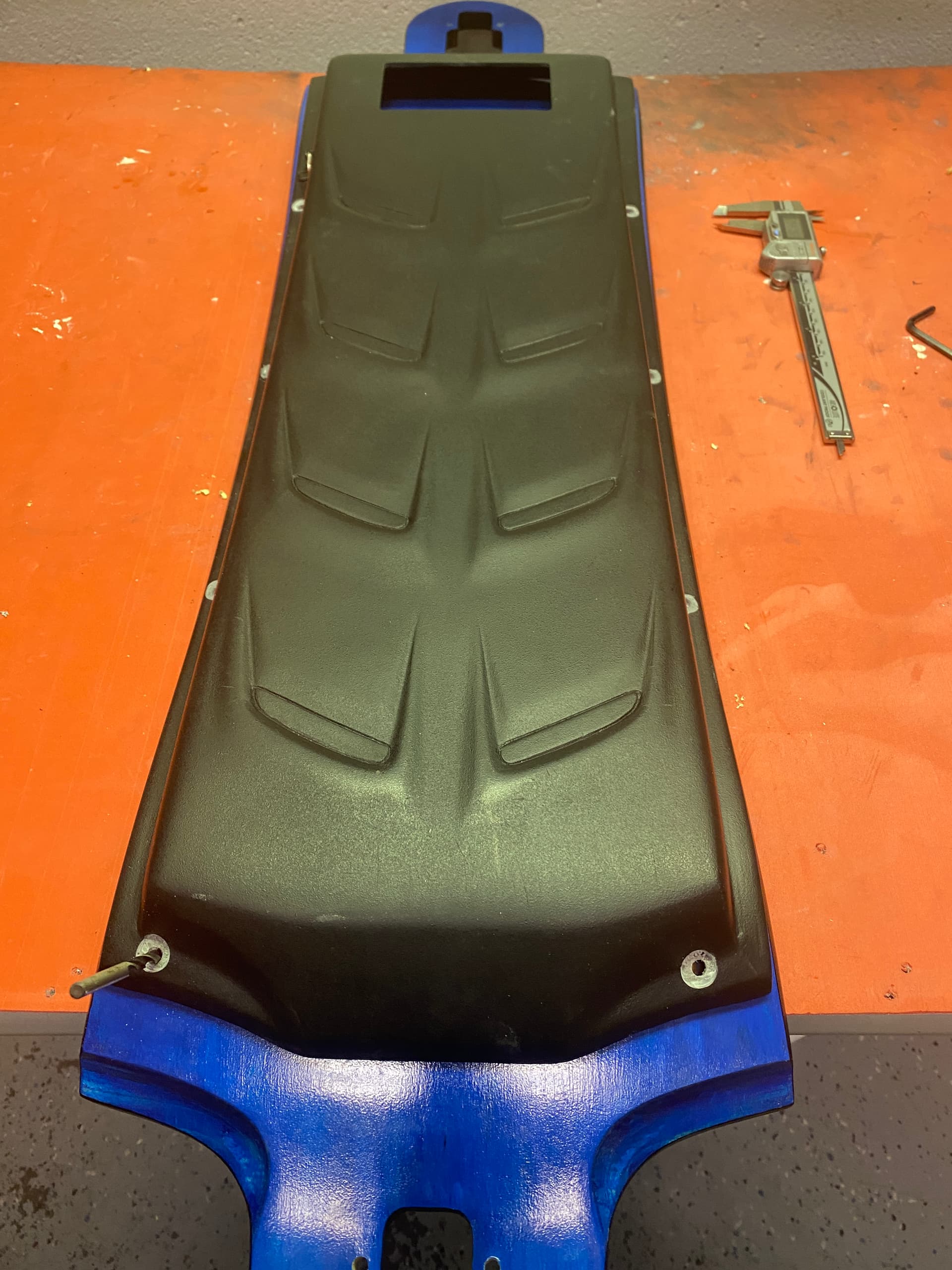

First, I drilled and spot faced the enclosure to accept the “washers” I machined to hide the head of the bolts. Then, drilling the deck. I lightly clamped the enclosure to the deck with the gasket, and used a transfer punch to mark the hole locations.
I’ve found that putting a piece of tape down before you drill, prevents splintering while drilling.

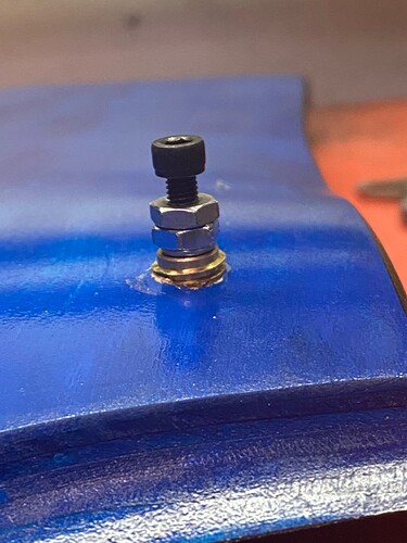

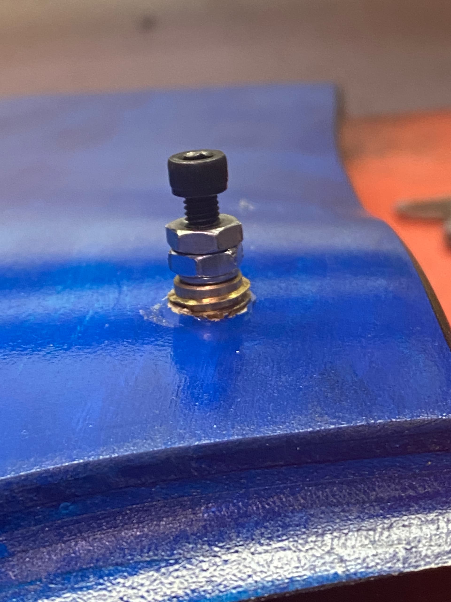

For me, installing inserts is the biggest pain to do correctly. I thread in a screw with two jam nuts, and tighten it to the insert, then slowly screw it into the deck, making sure it is square in both directions all the way down. Then, I screw the enclosure to the deck. If all the screws go in well, then I remove the inserts, apply some epoxy, then thread them back in. :sweat_smile:

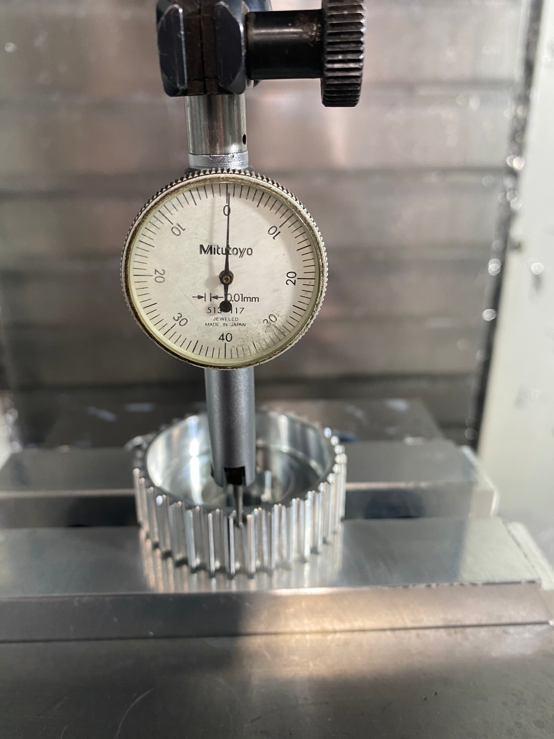

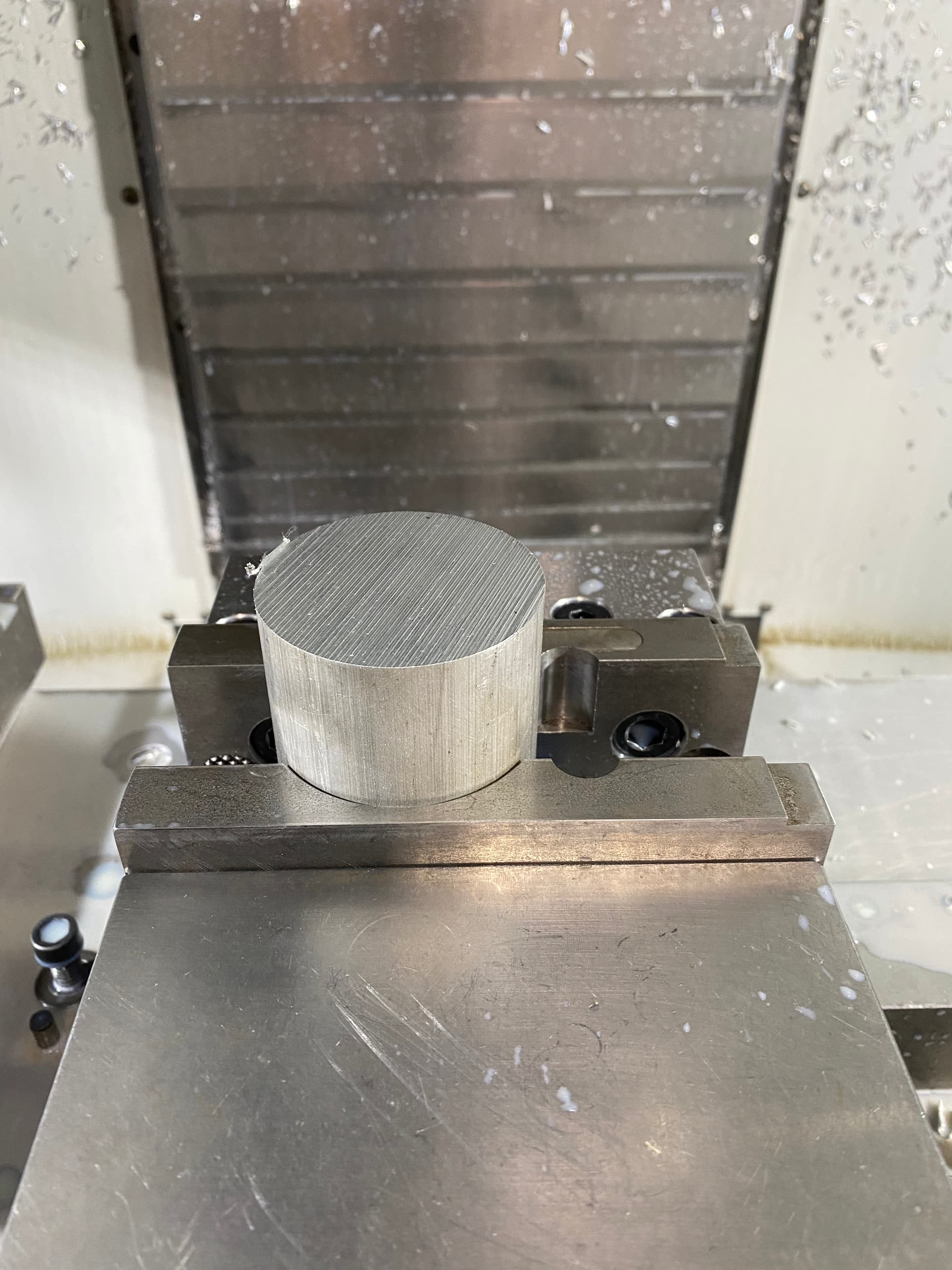

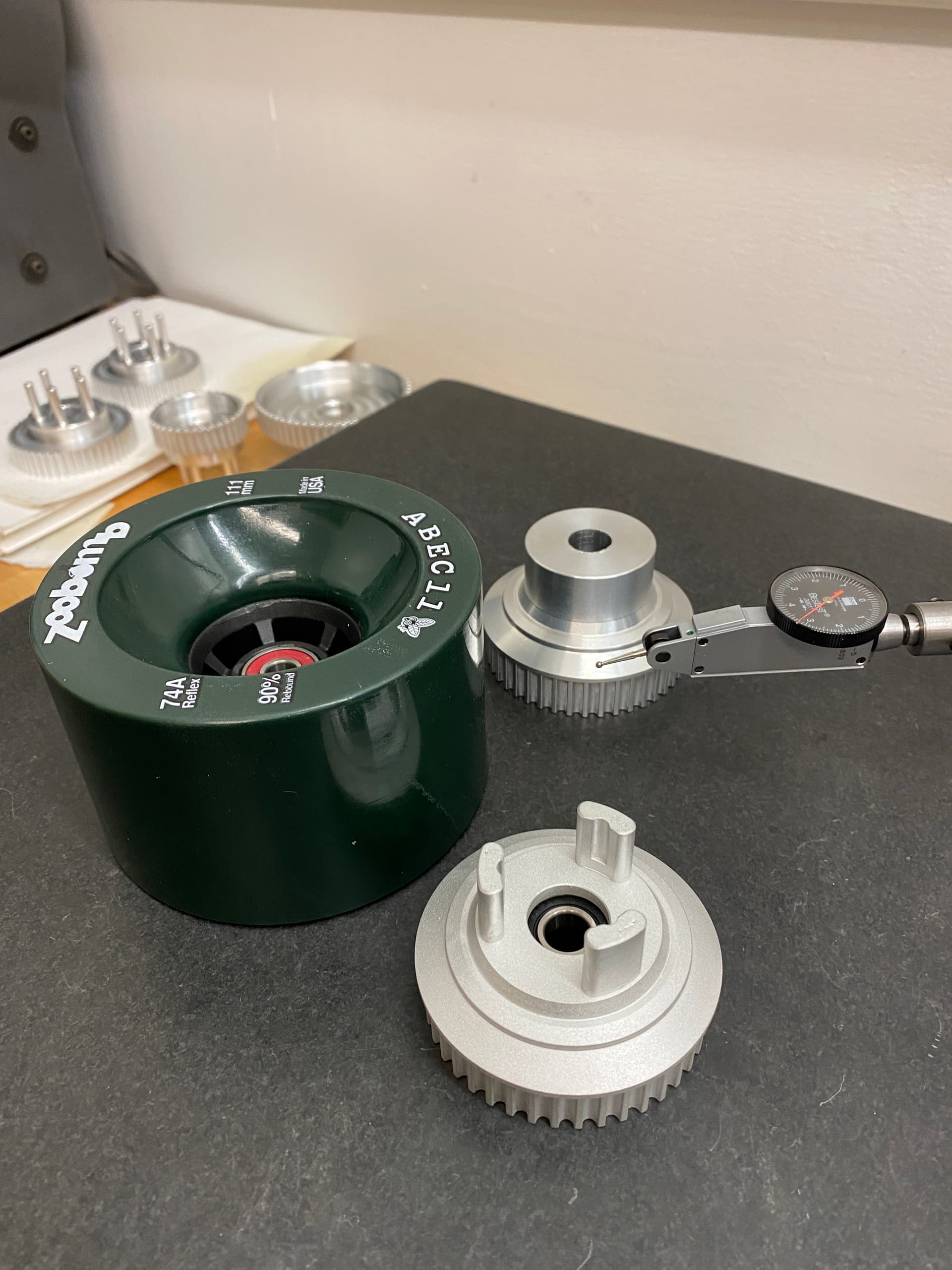

Next, I machined some 42T ABEC pullies to fit the Hoyt 111’s that I dyed black.

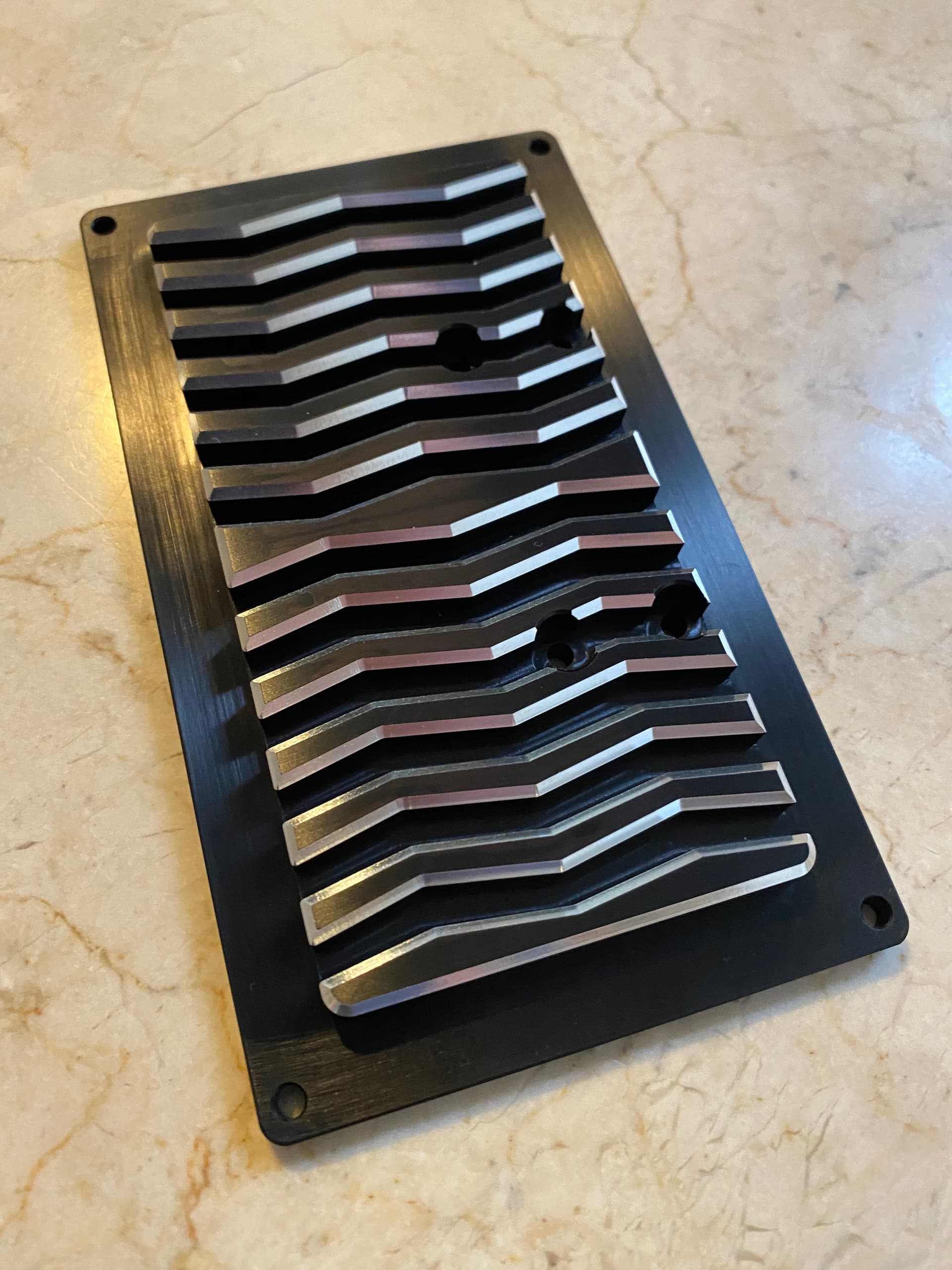

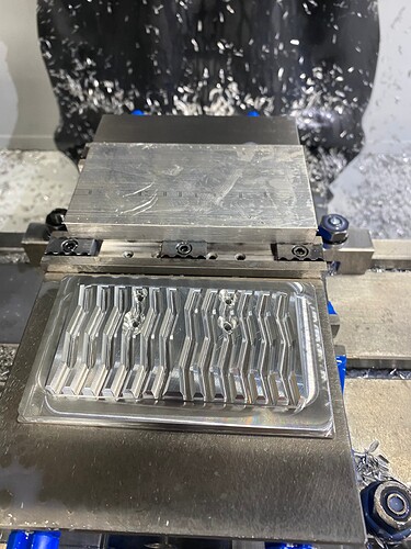

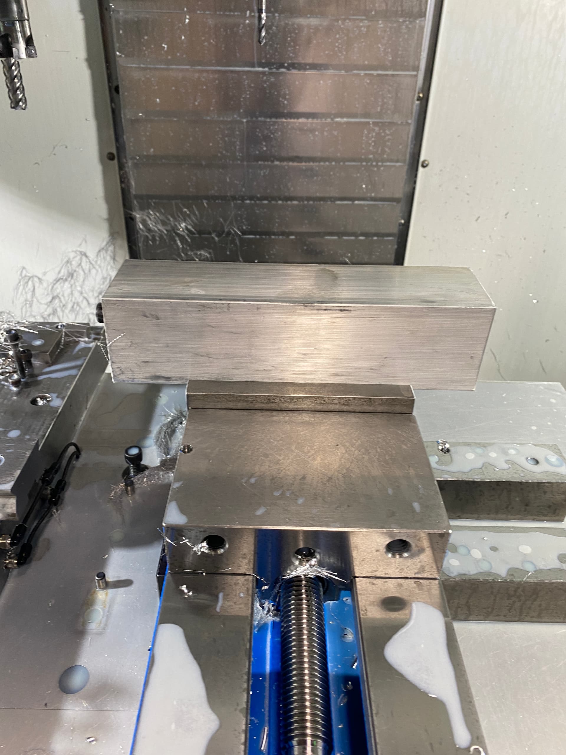

Heat sink:

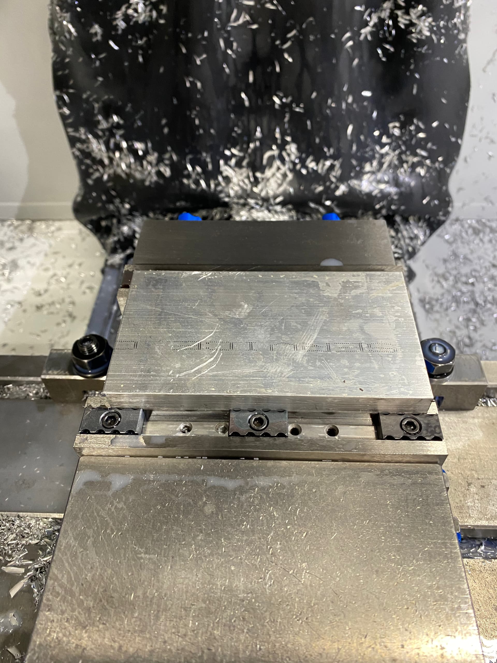

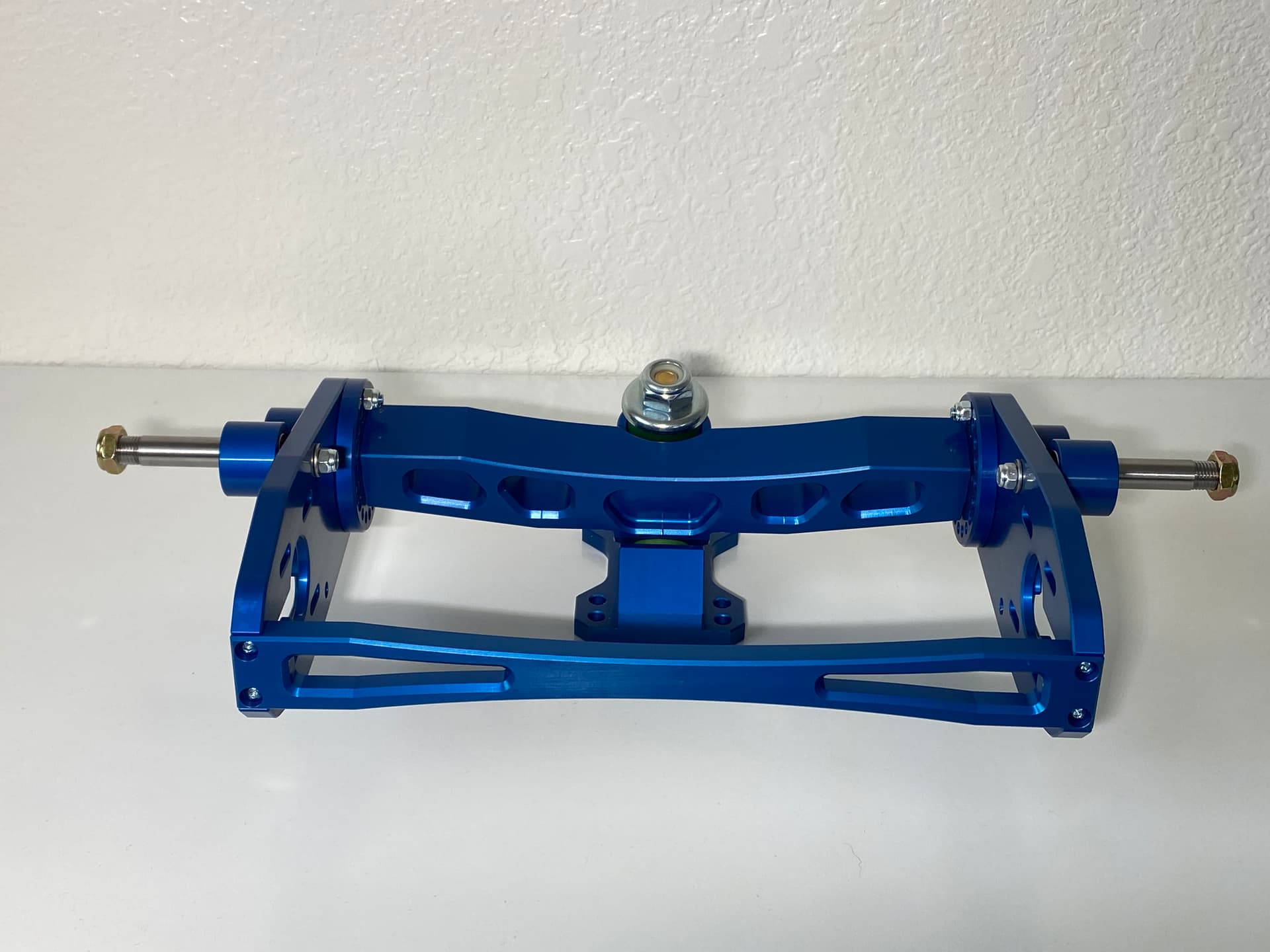

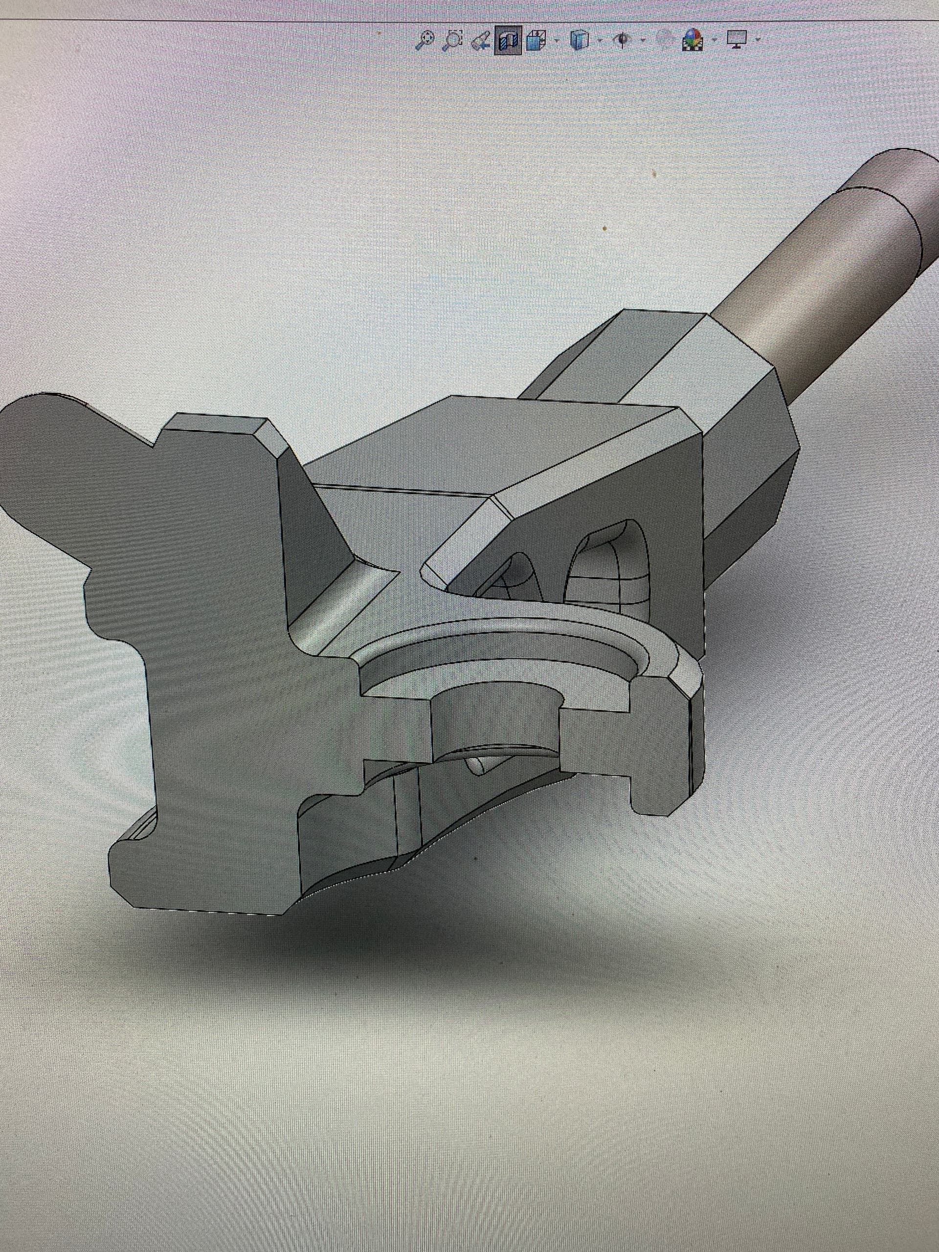

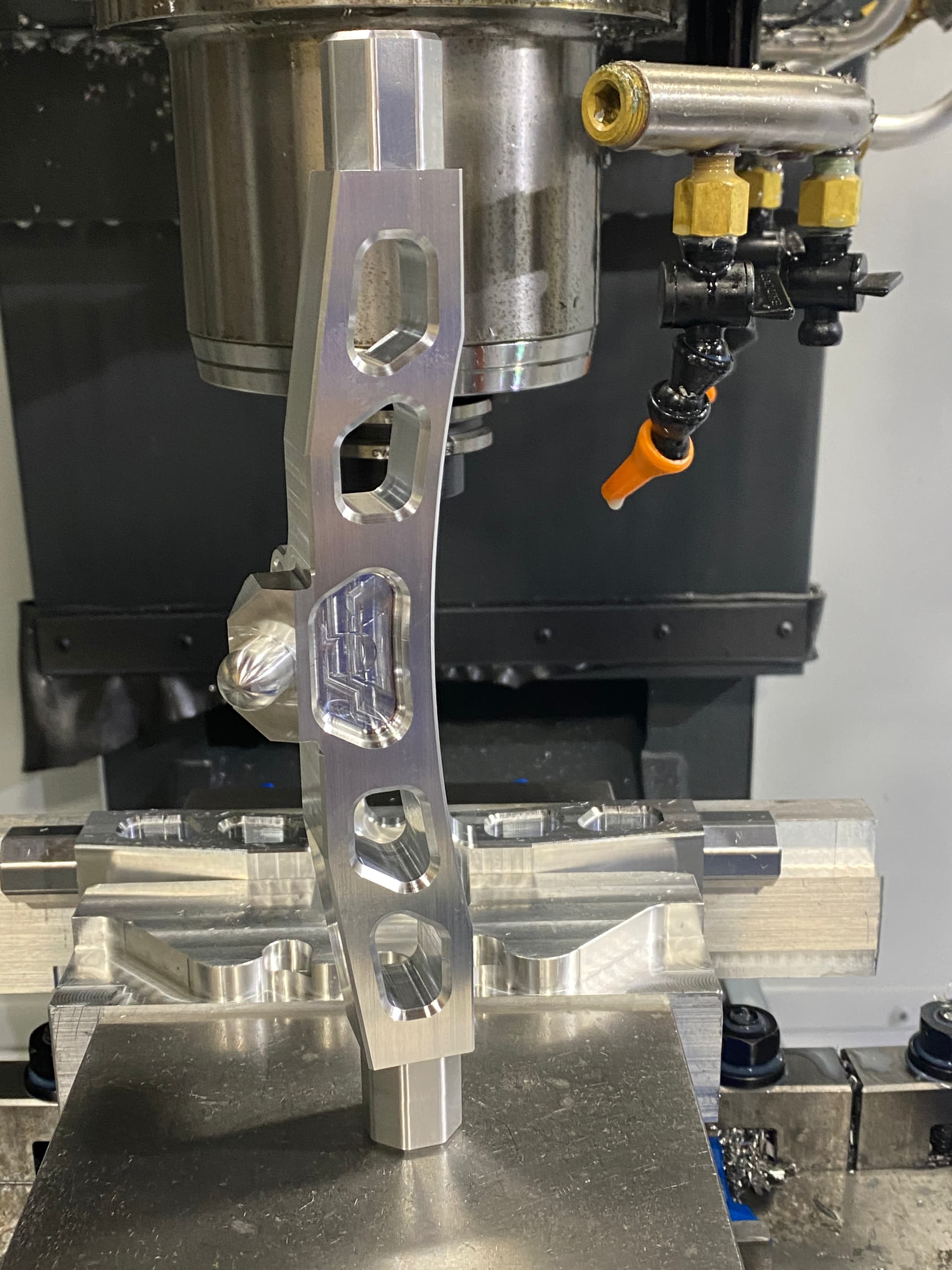

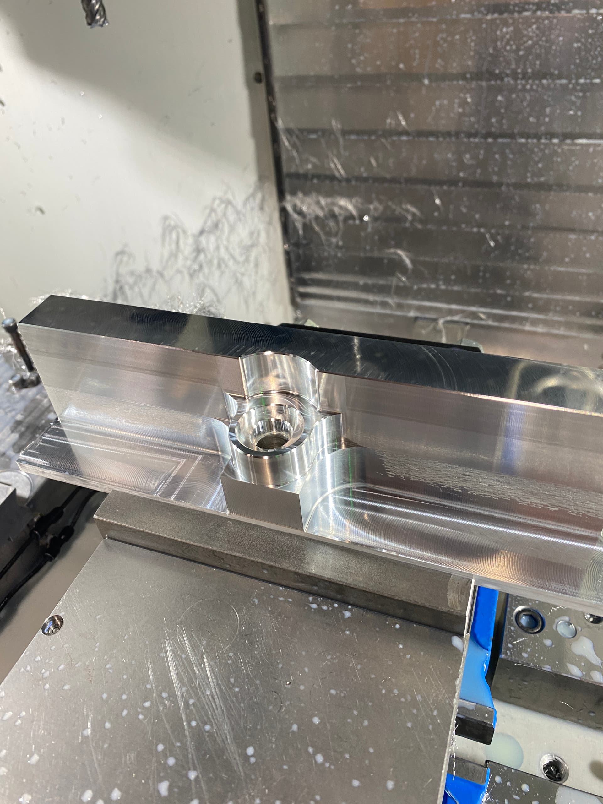

Also made some TKP trucks and motor mounts with a drag handle.

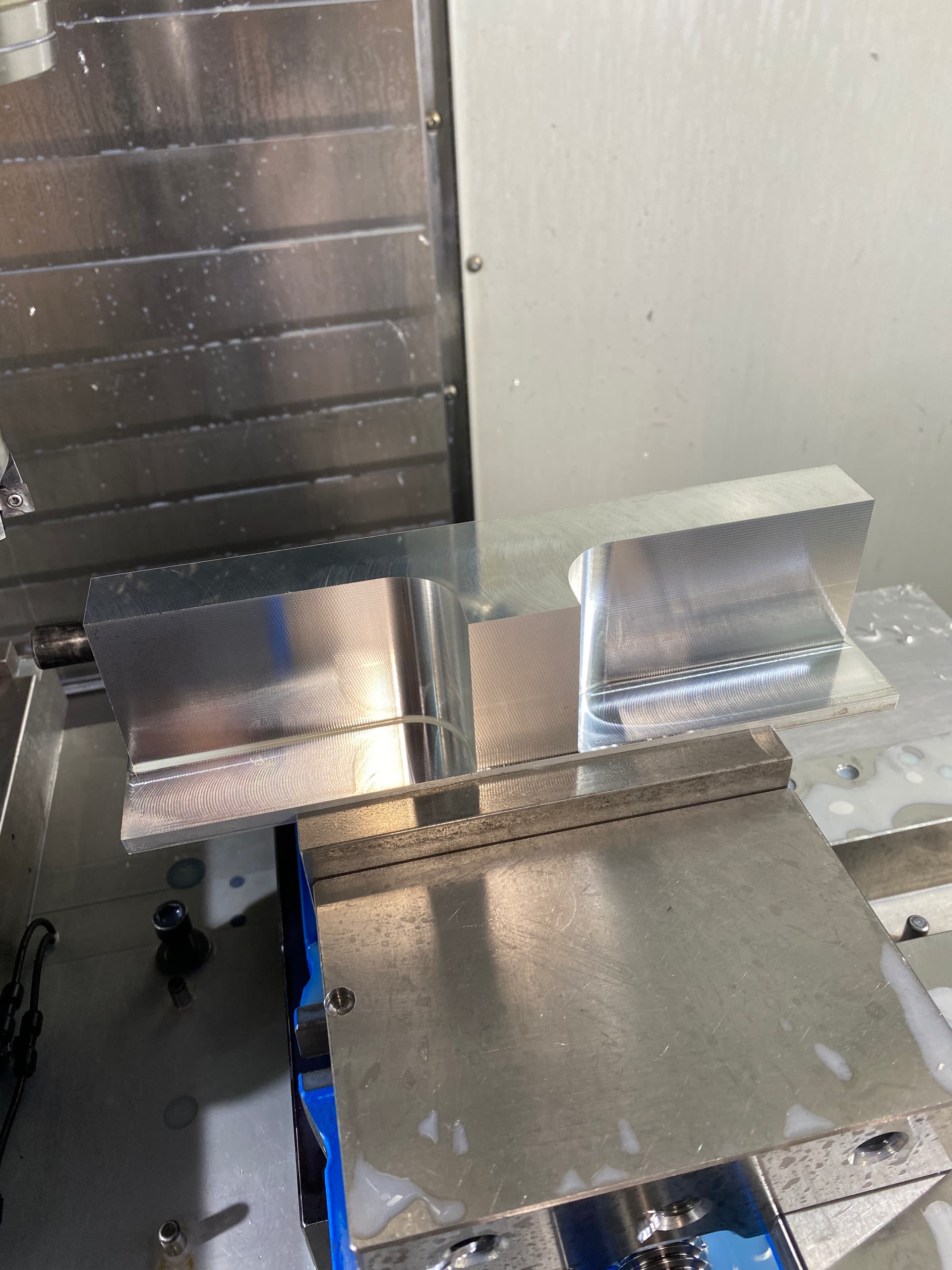

Blue anodizing:

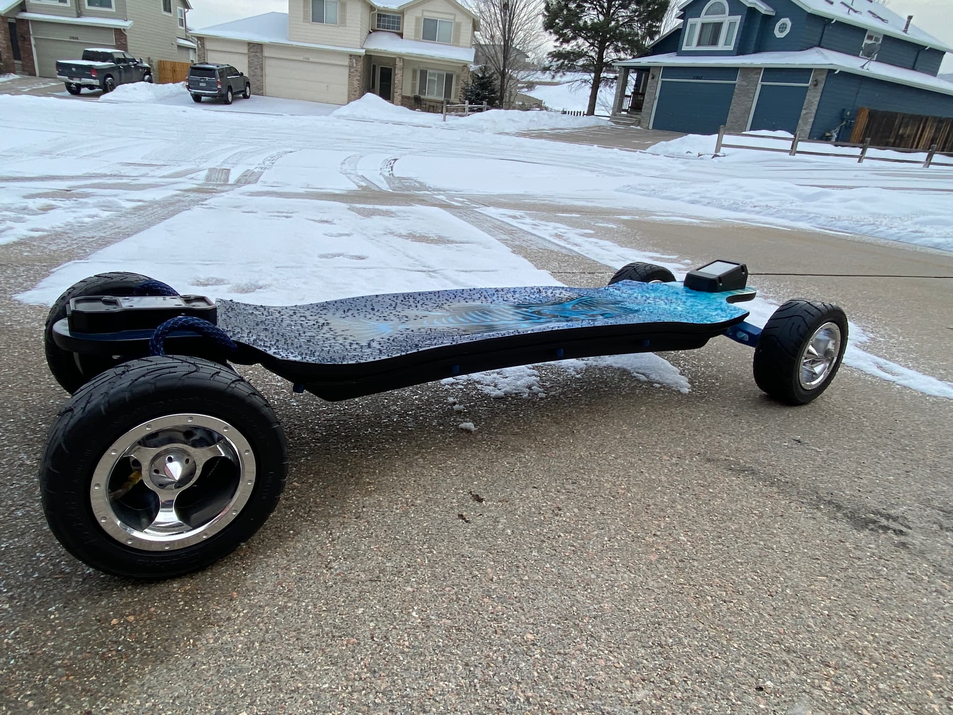

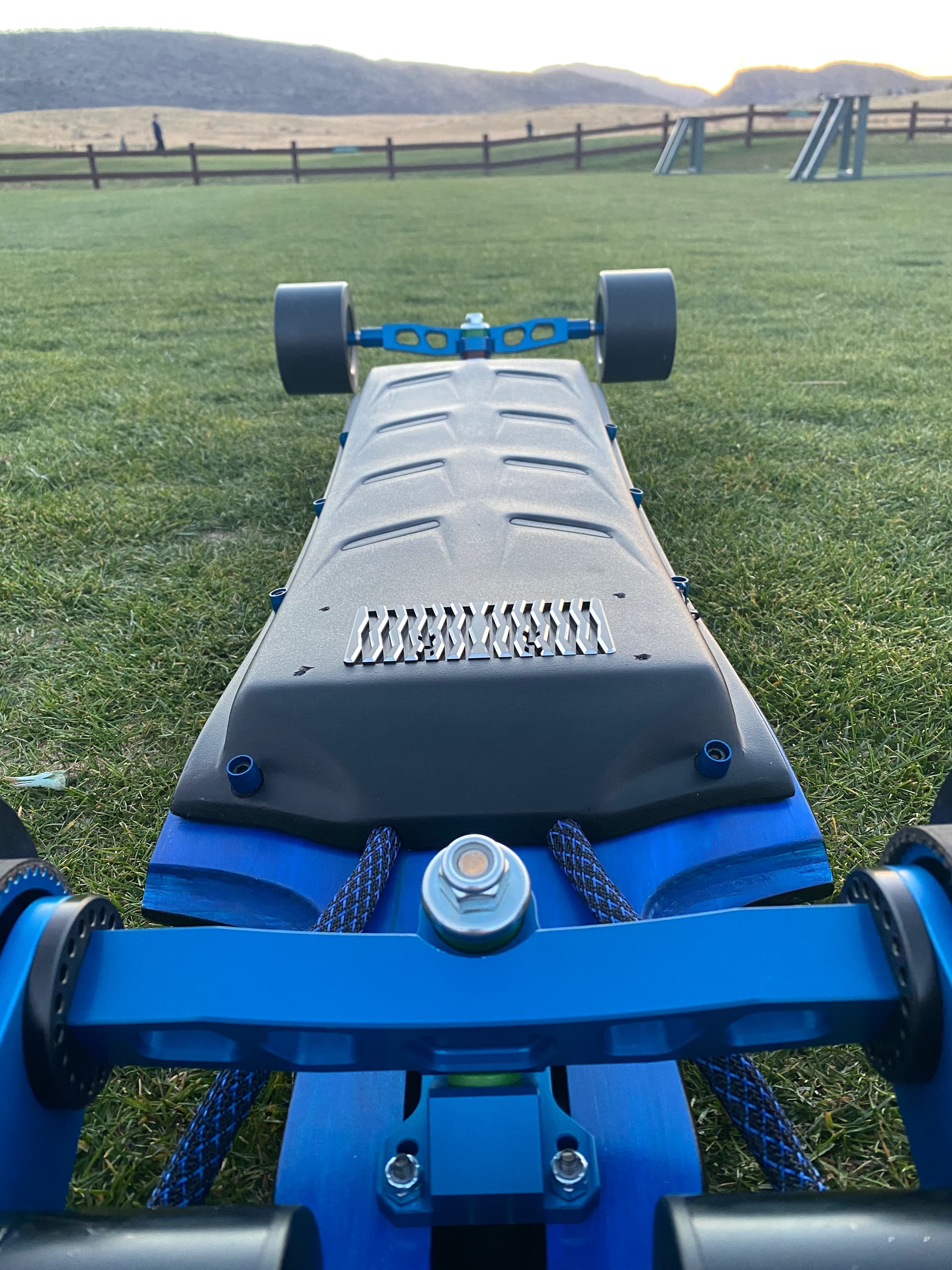

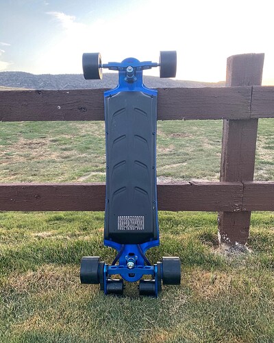

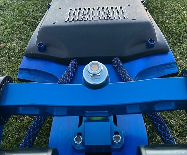

Final pics:
I have since replaced the battery with a 12S4P with P42a cells.

So much finesse here sick build Phil! Installing inserts are definitely the worst. I fuck up even through inserts lol.
That jam nut trick is good, I’ll have to remember it
This board is so awesome. Great work!
Thanks bro. In the end, when everything comes together, it’s worth the hassle.
(Cause you must look at it everyday)
I’m sorry, I couldn’t see the board… was too busy drooling over the Haas TM-2P in the background :drooling_face:
That is a beautiful board - truly a work of art - and engineering!
This thing is really sweet dude!!!
Almost too pretty to ride!!!
This wire management is like the nicest I have ever seen…
Thanks bro! I actually just made the slots in the enclosure for the wires with a round file until they fit.
Hand files are underrated tools in this business, IMHO.

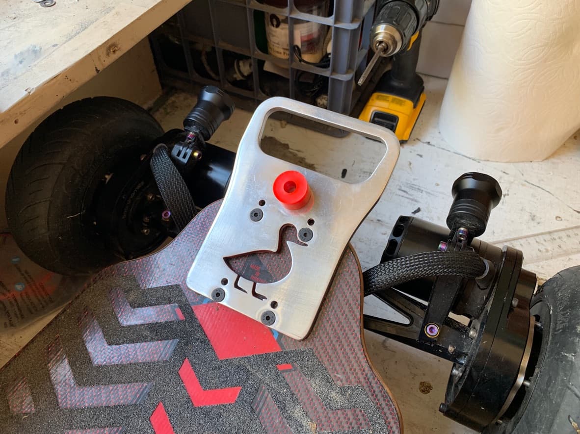

@Savage1 as someone who just purchase a metr pro can GPS/SD, I really appreciate your attention to detail and effort put into the GPS holder.
My solution involves an airtag holder. It works, but your is much cleaner!
Mine is so bulky as it incorporates the loopkey as well. But I’m interested in the details of what you are thinking.
I’m going to use the airtag case as a housing for the gps, and stick it on my duck handle where that bushing is sitting.
I’m hoping it will be a nice blend of “Shitty DIY”, and “huh, that’s a pretty good idea”.

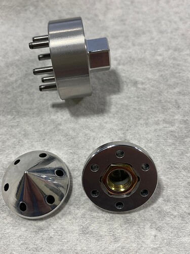

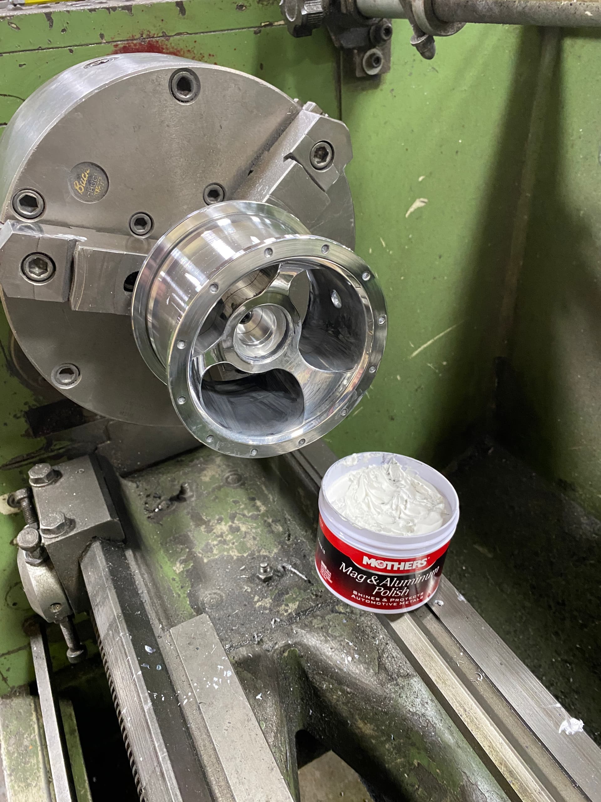

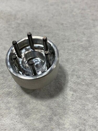

I purchased some jump drives from @ApexBoards like 6 months ago, (they are amazing) but they didn’t work with my current build, as I wanted to make my own hubs……
Here is my journey thus far……
Make hubs….
A little polishing with mothers…
I wanted to hide the nylon lock nut…… because, you know….
So, I press fitted one into a “”nut hider”
Processing: F8893C9F-8806-4C78-901B-25B485B3ED35.jpeg…
Uploading: 667C3AA5-AAE9-4D45-AD30-5F55845E7BB4.jpeg…
Installation tool to fit…

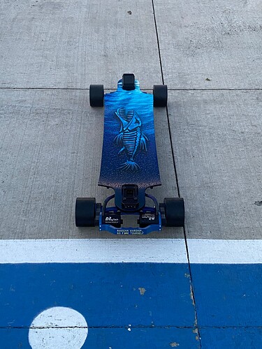

Final pics so far……
Cheers!
