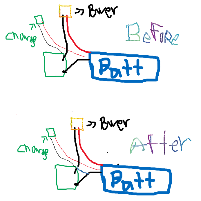

Hey guys, the similar issue here, trying to use the GT battery for testing with VESC at the moment, if there a way to bypass the evolve BMS to charge only? Thanks
Are you using the LiPo pack with the evolve BMS?
The evolve BMS will not supply power unless it gets the correct code from the evolve ESC over the 4-pin UART plug. You need to use a new BMS to use a VESC.
The LiPo pack is really terrible as well, it’s best to get a Li-Ion pack.
It’s the lion pack by the labelling on the battery. I have ordered some cells for my own battery build, just shipping to NZ is terrible so they are taking a while, trying to use this spare battery to use the build for now. Hm, I was wondering as it seemed like this guy had some luck
I can’t seem to include links here but if you google “Need help with pairing EVOLVE stock BMS with VESC” then it seemed like that guy may have had some luck with it. I was thinking of bypassing discharge, and as long as the bms works for charging it shouldn’t need the uart?
Here is a photo of the current wiring of the BMS, and below is what I would think would allow the bypass. Apologies for the terrible mouse drawing.
I’m the one who worked on the build. there is no possible way to use the evolve BMS with a VESC. you can use a normal ESC with the evolve BMS or a normal BMS with a VESC, but the evolve BMS will only work with the evolve ESC and no other ESC.
