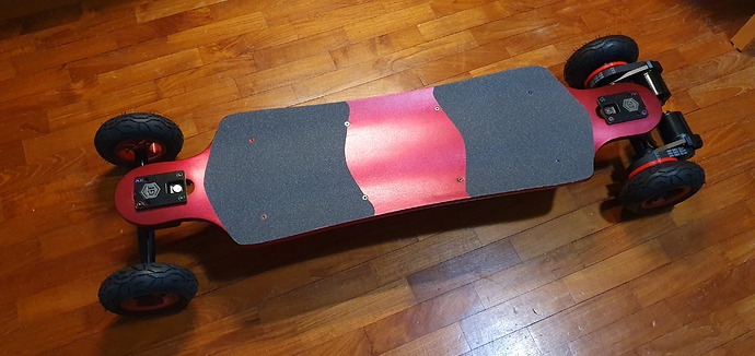

So here’s the premise. The Evolve GT sucks after awhile. And an esk8 friend of mine wanted to get an upgrade. Here goes.
This is the before pic
and after.
I cleaned and sanded the deck to get it ready for paint.
Oh yea metallic red.
And hello Bergs.
And in its guts, goodbye all the evolve stuff, i kept the stock motors since my friend did not see a need for a motor upgrade, it’ll also involve getting a new mount if it’s a 63xx motor.
And in it is a 10s4p 30q pack with 60A BMS, and a Unity.
Ugh their motors and their 5 sensor wires.

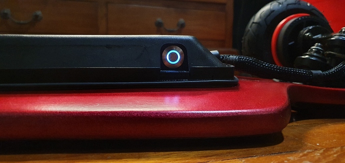

Pad it all up, seal it and some enclosure work, it’s done!
Thank you for reading, and I’m glad how this turned out! Did a small test ride and feels great, much better than the stock settings with the R2 remote. The red is a nice accent touch to it as well.

That paint is sick, you got a brand or link? Super clean build man, reminds of the old hellboy build
Thank you! The brand i use is more common in my region in Asia. It’s called samurai paint.
However for this color i had to spray three colors total to achieve the metallic red.
Started with a base coat of black, and then silver, and finally candy red, which is essentially a transparent red, so the silver peeks through from below.

The board previously cut out on GT mode and got my friend a couple nasty elbow scrapes. No more of that, well unless the unity fucks up. Then again this is a 1st batch unity and i’m using one too, no problem so far.

I couldn’t tell you were using the riser. (looks gr8 mate)
