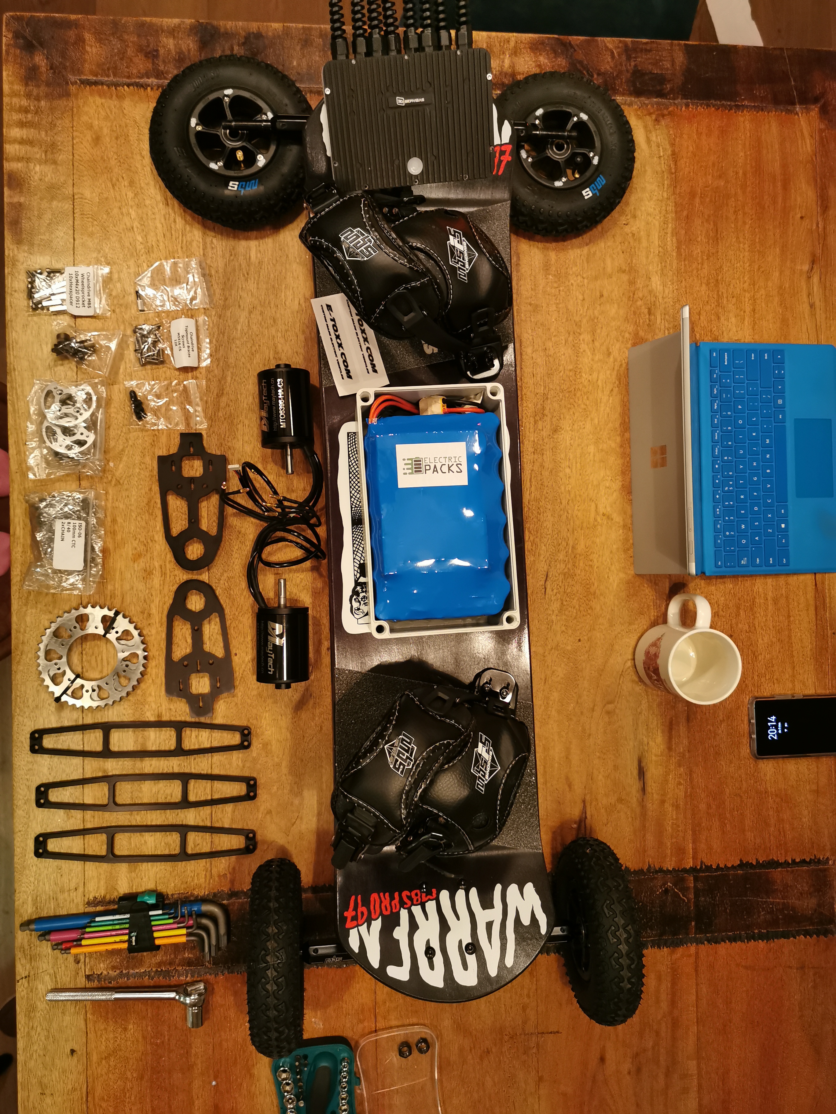

Hi folks,
The weather’s turned to shit here in the Netherlands and I’m facing the prospect of some long, dark, wet months spent staring longingly at my boards with tears in my eyes, waiting for a gap in the rain so that I can get out there and rip shit up.
It’s either that, or I build something that can get out there and brave the weather with me. Enter “Heavy Weather”: an eMTB built to handle the forest dirt trails nearby and all the hell and high water that’ll come with it.
I’ve evolved my Evolve and I’ve modded-out my DSS50+ a fair bit but this will be my first complete build. I have the budget to use the best components but I’ll be taking an MVP-type approach where I can start simple, build familiarity and then iterate-in and swap-out features and further complexity in future.
Ingredients:
  • MBS Pro 97 Dylan Warren II
    Solid platform with top-rated components such as the Metal Matrix II’s and the F5 bindings. Watching @glyphiks’s ‘Madness’ build thread closely! :laughing:
  • Focbox Unity
    Much as I’m tempted to go Vesc6, the Unity is cost effective and just makes shit easy.
    It’s already on it’s way to me from @mackann with XT90 & 5.5mm bullets attached!
  • 12s7p Liion pack
    I was looking at using lipo’s to begin with but I’m put off by their their short lifespan and the costs and effort associated with their care, handing and charging. I can’t help thinking it’s a false economy in the end.
    So the 30Q’s are standard faire here but I’m debating whether it’s worth looking at the VTC6 or the HG2? And should I be looking at handling discharge via the BMS as well?
    @pjotr47 - gonna need the support of a pro here, in case you know somebody? :wink:
  • E-Toxx Chaindrive (1:5)
    Sorely tempted to go helical mini-drive but chaindrive for the first iteration will do me admirably and it’ll keep 250 sheets in the pocket. The motor cage is also attractive after what happened to one of the cans on the LaCroix lately (thanks @Arch for coming to the rescue there!).
  • 2x 6394 ~170kv sealed, 10mm shaft
    Given I’m in NL, the inclines aren’t going to give me much hassle but I wanna favour torque over speed to drag me through some slow-going terrain …and does it really matter if I battle-harden the motors anyway?
  • Enclosures
    I’ll be using a @3DServisas Unity case on the back. I think the black and white combo will look pretty badass on the DWII.
    I decided on a Bud Industries PTS-25338. Neat little package. IP67 rated, solid polycarbonate. Not as ‘workman’s-lunchbox’ looking as these Peli cases. I’m not sure what the workable area between the feet is on the DWII (@glyphiks - can you confirm?), nor how much volume I need for the battery pack. All suggestions welcomed!
  • Maytech R2 remote
    On it’s way from @tinp123! Cheers fella!
What else am I missing?

Im in the process of making my enclosure right now and it is 290mm long… you could go to 300mm but it is already gonna be mighty close to my ankles.
12s5p will give you 75-100 continuous amps to your motors which should be ok. However, I reckon you will probably be running that pretty hard cos the top speed is gonna be easy to reach, you are building a torque monster! What’s the calculated top speed? Personally, I’d be going for a 25-30a continuous cell for this build or increasing the battery size.

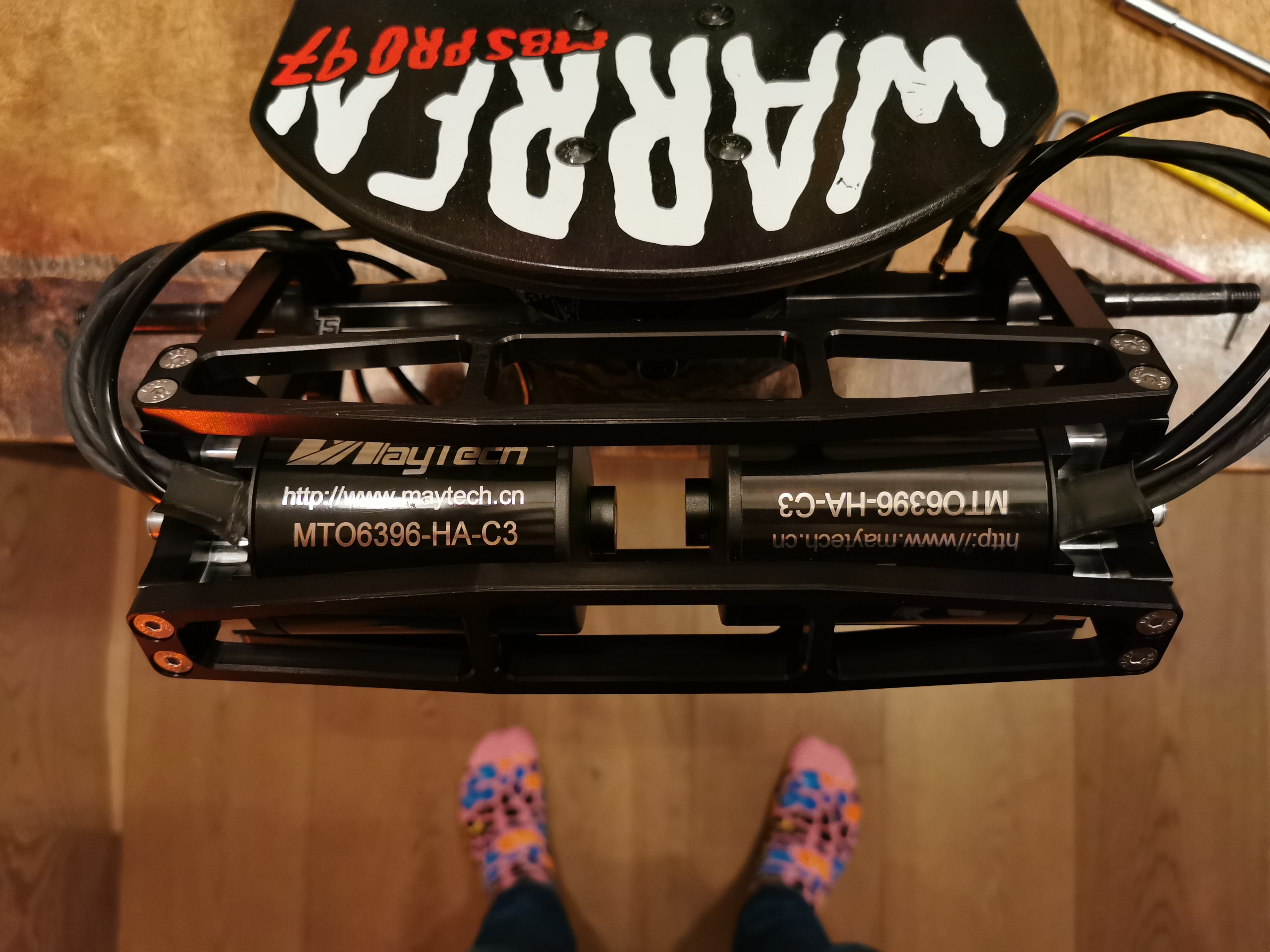

Mmm! So snug! :kissing_heart:
First person I’ve seen use 6396 on a DIY so far I think… hot damn

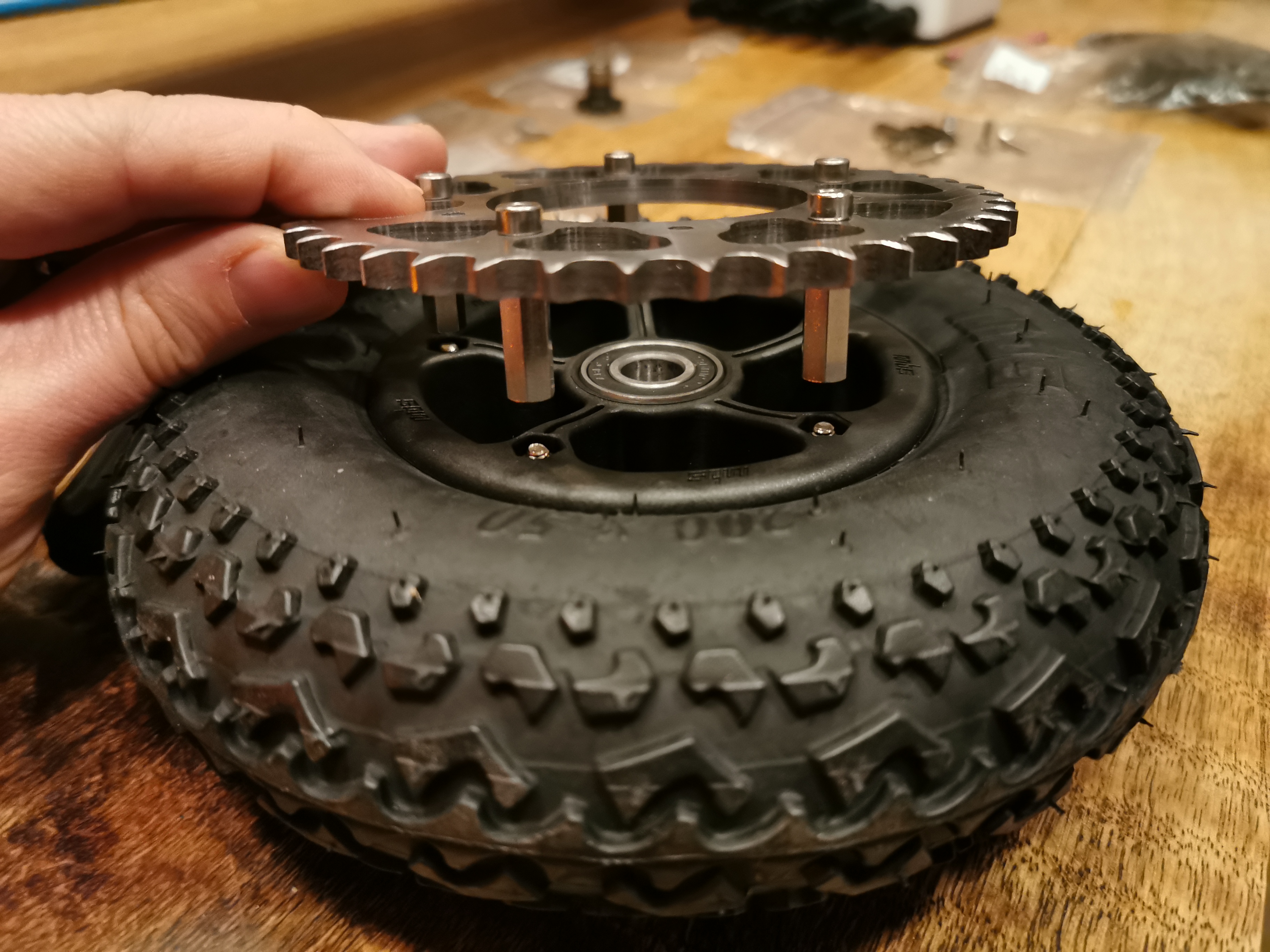

I’ve hit a snag.
@NoWind - should I have expected some long M4s to fasten the wheel drives with?
Watching as well sweet looking build
Have you figured out how to mount the wheel pulley to the hub yet? I have an e-toxx MBS chain drive kit on the way and am very interested on the mounting procedure for the pulleys to the hubs as well.
I would first mount the hubs with the stand offs than the sprocket. Get some m4 screws which are 5mm longer. Should be fine than.
Nice build buy the way :ok_hand:
Remove your locknuts and then you put in the Hex Spacer !?

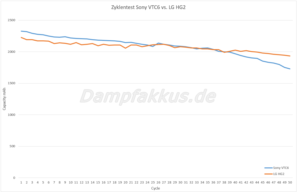

@brown5tick take the 30Q for the sake of longevity. They have a better lifecycle.
Community Board Project X :wink:
Vtc6 all the way!
Why, to get a capacity loss of over 25% after 50 cycles?

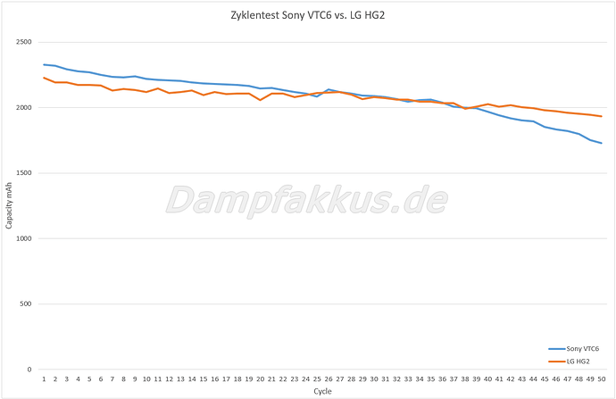

Sony VTC6	LG HG2

IIRC the 30Q has a loss of aprox. 5% after 50 charges. Their is no better 18650 cell for ESK8 right now.
what enclosure is that 3d servisas on the back?
That graph say it starts at like 2300mah. The vtc6 is 3000mah. Yes from what I have seen the 30q has a better life cycle but the vtc6 has a higher output. I currently only have 30q packs but I just bought a ton of vtc6 cells for super cheap. I will soon be able to test for myself if they truly degrade that rapidly.
They charged the cell to a certain voltage and than compared the life cycle.
The result was after 50 cycles 1727mah 74,18% -0,99% for the VTC6 and 1934mah 86,92% -0,49% for the HG2.
