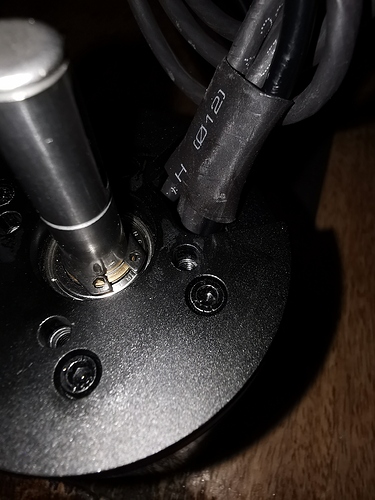

  1. Take another look at the fastenings on the 6396 adaptors - I think I might need longer bolts in there. Those motors are stupid heavy.

I might have asked you elsewhere but can you link that junction box? Curious on the dimensions.
Take care an choose the length wise :sweat_smile:
I had bolts sticking 1mm into the housing which over time damaged the isolation of the phase wires inside the can and shorted two of my motors out.
Those incident as well took one focbox with it.
Something that doesn’t need to happen to others as well.

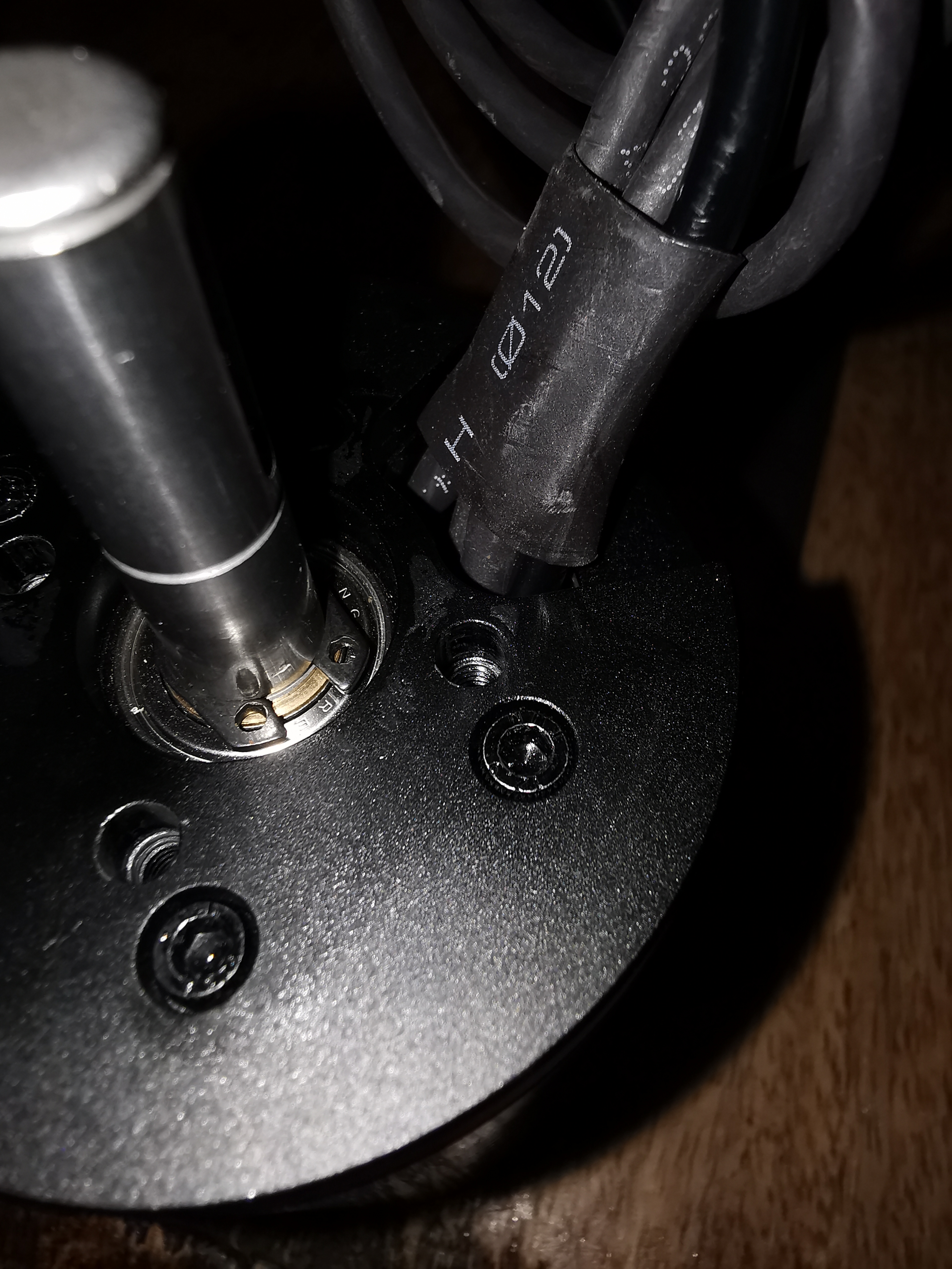

If I’m reading Maytech’s tech diagram correctly, the bolt holes are meant to be 11mm deep. I’m measuring only 6mm. Of that, I’d say about 4mm is unthreaded (see the photo below). So there’s only 2mm of threaded depth in these holes? And that to fasten a 1.3 kg motor to the mounts!? That strikes me as pretty flimsy.
Two things: I wonder if that’s gonna be enough to stand up to the abuse they’re going to take off-road, and [2] it’s way too f cking easy to over-torque and strip the threading… which I did.
@Agnes_Maytech - can you comment on this and correct me if I’m wrong?

6mm only, minus 4mm no-threaded ?? sounds crazy.
this is a new diagram ?
good, they did the D44mm for holes pattern.
Before it was like that :
But you’re right to worry about.
Looking forward to Maytech’s feedback here.
