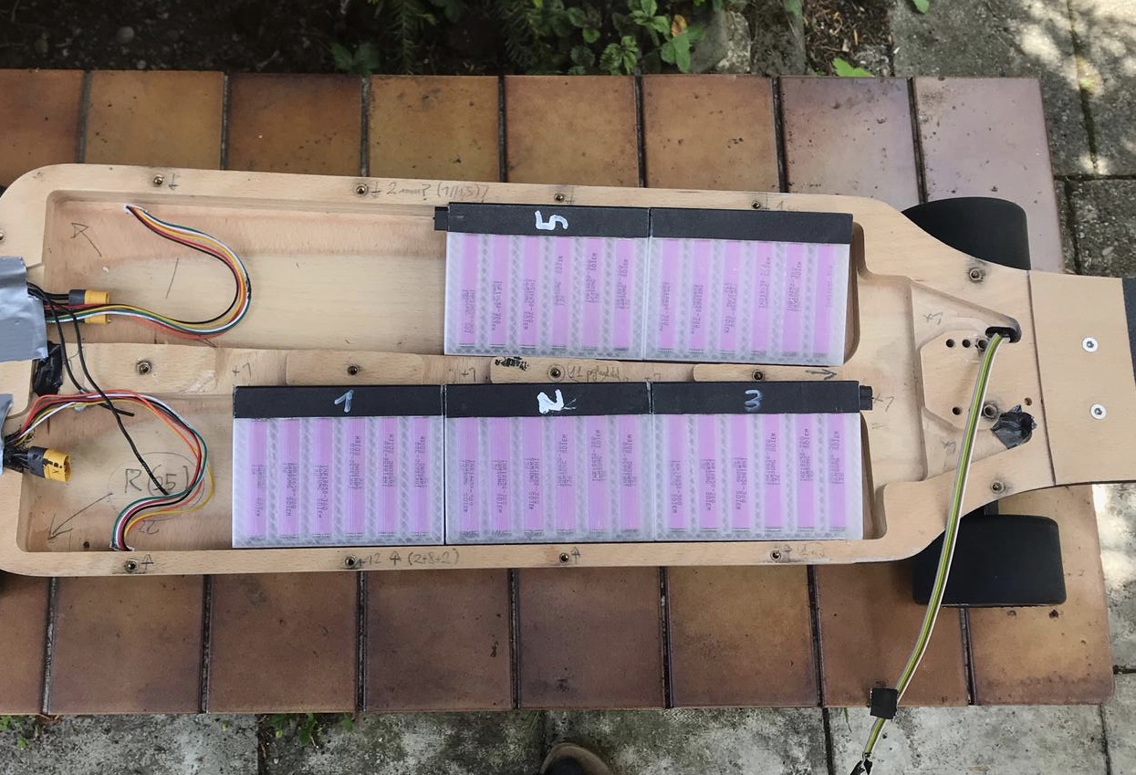

(Setup: Dual 5065 Frontdrive, Ronin Cast (Front +6deg), 10S3P 30Q on NESE based modules, Feather Remote, Popocas, 4.12 Maytech (FOC), Charge only BMS, Metr Pro)
Today’s morning ride:

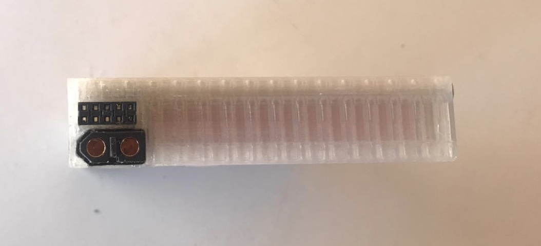

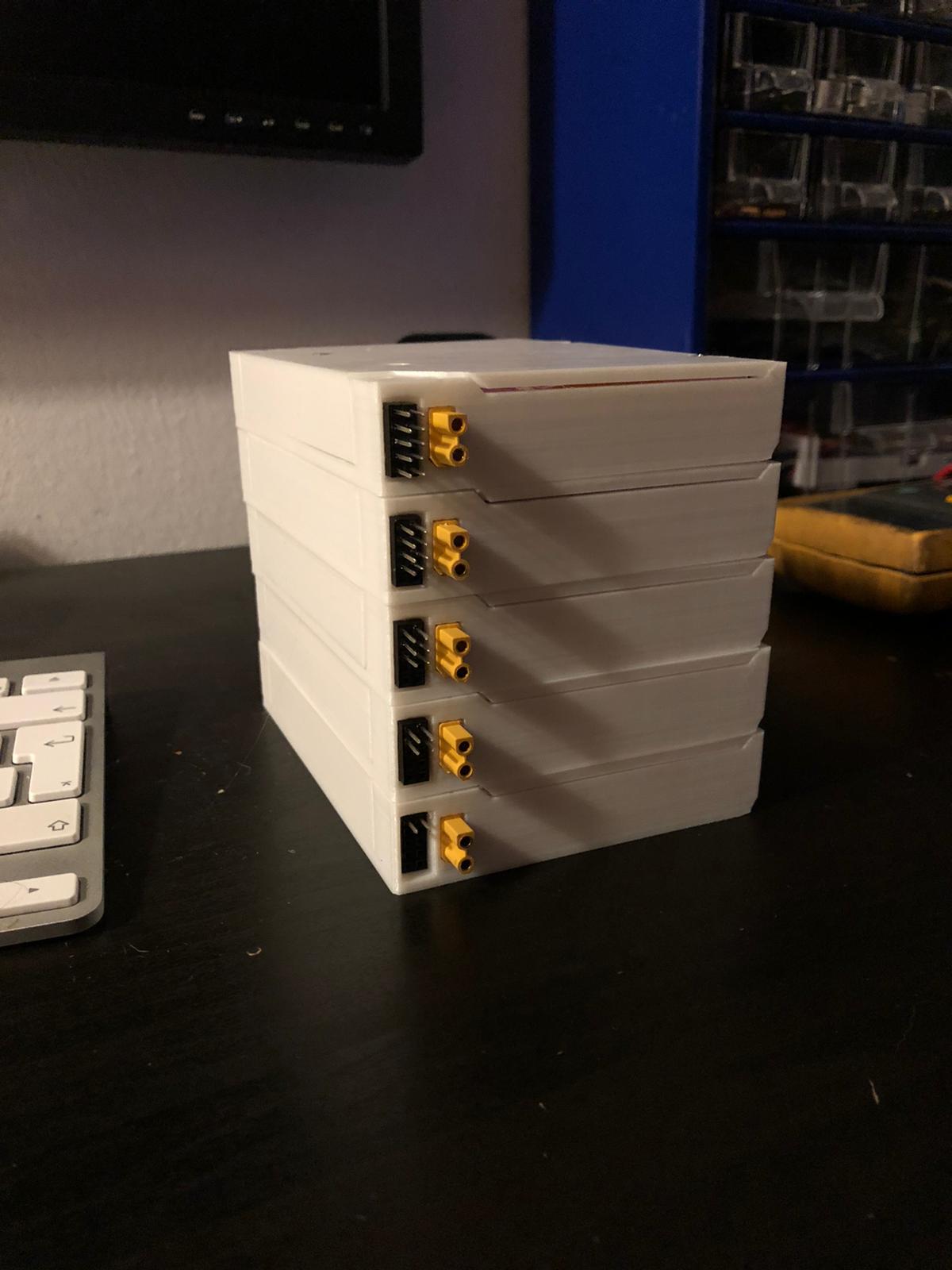

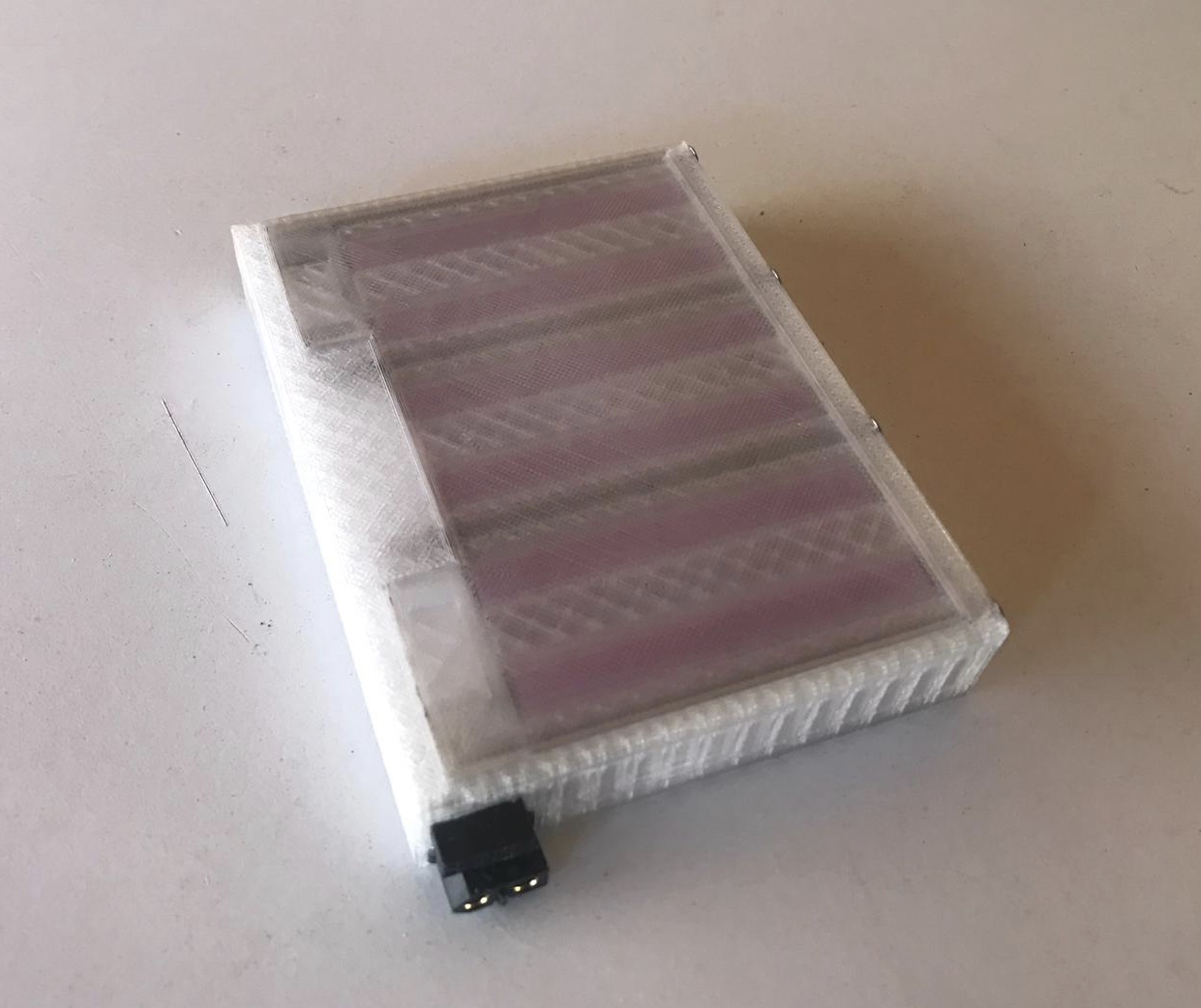

Oohh! How come we’ve never seen anything in those battery modules? They looks promising
Perfect plane capsules, pray tell
My modules are a PIA to assemble, but @StefanMe has a newer design in the works that should turn out pretty mint. Sneak peak:
Looks amazing for decks with no flex. Well done you guys

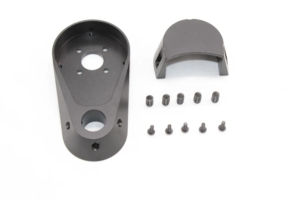

Love the build. Which motor mounts are these?
(only 50XX motors)
They require some modding:
  • Lathe the trucks to 18mm (Pretty easy)
  • Mounting them with 648 green loctite + grub screws is rock solid
  • You need to use an idler since the motor position is fixed, I use this one:
Oh I see. How did you mount the idler? Also, what diameter are standard paris trucks?
