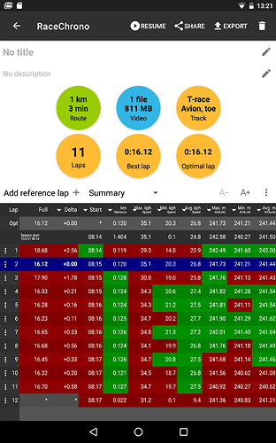

On the weekend, I tested the new footpads in the T-Race. They don’t help much in heel side turns. The binding alone provides enough support.
Toe side is a different story though because you can’t lean on the binding that much. The pads make it easier for your toes to push into the board and the concave makes you more stable. I improved my best toe side lap from 16.12s to 15.68s.
Also, before, my heel side laps were consistently better than toe side. Now it’s pretty much even and I feel that with more practicing, I’ll be making even better toe side laps.
Though the pads don’t have a huge impact on times, I really like them. They give me more confidence and they keep my feet in place so I don’t need to constantly readjust my stance.
Best times from yesterday’s sessions:
Best toe side session:
Former best toe side session:
And a vid:
