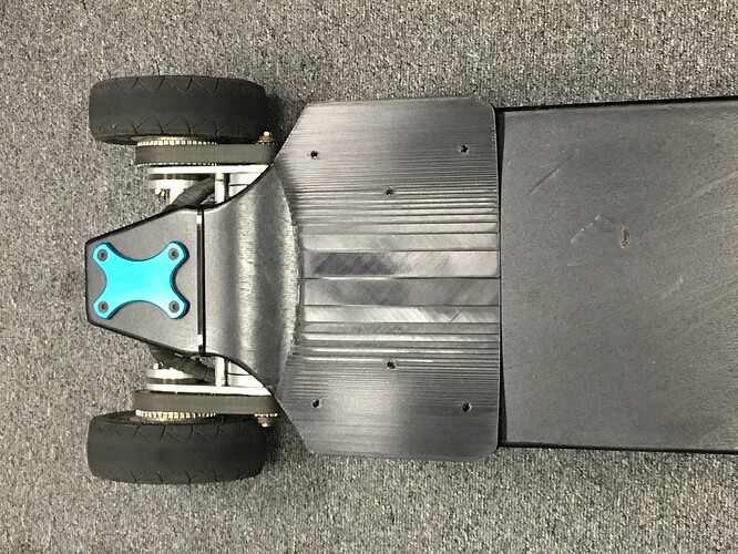

I’m experimenting with a 3D printed concave. I don’t really miss the concave when riding casually but when racing I feel like more support would help.
This is what I came up with:
The part is too big to be printed on my Prusa printer so I split it in the middle and printed as two parts.
For starters, I just used black PLA and printed without supports. The bottom is made to copy the shape of the deck so it’s not completely flat. It doesn’t print great without supports but it does work.
I heated up the finished print with a heat gun to soften it and then I pressed it against the deck. That made it copy the deck shape almost perfectly.
Here’s how it looks on the deck:
I’m going to put some grip tape on it. Then it should look a lot better.
I’m not sure if I’m going to use the holes for the bolts. So far I just taped it to the deck with a double-sided tape and that seem to be good enough (and I didn’t even put a lot of tape).
I haven’t ridden the board yet (it’s rainy) but just by standing on the board I can feel there’s a lot of difference. I’m sure this will be a significant improvement when going around corners.
Here’s the STL file. Mirror it in your slicing software to get the second part.
