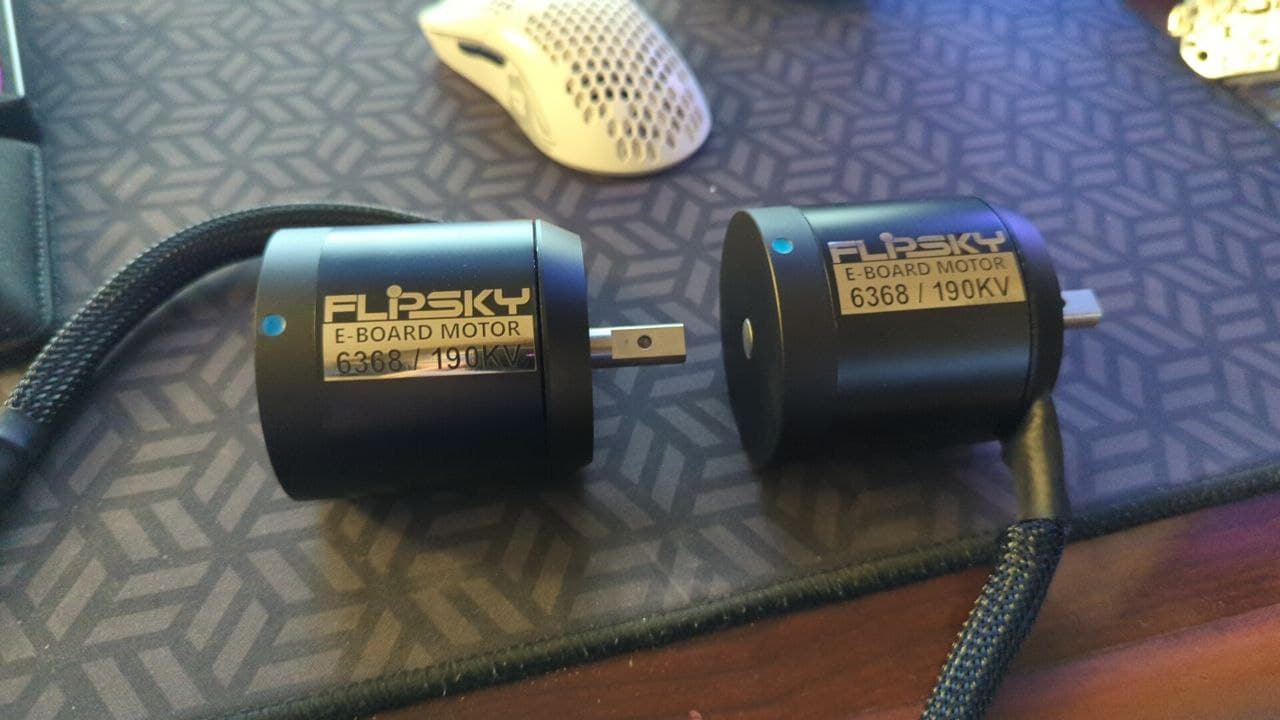

Did you get the 190Kv or 140kv motors? At 190Kv yeah 18/36 is quite high speed and low acceleration, but at 140 it’s a bit far in the opposite direction. It’ll feel great and be more efficient it just won’t go to super high speeds

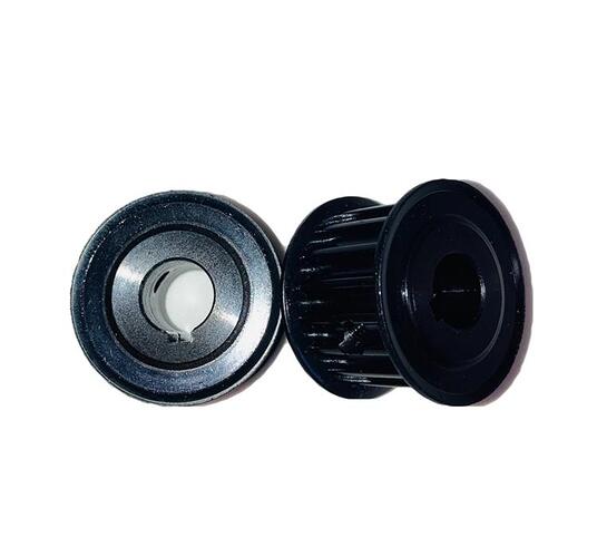

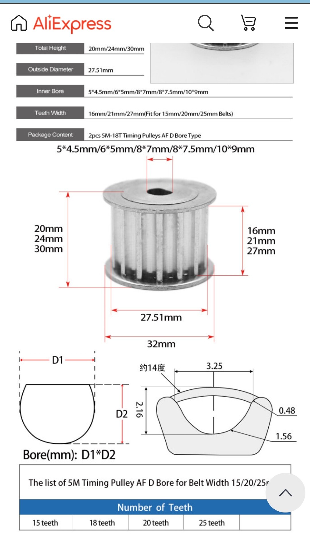

That D shaft has a few different size variations, maybe someone with the flipsky ones can confirm which profile to order. The page seems to specify D1xD2 as the size, with D1,2 measured like this
Looks like a good find if the profile is right, haven’t seen D shaft ones anywhere

I got a 190 kV one. Maybe my thinking was off as I don’t have much experience, but I was under the impression that 16/36 worked pretty well with 90mm wheels or even a bit larger, and once you account for the wheel 18/36 on 80 mm should be the same as 16/36 on 90 mm. Also, I am in Florida so climbing serious hills isn’t much of a concern. I was actually mainly concerned about mixed metal corrosion as I’ve had that be an issue with other things and corrosion is quite bad around me since I’m quite close to the water. Maybe I should try to find a 38 tooth for the wheel to bring the ratio back a bit closer to 16/36. I’ll probably just test what I got and go from there though. Also, I did see the flat dimension and was a bit concerned about that, but hopefully it’s fairly standard.
Actually you got me searching more and I think “D2” on the Flipsky motor is 8.5mm so it won’t be quite right. I had looked at the diagrams before, but hadn’t noticed the 8.5 in this one.
On the right that 8.5 appears to be the “D2”. We’ll see how that works out, but I guess I’ll probably order one of the Flipsky 15 tooth ones so I have something that for sure works.

Oh yeah I hadn’t caught that either. It also looks like flipsky’s D2 is 3.2mm as opposed to 7mm or 7.5mm. What battery are you using? For what it’s worth on 10S the 15T Flipsky pulley with 36T motor is pretty much the gearing I’d pick anyway to be honest, theoretically max speed of 43km/h with a loaded speed around 39. I do tend to prefer low speed high torque though, if it’s 12S add 20% to those speed values

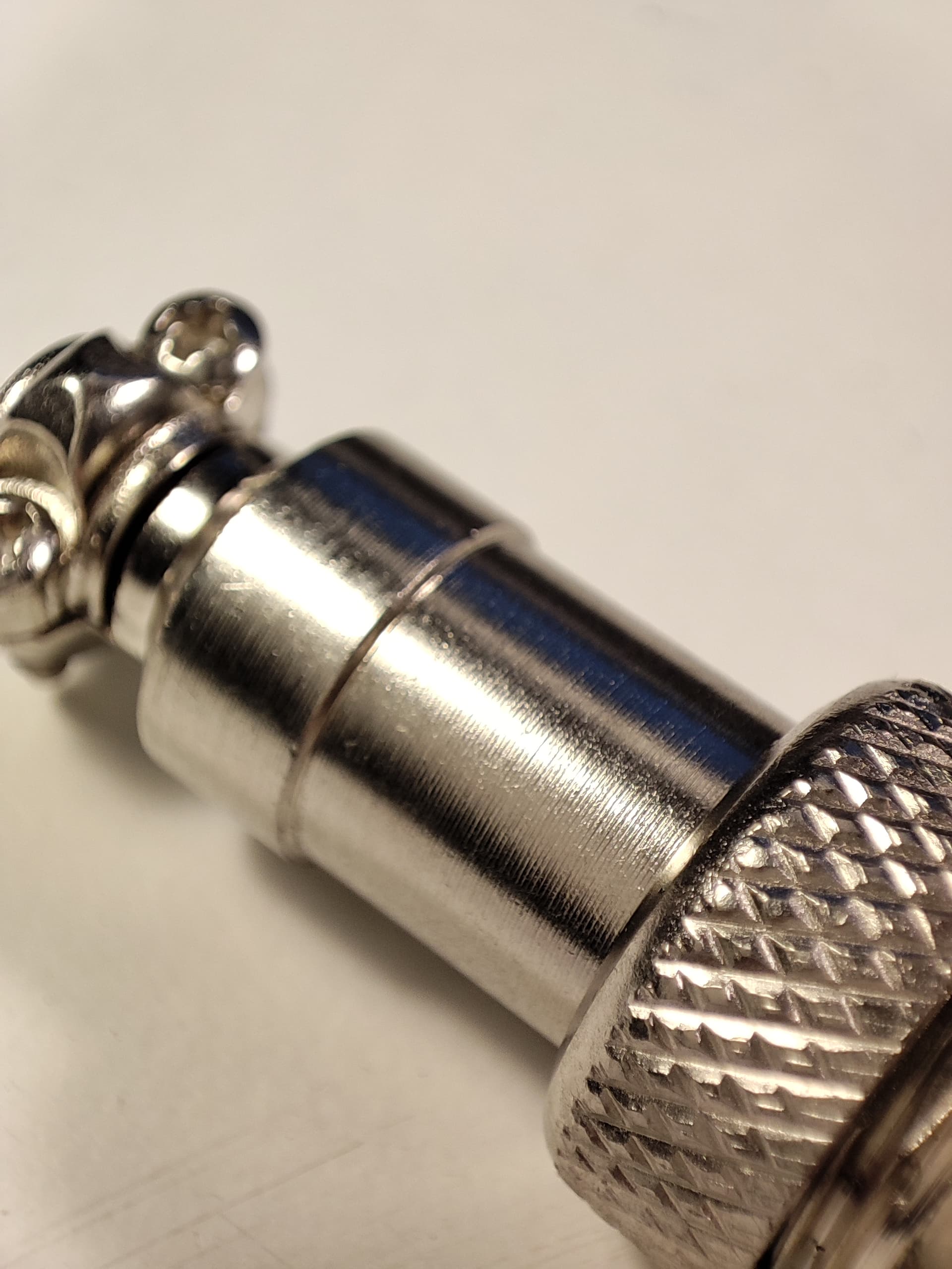

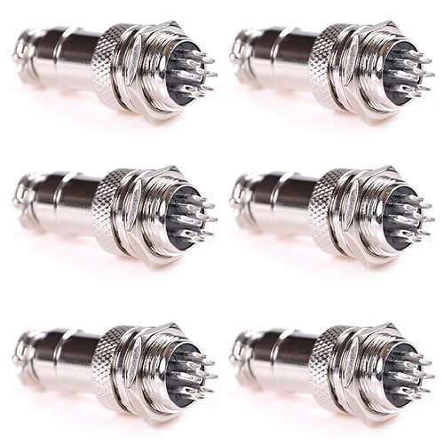

Hope I haven’t posted this already but I ordered a bunch of these for sensor connections
€0.80 for a male-female pair, shipped from the EU, still a little slow to arrive for me (3 weeks but I blame the global Christmas/covid/broken system, and the fact I’m on an island that’s got the brits sitting between us and real EU), seem to be much higher quality that I expected. There seems to be a good bit of machining going on, not just die cast out of whatever scraps they had, decent surface finish

14t d shaft pulleys dont exist for this shape shaft. the only pulley that fits is the one flipsky makes, which is 15t
Yeah but the shaft is still mostly round. So you can fit still any pulley on there. Just put the set screw on the flat part, and use some locktite. :smiley: Thats what I did, and it worked fine :smiley:
