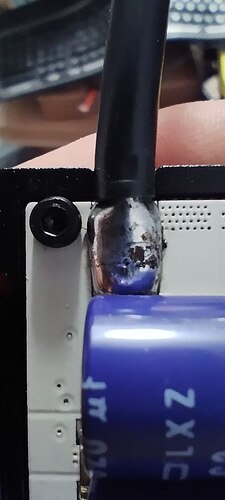

I have some concerns about air-gap separation with mounting hardware and the battery positive solder pad in your design; the left-most phase wire for each motor is within 1-3mm of either a mounting bolt head or the battery positive. As such, (this becomes more critical with the higher-voltage models such as the D100,) you may not have enough isolation to avoid arc-shorting between phase output and case ground or battery positive input. I also see flux that was not removed between pads on my D60 I received. For those that want to avoid some of the failures others have seen, does it make sense to remove residual flux and coat the solder connections with some sort of insulating material such as neutral-cure silicone or varnish?
Another option I guess would be dielectric silicone grease, though that has a chance to wash away or vibrate off over time. Regardless, i’d highly suggest to re-arrange your pad spacing to reduce the possibility of arc. Considering the few failed ESC’s we’ve seen have a blown positive solder connection, I suspect this has something to do with it. If I do add insulating material to my ESC, will that affect any warranty? I also need to swap to 4mm bullets and AS150 connector for my board.
Should people just add their own neutral cure silicone (dab of hot glue)?

Good to know; as it turns out, I was mistaken and the air gaps are probably fine, though with the proximity if anything even remotely conductive reaches the pads it’ll still cause a pretty serious short. I’ll probably still add conformal coating of some kind just to hedge my bets.
