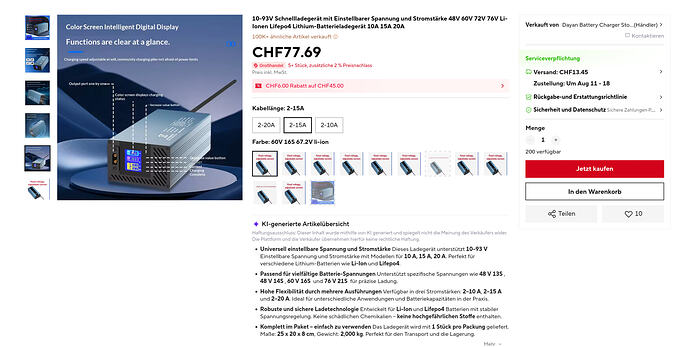

Hello i search charger….
https://de.aliexpress.com/item/1005011942106479.html?spm=a2g0o.productlist.0.0.41afo99uo99uSS&mp=1&pdp_npi=6%40dis!CHF!CHF+77.69!CHF+77.69!!CHF+77.69!!!%40210389a017857640341607234e110c!12000057091674954!ct!CH!137128574!!1!0!&_gl=1*10barkr*_gcl_aw*R0NMLjE3ODU3NjM4NTAuQ2owS0NRanctTURUQmhDZ0FSSXNBS0FrZGxUTVhrZVk1LUtsajMzUG1DRzhGX1RIcVNqNXg2UEU2aUxLa2FKVFdZVUpGN3ZHelAxSnNCQWFBbTk0RUFMd193Y0I.*_gcl_dc*R0NMLjE3ODU3NjM4NTAuQ2owS0NRanctTURUQmhDZ0FSSXNBS0FrZGxUTVhrZVk1LUtsajMzUG1DRzhGX1RIcVNqNXg2UEU2aUxLa2FKVFdZVUpGN3ZHelAxSnNCQWFBbTk0RUFMd193Y0I.*_gcl_au*MTk3NDk1MjM2NS4xNzg1MDU0NDc0*_ga*MTk5OTk1NDc1NC4xNzg1MDU0NDc0*_ga_VED1YSGNC7*czE3ODU3NjAzNDgkbzUkZzEkdDE3ODU3NjQxMjQkajMxJGwwJGgw&gatewayAdapt=glo2deu#nav-specification
