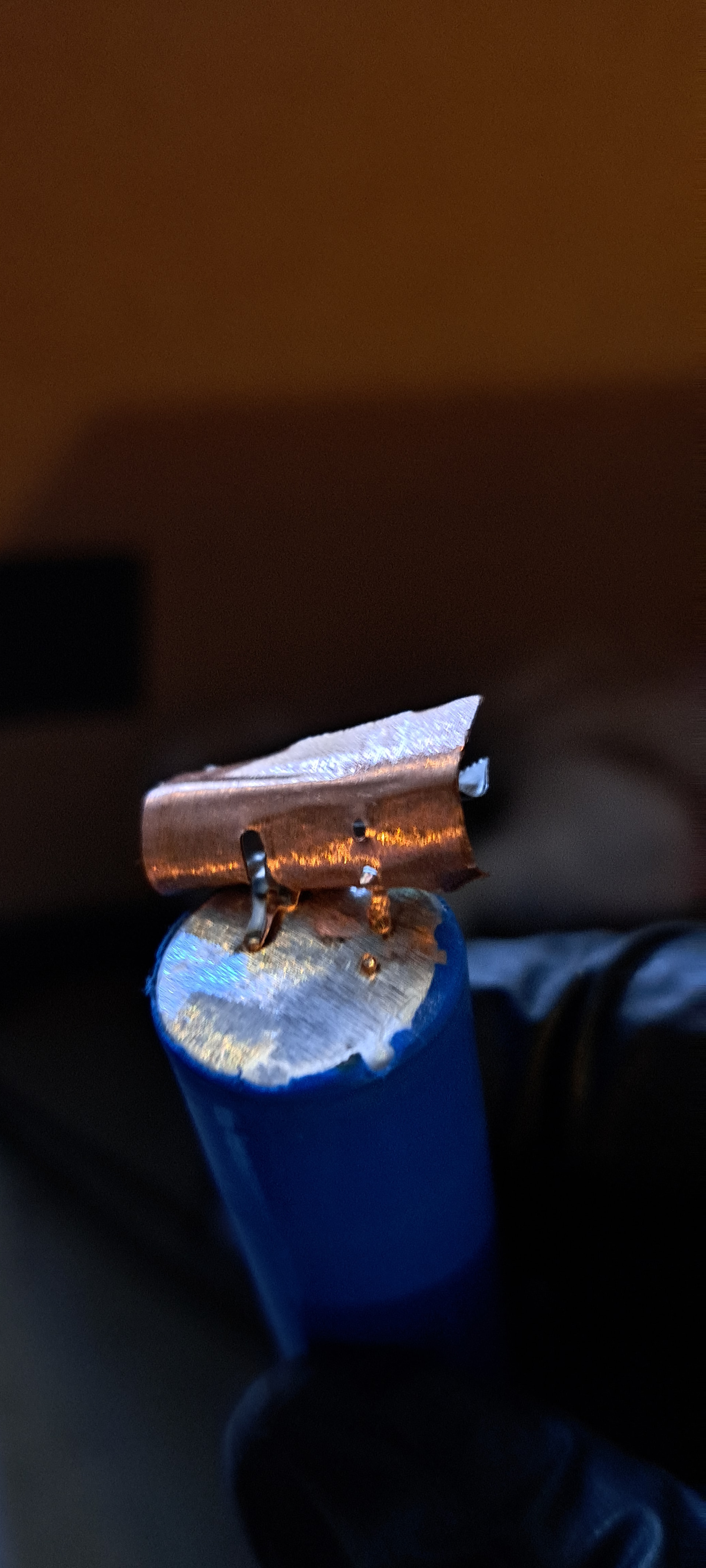

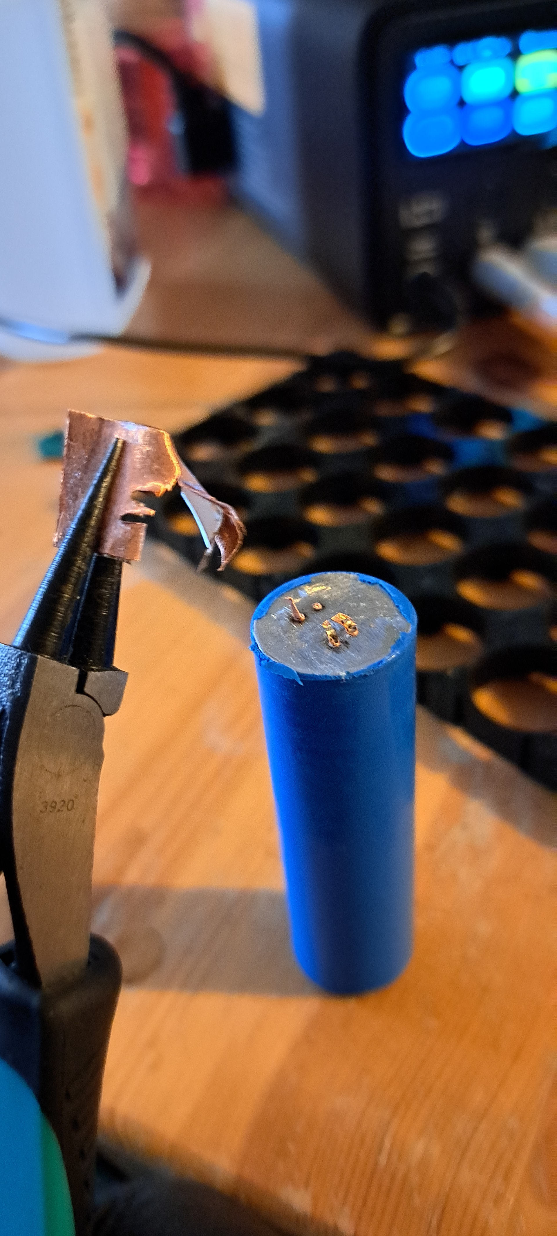

I decided to double check.
This is gear 869 on my AwithZ P20B.
0.2mm copper under 0.1mm nickel plated steel on a Murata Vtc6 (18650)
Both welds are very solid, and almost identical in size.
Hard to see in the photo, but the force required to tear the sandwich this far distorted the surface. This was rolling the strips with needle nose plyers tips.
I feel this is the minimum weld strength one should shoot for in esk8 applications, and I believe most of the more experienced battery builders here would agree. @BenjaminF @jack.luis @glyphiks
My first weld (not shown) was at gear 769, and one of the pair of welds popped off pretty easily but the other was almost as large as the welds shown above.
That 769 gear test was on the negative / anode / Can side.
When one weld of the pair is strong but the other weak, more power is needed, in my experience.

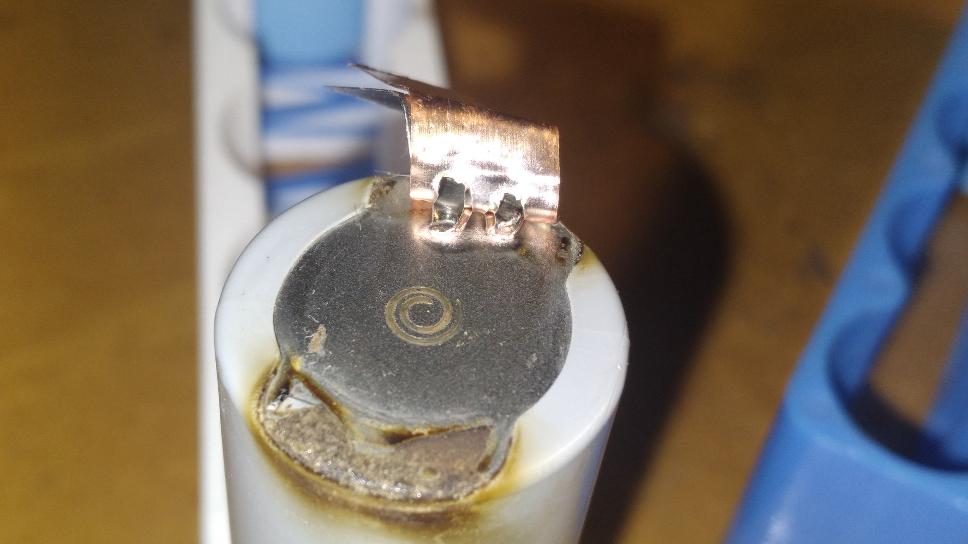

Below is gear 869 on the Anode. Same 0.2mm copper under 0.1mm Nickel plated steel. No flux. VTC6.
This weld is not quite as even, although likely more than acceptable as the copper tore.
It is just that the welds are not quite as big of a diameter and are not as close in size. I’d likely bump up the gear by 10-15 to get it to look the same as on the cathode / +

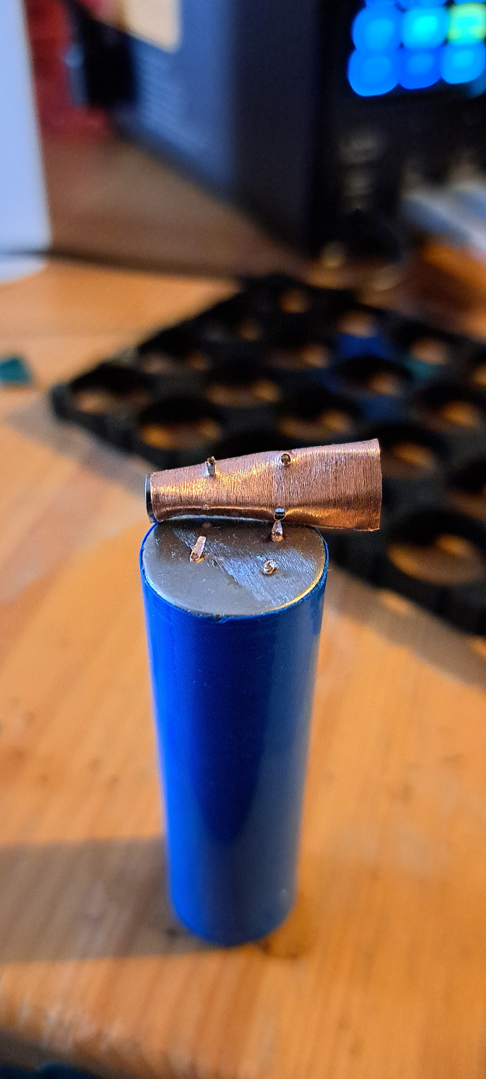

Below is using the same, but with 0.1mm stainless and gear 529.
Unfortunately the probe on the right slipped right to the edge of the sandwich before I hit the pedal, The electrodecables really seemed to jump and hit the cell hard, and I heard the Pffft of electrolyte escaping the punctured( fully discharged) VTC6 cell.
It smelled different than other cells I have punctured, not the same sickly sweet, almost as if there was some black pepper mixed in to the usually sickly sweet smell, hard to describe.

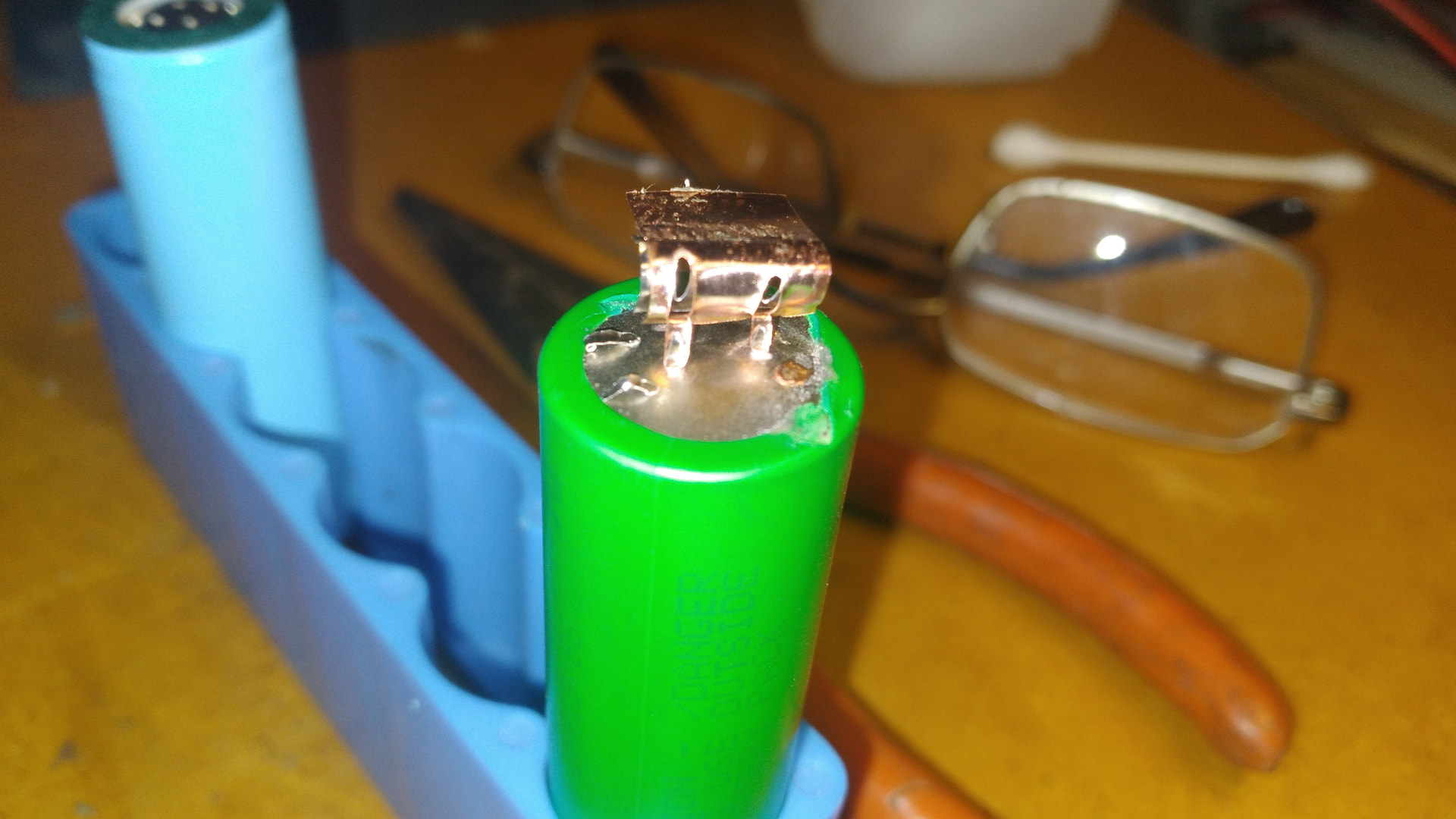

Here is Gear 529 on an Ampace JP40. Same 0.2mm copper under 0.1mm Stainless steel, no flux.
Please ignore the burnt heatshrink. This donated cell was meant for different tests (spot weld ampacity) that I have completely flaked out on performing. Apologies.
I usually use gear 550 on 0.2mm copper under 0.1mm stainless steel when not using flux.
I lowered the gear to 529 for the Murata VTC6, as its can is either thinner, or a softer steel alloy, or both, and so I just left the same settings when I busted out the JP40.
While gear 529 seems acceptable with this combo, the welds are not as equal as I would have liked, and also note how closely I held the electrodes to each other on the sandwich.

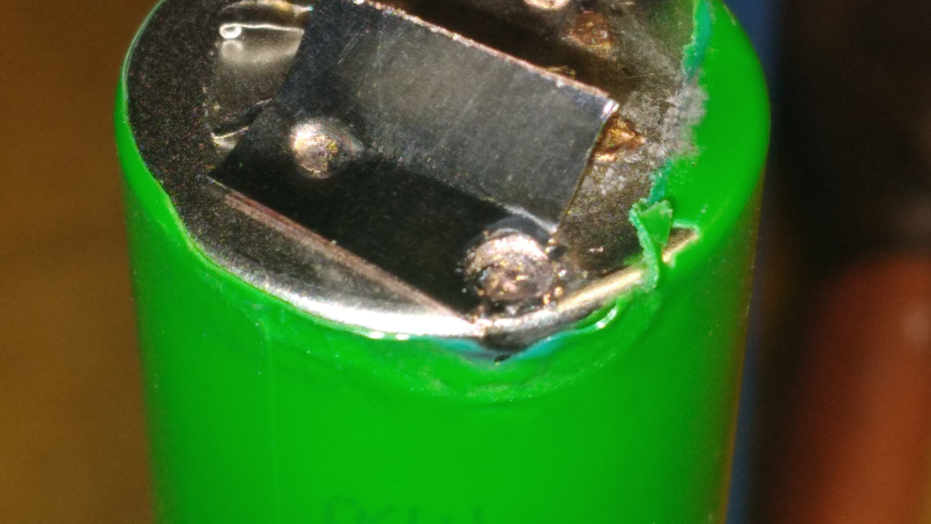

This is one variable that I do not see mentioned very often, but the further apart the electrodes are upon the sandwich during the weld pulse, the more that the welding heat is dissipated by the can and the busbar, So having the electrodes very close to each other, will allow lesser welder power to achieve stronger welds.
But having the electrodes close together is dangerous, as if they touch, then the welder might get damaged / destroyed.
I recommend trying very hard to always have the electrodes at the same angle, with the same size and shape of the tip, and the same distance apart, and use the same downward pressure.
For consistency and repeatability.
This is probably far more important when using copper sandwich, than when using pure Nickel.

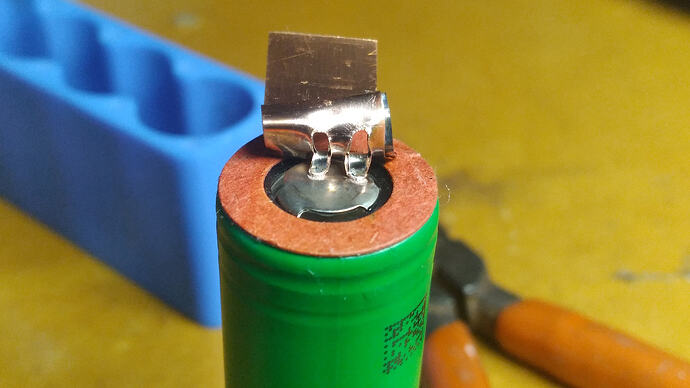

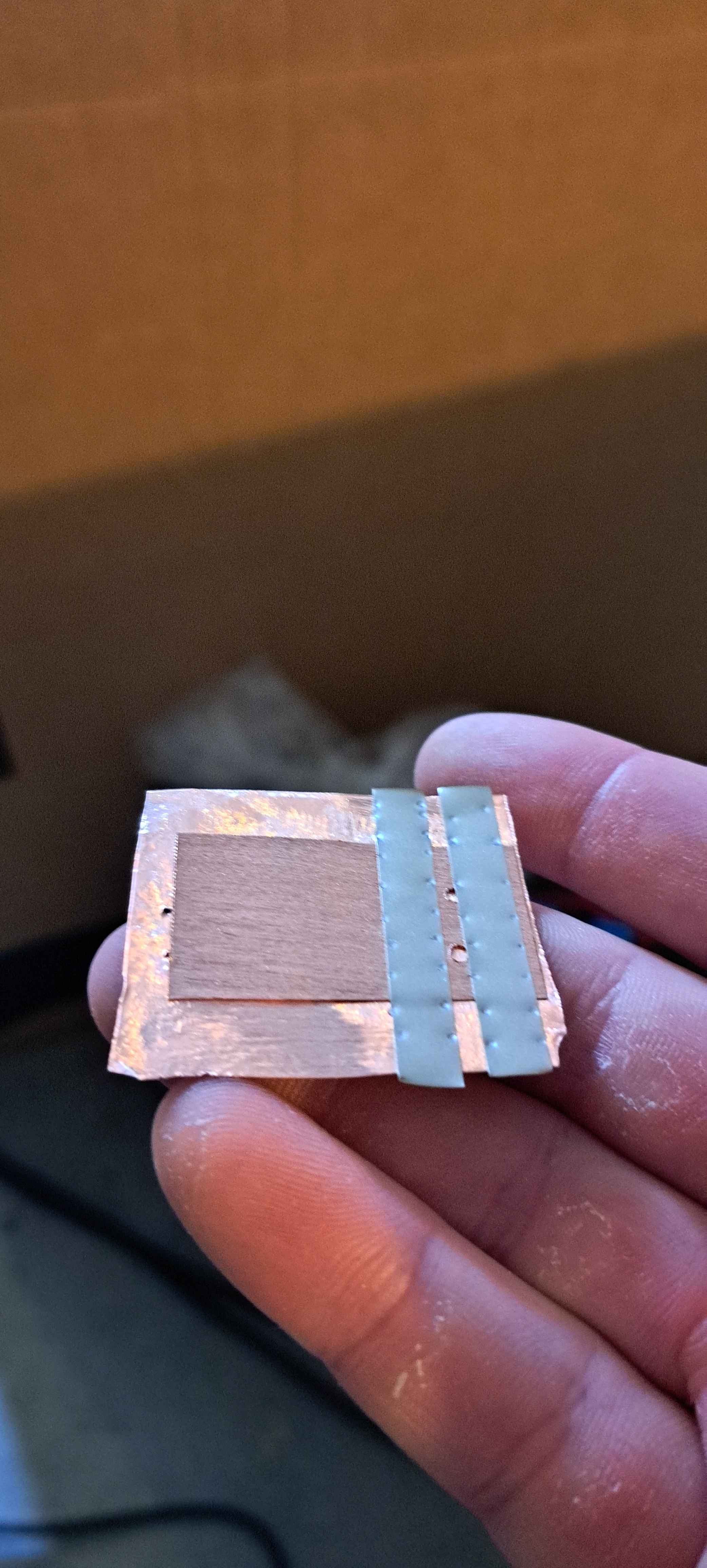

Here are some early results using 0.2mm copper + 0.1mm stainless steel for anyone whos curious.
With a slit cut in just the stainless steel:
With a slit cut in both the copper and stainless steel:
No slit in either:
These are some of my first attemts so this looks very doable with a uf20b.
These were all done with gear 75, intermittent 0.2ms, preheat 0.15ms, dual pulse.

Looks to definitely be in range of the UF20b, but more than gear 75 for sure.
The shape of the plyers which you are using can make one ‘torn’ weld look a bit bigger than the other, but when one weld just pops off with no tearing, just some copper residue, then more power is required.
Can try and confirm by switching the sides one holds the plyers in.
