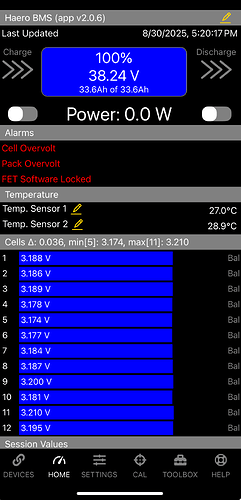

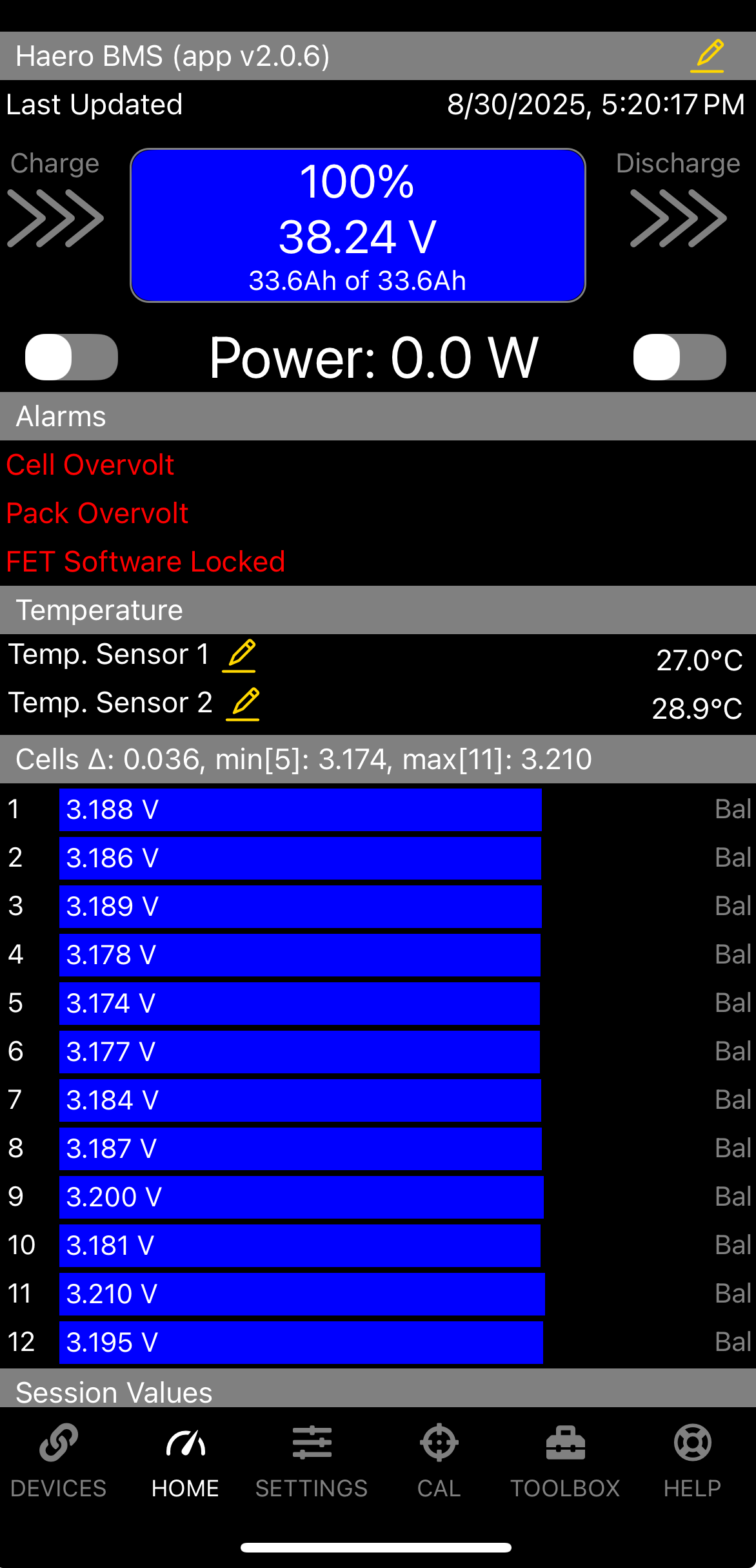

Other problem, my battery says this and It won’t charge, how can I reset settings correctly?
It’s a 12s8p p42a

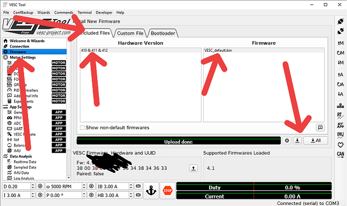

I got the og firmware downloaded on 6.06 but it didn’t work so now I’m trying 3.01 Vesc tool with the 5.3 version.
The older Vesc tool doesn’t seem to have the download firmware archive.
More infos

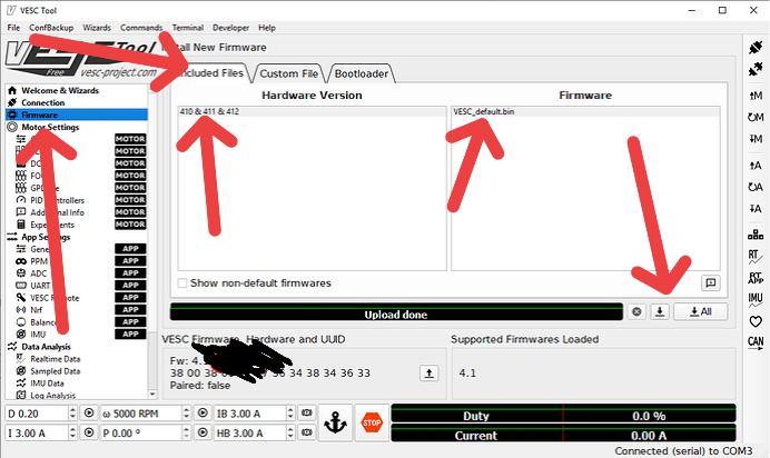

You don’t need to. Use the firmware that comes with the vesc tool from the normal firmware tab.
Firmware - included files - 410/411/412 - vesc_default
older screenshot from the Internet, it’s 3am, chill.
