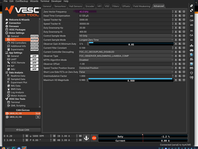

What kind of tires and gear ratio are you using?
He’s on 9:43 chain drive with 230mm tires.
Not sure, there is a Us warehouse though.

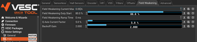

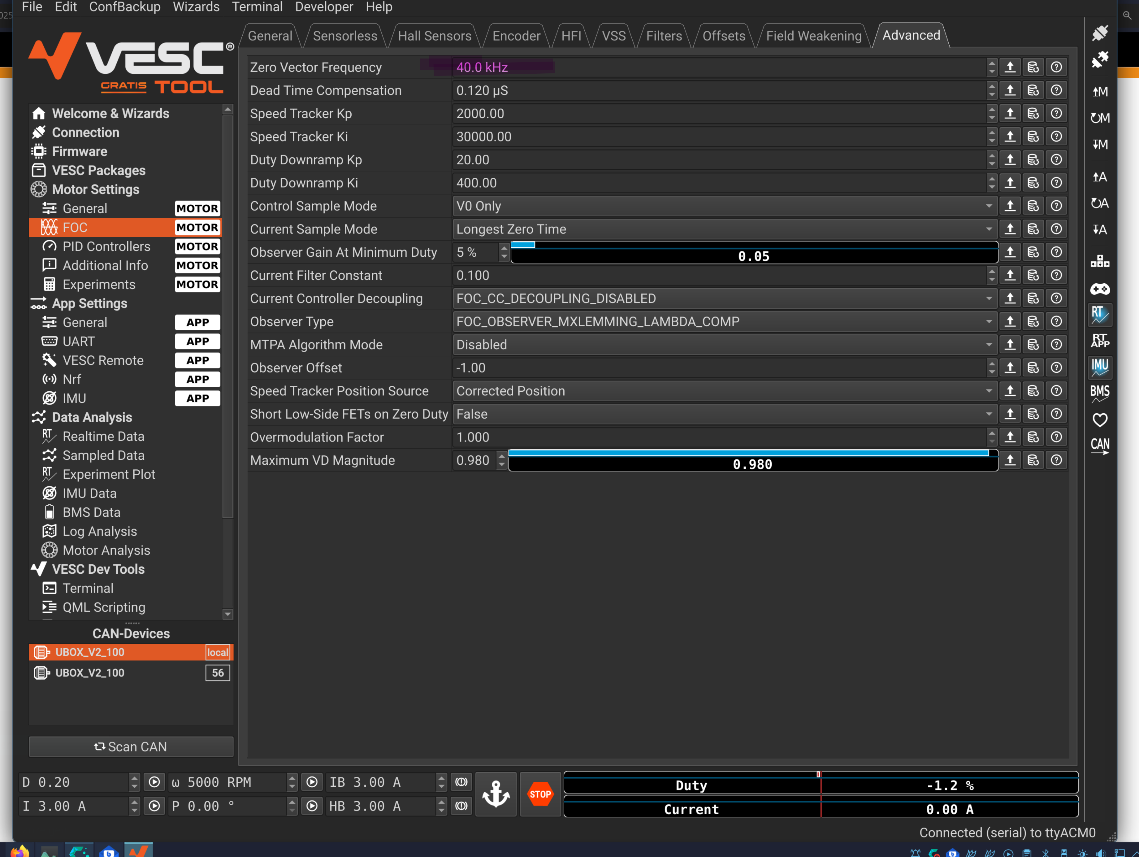

Zero Vector Frequency you have ? Test this setting +5 or +10 KHZ more.
Me Vesc is this option 1/2 all time.
I have never messed with this setting. Will see if it helps him out. Appreciate it!

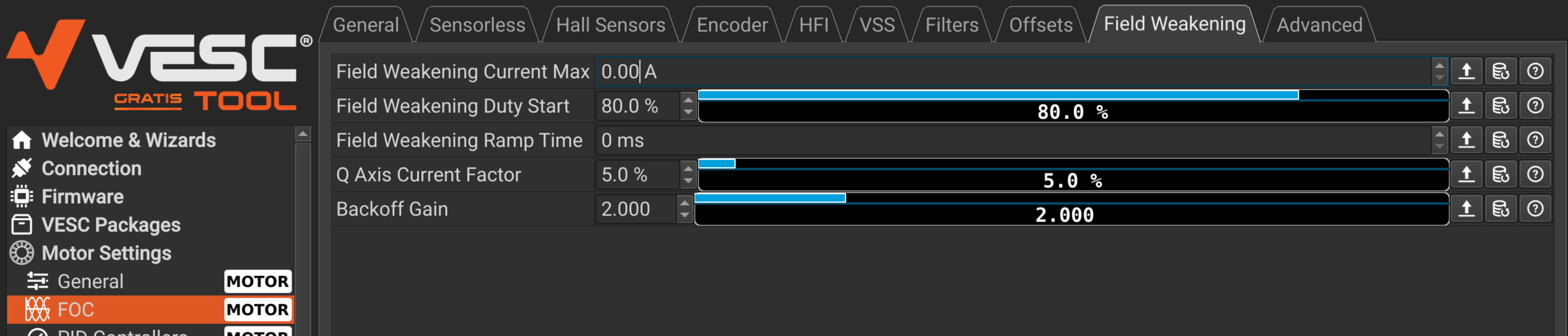

This Option Field Weakening Current Max you make start withe 4Amps
What does adjusting these settings do to solve his cutouts at full throttle? Just a quick overview would be nice. There’s always more to learn in VESC tool…
