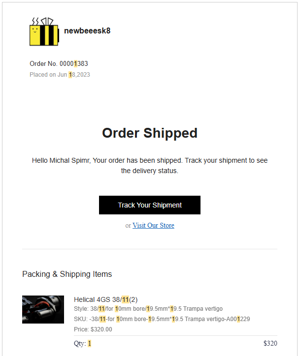

I wish you good luck with 4gs :laughing: trust me you’ll need it
I had nothing but good experiences with the 4GS drives I owned

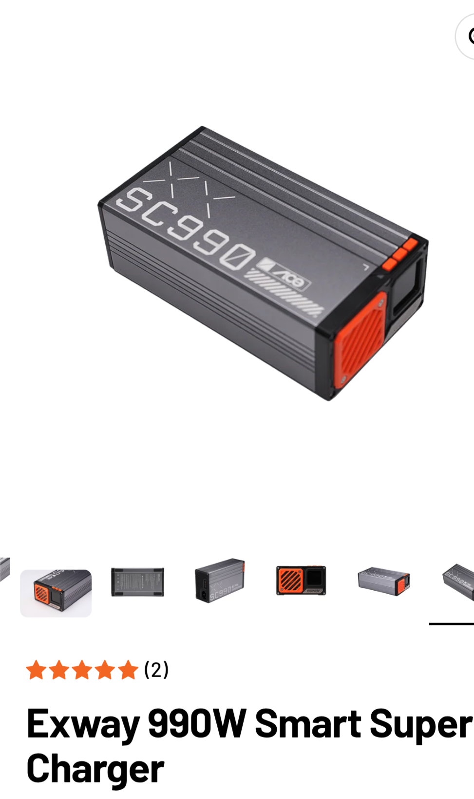

The Exway variable charger had a big price drop and i think is on sale right now, what’s your budget?
Ive had really good experience with the 4gs, what issues did you have? Are you still using them or you have something else now?
Reading through older threads, it seems like a lot of people assumed these came fully assembled and properly locked down from the start, but they actually come assembled without any Loctite and the screws are pretty loose out of the box. I’m wondering if that reputation just stuck because of a few bad assumptions.
Personally, I’ve had a great experience so far — they feel super smooth. That said, on my first setup I didn’t have them tightened close enough to the wheel, and I’m pretty sure that led to some damage on one side (which is why I ended up grabbing a backup set).
From what I can tell, there are just a few key things to get right during setup. Once everything is properly tightened and secured with Loctite, they seem to hold up really well.
You can read it here.

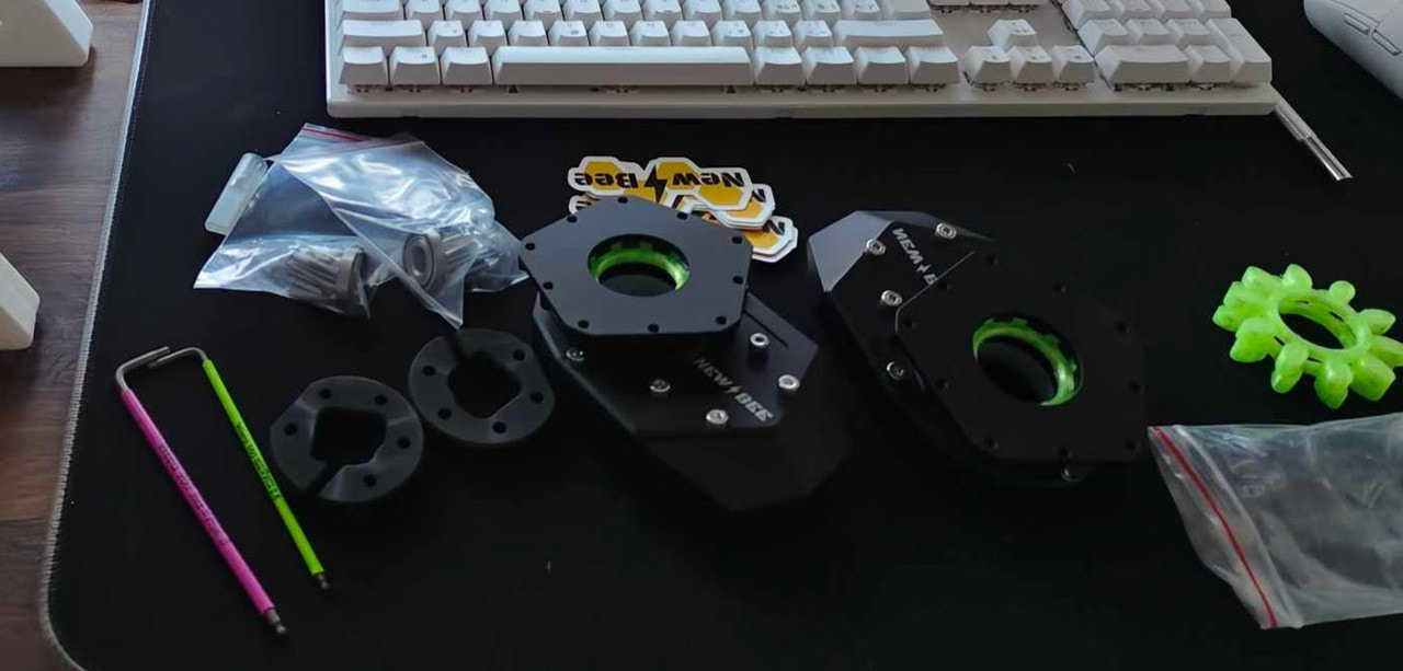

My friend’s 4GS ended up the same… In a trash and also with broken plastic teeth.

Well my budget WAS gonna be less than that but that’s really compact and variable up to 22s I think I’ll just bite the bullet on the cost especially since it was like $400+ last I checked.
This is exactly what I’m looking for though you’re the best bananaman.
@ShutterShock you have this charger right?
Do you know if it has a physical 110v/220v switch or if it automatically switches when plugged in?
Or (hopefully not) if it’s set by the factory at purchase and can’t be changed?
