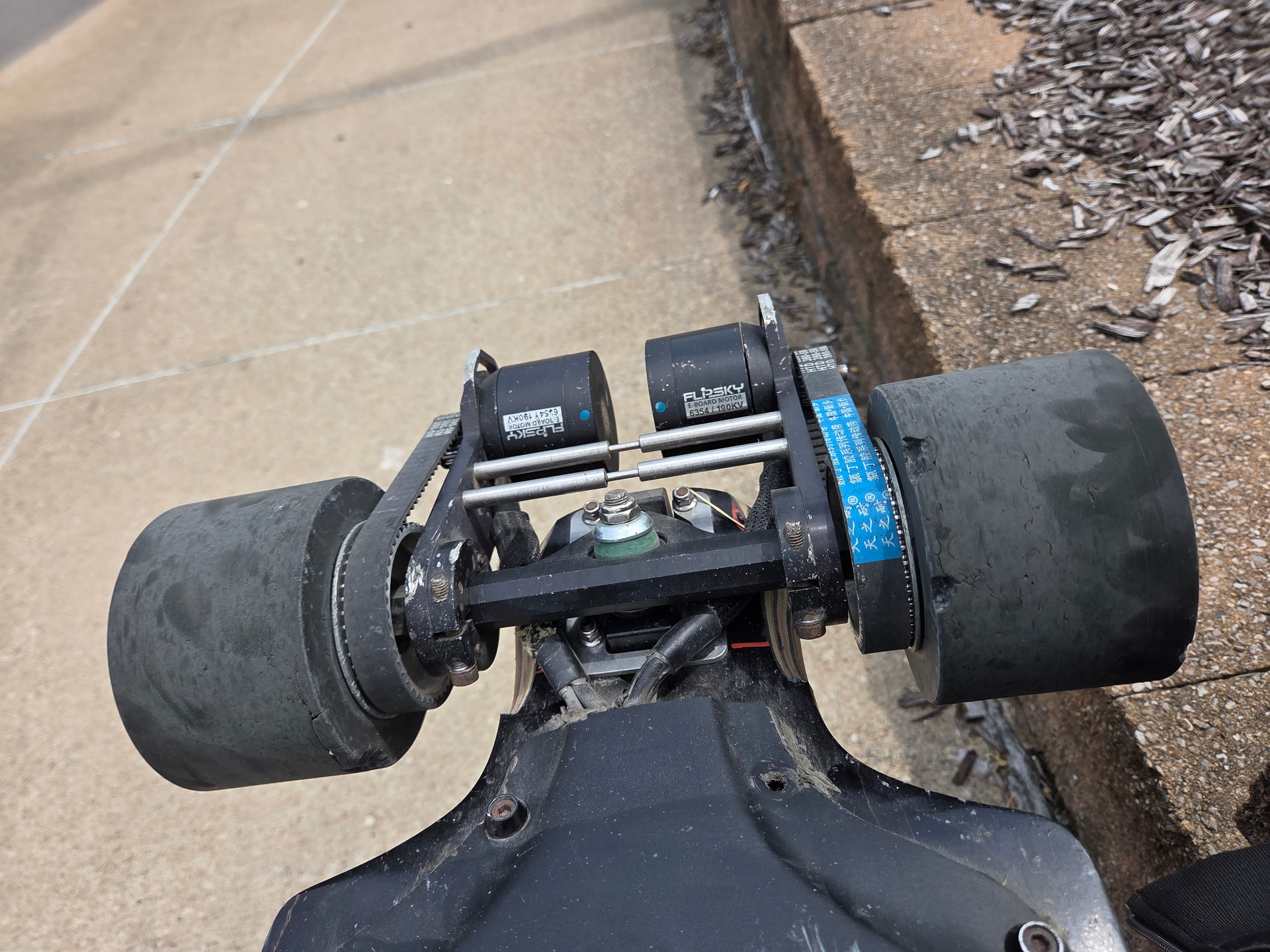

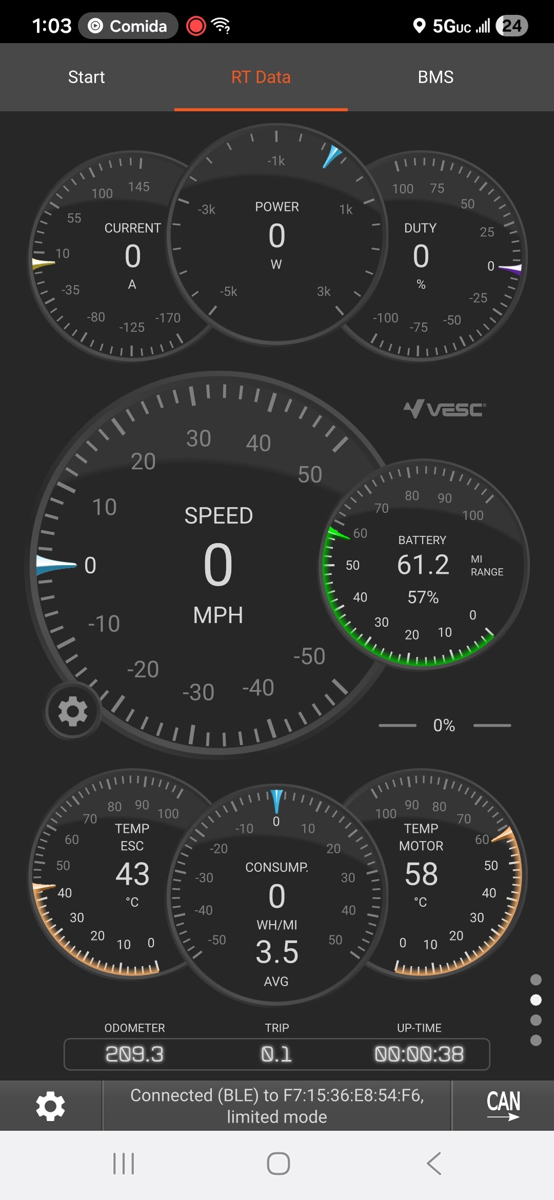

I’m on a lunch break ride on the Hummie.
12s3p BKB Zenith and Flipsky 6354 motors and a Z-mote.
I’m in the middle of traffic waiting on the light behind a car.
A good 5 miles into my ride.
And the board stops responding.
And it won’t really roll…
What in the Vesc Hole could possibly be going on.
I turned it off and on and it seems normal.
Before turning it off the remote was not responding. And both motors had a lot of resistance.
What would you do?
Throw the board in the river?!!
I am not even sure where to beggin with trouble shooting.
A while back this board turned off on me randomly too.
99% zmote related :face_with_tongue:

I would always type “faults” into both vesc channels separately before powering off if something weird happened. It’s case sensitive too. Whenever it affects both motors, and there’s no fault - I assume it’s input related.
I expect there would be no fault in this instance, and it’s likely associated with the remote, and by the sounds of it the vesc was likely receiving an input for braking. Do you have smart reverse enabled? If you do, and it was stuck providing braking, then something even weirder than a dodgy remote / receiver is going on.

I do have smart reverse on. And it May very well have been in use when it went weird.
If there was resistance on the motors, cause by a braking input, and the motors hadn’t started reversing then it doesn’t really make sense.
I don’t have a data logger either. I assume they’d get expensive putting one on each board, doesn’t seems a priority for my own type of usage at least, and something else to go wrong.
What motor controller are you using? If it had brakes stuck on, and not going into reverse, it sounds controller related.

Bkb Zenith on 6.05
And an older trigger Z-mote.
I’m at least going to flash new firmware and run motor detection again.
I have been meaning to change the remote on here for a GT2B anyways. I just keep putting it off because of all the butyl tape under the enclosure.
So I may also change the remote.

Rebuild, break it down and swap in a new remote and receiver first imho. Two warnings is one too many. Might not be the receiver or remote getting old but it’s the weak link. Give all the connections another dab of glue or shrink and go ride :face_blowing_a_kiss:

Stormcore? Sounds like
Ha. Interesting. I remember reading about that back when…
It a bkb Zenith in there.
But it is entirely possible I was right above one of those stop light coil things. When both motors were giving resistance.
After that day I had installed 6.06 and ran detection and it looked good.
I went on a lunch break ride. All good.
On the way home I stopped to look at some baby geese for like a minute.
Before that it was all normal.
When I tried to roll away one of the motors was behaving weird. Cogging and would not spin up .
I ran motor detection and one motor came up unsensored.
I flipped it to hfi and made the next 1.5 miles home ok.
So at this point I suspect damaged wires or loose wires…
I am going to open it up and redo connections and put in a new remote like @Pecos suggested.
