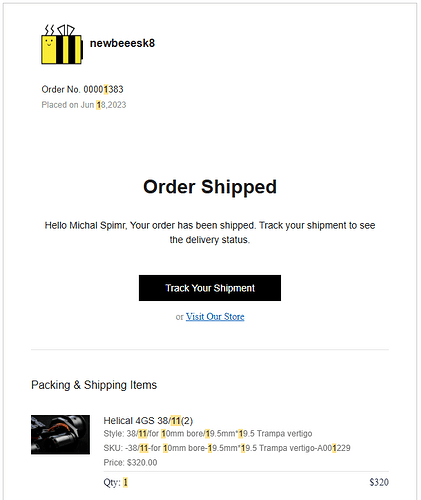

June 18, 2023 – The Dream Begins
Placed my first order: a Gear Drive (ratio 11/38) and Trampa Vertigo clamps.
As soon as the package arrived, I noticed something was off. The clamps were wrong. Completely different from what I ordered.

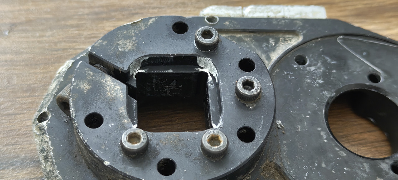

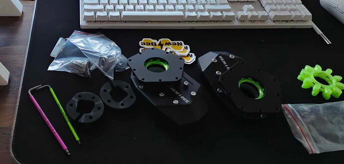

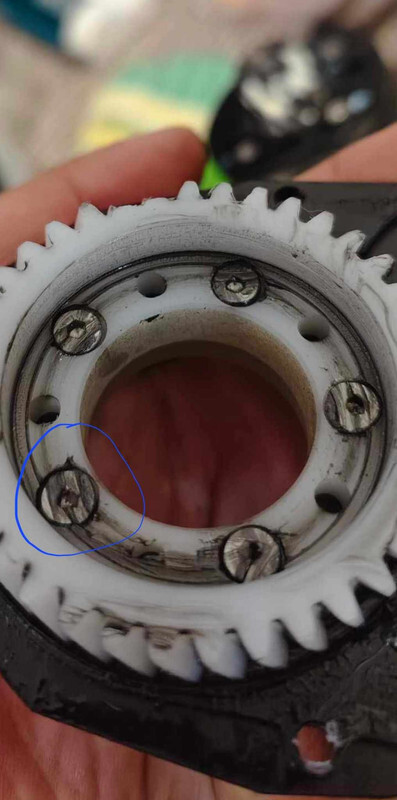

Then I noticed something odd during the install—some parts were already pre-assembled. The big gear was already bolted to the hub adapter. Cool, less work for me! I assembled everything, and it was awesome. Love at first ride.

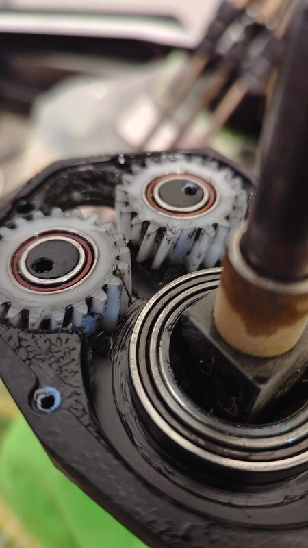

But… after just a few rides, something started grinding.
Took the gear drive apart and surprise! The pre-assembled parts had zero threadlock. Nada. All the screws had come loose and started rubbing against things. To top it off, a few teeth on the small plastic gears broke.

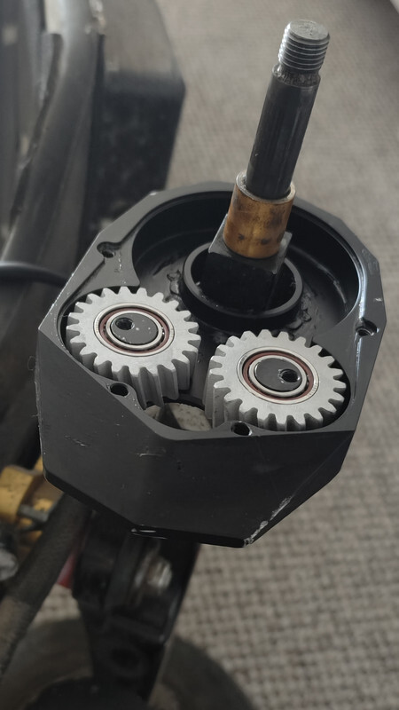

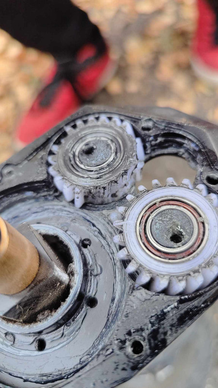

Three months later, the small plastic gears broke. Again.
Mind you, no jumping, just riding roads on a Flux Motion board.

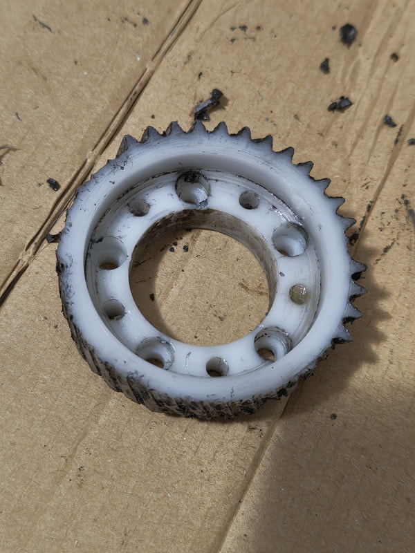

Tried printing the gears at home. Nope. Not precise enough.

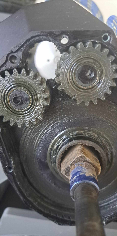

Asked a friend to do SLS printing—better quality. Worked… up to around 3000W, then they exploded again.

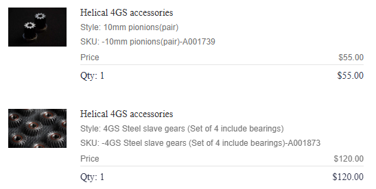

In November 2023, I discovered PCBWay does metal 3D printing. Bit pricey, but cheaper than buying a whole new gear drive. Worth a shot?
They arrived and looked fantastic. I had hope again!
Then This Happened…

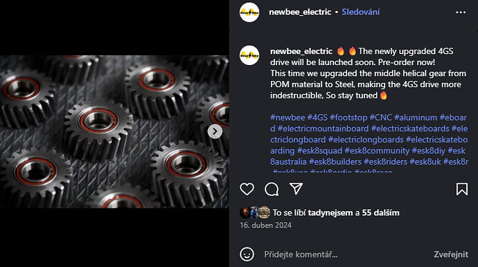

A few months later, NewBee announces:
They’re now selling metal gears.
Are you kidding me?!
Few months later, my 3D printed gears fall apart anyway, damaging the motor gears too.
Great. Now I’ve got nothing to ride. And no other gear drive fits my needs for hear ratio.

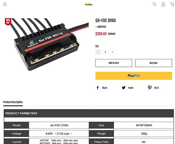

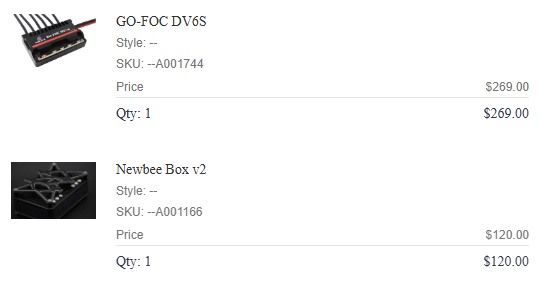

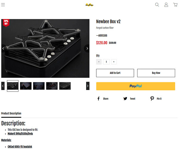

Looking for a MakerX GO-FOC DV6S ESC. Can’t get it in Europe. Shipping from the US costs half the ESC’s price. I need a heatsink too.
Hey—NewBee has it in stock!
Should I risk it?
Well, there’s no warranty on ESCs anyway, so… what could go wrong?

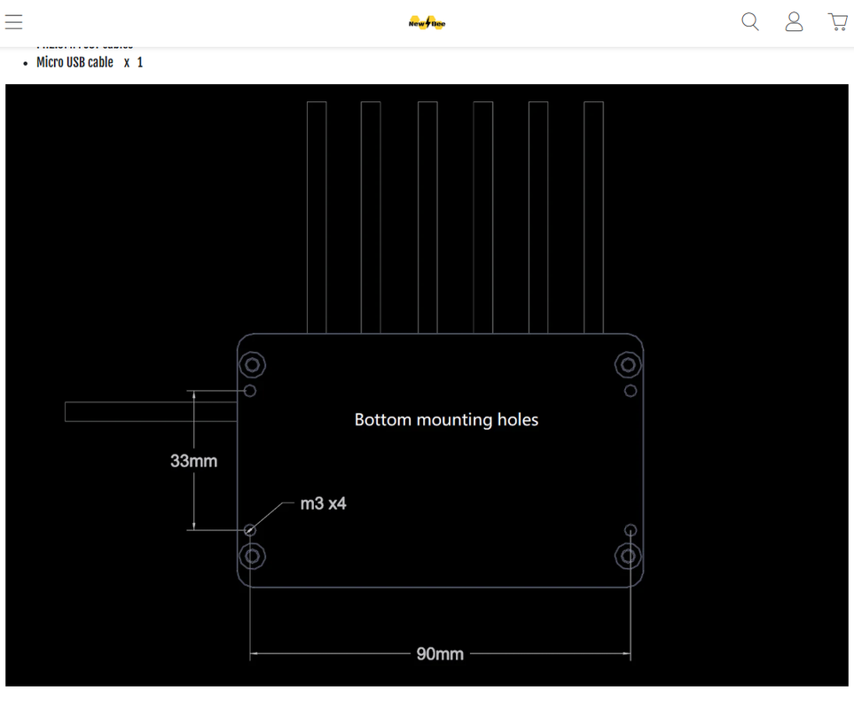

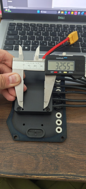

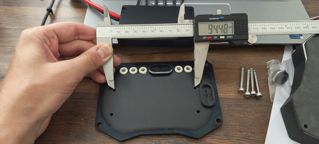

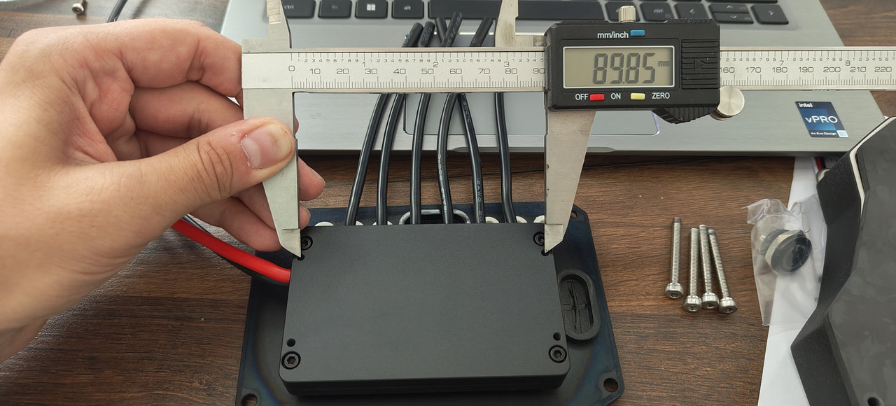

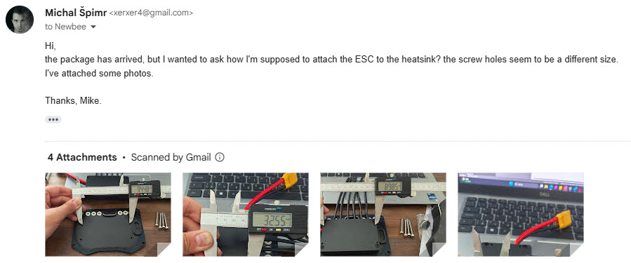

July 8, 2025 – TODAY – You Guessed It

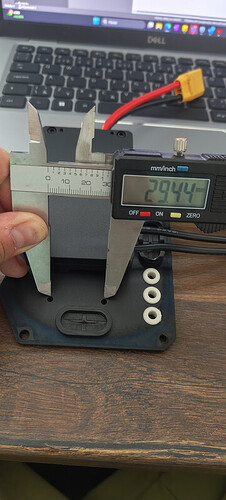

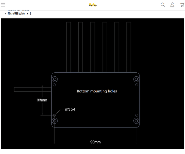

Package arrived. Nicely packed. I do a dry fit and… surprise!
The ESC doesn’t fit the heatsink. Screw holes are drilled in the wrong spots.
Everything was ordered according to their product page!
Wrote to NewBee.
Think they’ll reply? :slight_smile:

What type of metal and method of printing did PCBway use for your printed metal gears? I’ve been using SLM 316 stainless herringbone gears in one drive and SLM 704ph stainless in another without issue so far.
Honestly, I can’t find any order confirmation in my email, which is why I didn’t mention it in my original post—I just don’t remember. I think it was aluminum, and that’s where the problem started, but I don’t want to lie.
Anyway, how long have you been using 3D printed gears? I’d love to hear about a solution that actually works in such cases. After all, I still have a gear drive at home with all the parts—except for the large gears. :smiley:

That’s why I don’t like POM gears, you kinda have to baby them.
Found your problem.
If it’s not steel, it’s not worth having.
minor counter point. I ran a long time on the last iteration of Moon’s pom gears. on my proto. (i broke some and he modified them) I did not baby them.
mostly 3.666:1 gearing (44/12) on 150mm wheels.
Only for a couple months. I’ve got about 400 miles on the 316 gears in my Double Agent build, but they’re pretty rough miles. Inspected the gears last weekend and everything looks great. Made the gears mod 1.1 at a reduction of 5.
The better 17-4ph gears are installed in an Apex Jump Drive. Not a fan of this board though so they don’t have too many miles. Need a better ESC and better motors. Everything I’ve read says they’ll last longer than the 316 gears.
Been running for 5 years now and only broke 3 gears. 2 were from bad crashes, 1 was my fault. They just chew up when they break. I’ll keep using them.
Yep. As frustrating/expensive as broken plastic gears are, I’d prefer their failure mode than the failure mode of steel on steel :skull_and_crossbones:
Have you had a steel gear failure?
I’ve had a bolt lock up my steel gears, similar to what was described in the original post. Came from the manufacturer without loctite. It locked up for a second then was able to somehow chew through it. Luckily this was on dirt so that tire just slid. Even after that the steel teeth looked fine. Are steel teeth failures common? Used to break POM all the time but have never had a gear tooth issue since using steel.
