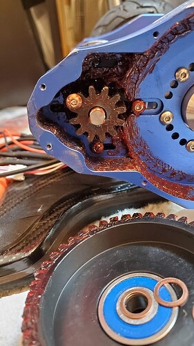

I had a hardened steel mod 1 pinion that lost half a teeth. Interestingly didn’t even notice it until I disassembled the drive for service probably much later. There were some weird sounds coming from the drive occasionally but kept running it being lazy to service it :sweat_smile:
Wasn’t jumping with it, but I was racing it. Pushing 200A into the poor reacher at 21S so it definitely took some abuse. Went to mod 1.5 since then.

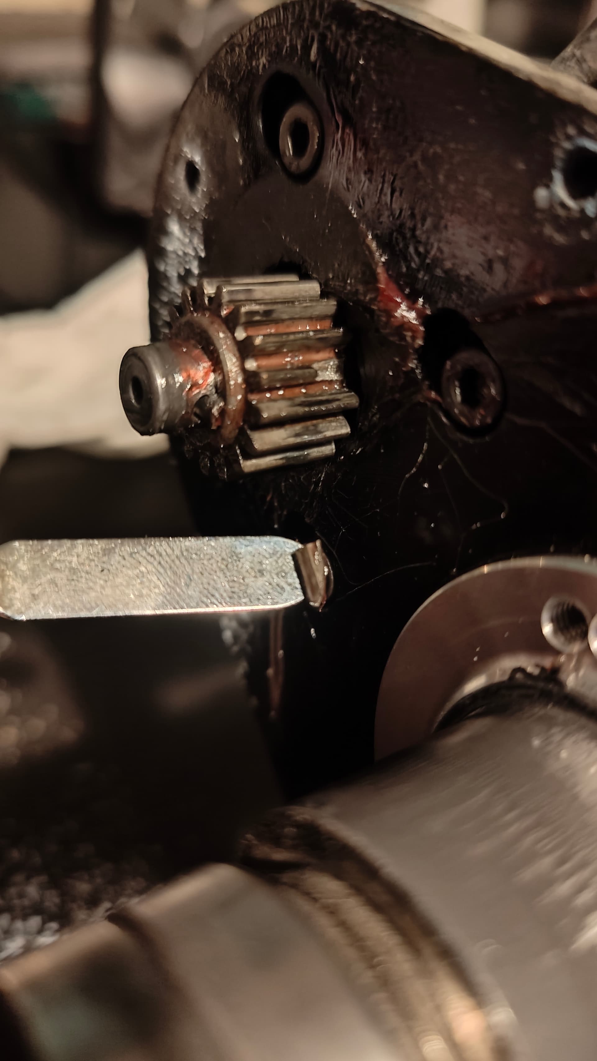

Not my story, just drug him out of the road. Don’t know if he’s been up for figuring it out yet. Just another anecdote but you were asking for anecdotes. Ive had pom/steel hybrid break and the steel just eats up the pom and free spins… more anecdotes.
Once when i was full throttle and hit an un marked un filled street cut for construction - sucked but just had to limp home on one drive. Second time was a wreck so not applicable but failed similarly
What was the root cause? Broken gear teeth? Which piece of the machine malfunctioned first and in what manner, for each occurance?
Hivis steel gear failure: Don’t know, but the motor was locked solid, the gears wouldn’t move, tire was locked solid. If there was a weak link to break MAYBE it could have been a better outcome. Maybe it COULD have failed in a less catastrophic way. But even knowing the exact failure mode wouldn’t change the situation much - as there wasn’t any give in the system. Any of the components gets locked up and the entire drive train comes to a halt.
Not a reliable data point but there just aren’t any good data points in total. My FEELING is that i want my drives to be a point of failure that is not so unreliable as to break all the time in normal use but also not so strong as to make any failure catastrophic because the failure is going to cause the wheel to lock up. Belts just slip too much on the hills i ride. I want the gears so even though they can be run without attention for thousands of miles - i break them down and check on em and about every 6-800 miles. Been working so far ¯_(ツ)_/¯
