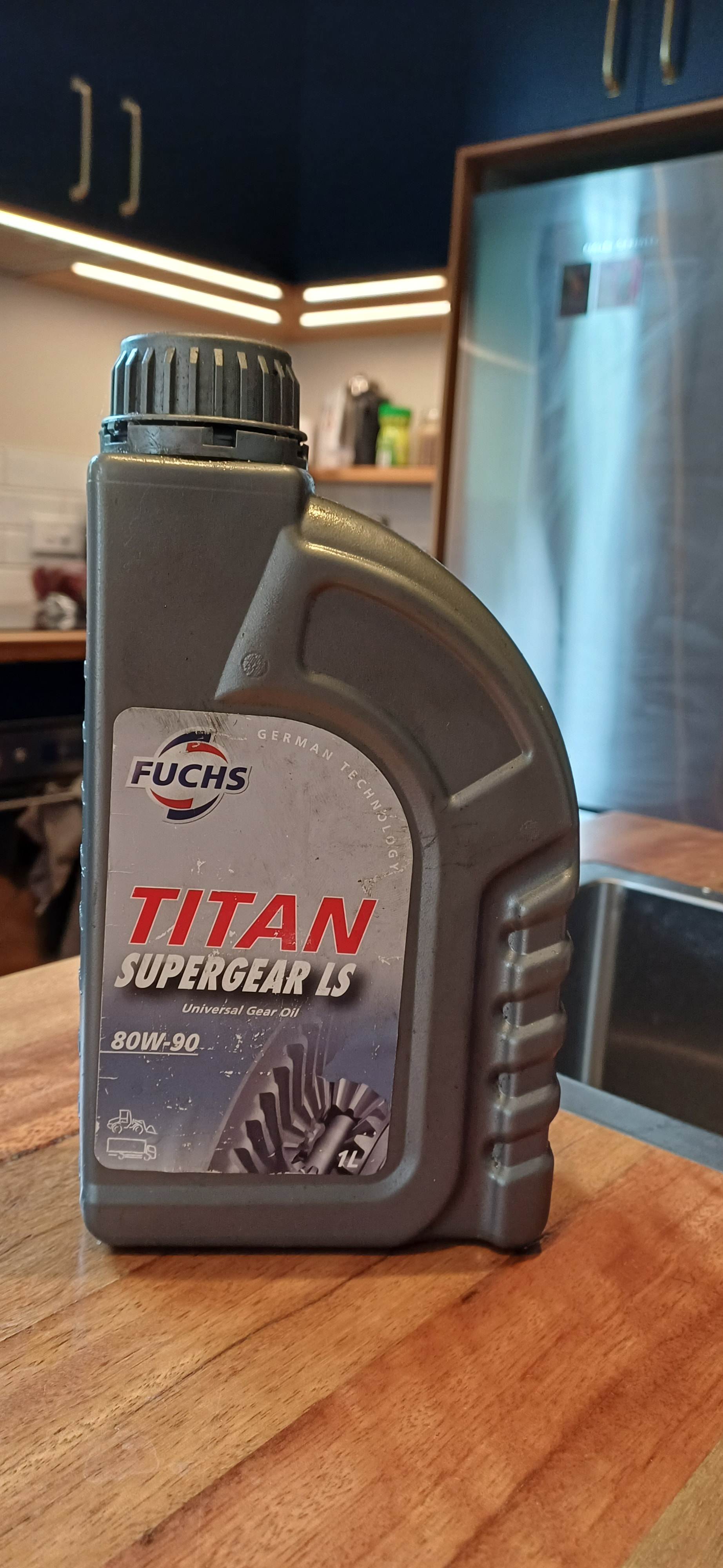

I’ve found that when I’ve used diff oil in my bearings it’s clung to the metal and prevented corrosion from wet riding far more than when I’ve used grease.
I always pour quite a few extra drops of diff oil down the shaft when reassembling a motor.
Fun fact.
Gear oil viscosity is measured differently than engine oil viscosity.
Viscosity Comparison Examples
SAE 80W gear oil =~ SAE 10W-30/40 engine oil.
SAE 90 gear oil =~ SAE 50 engine oil.

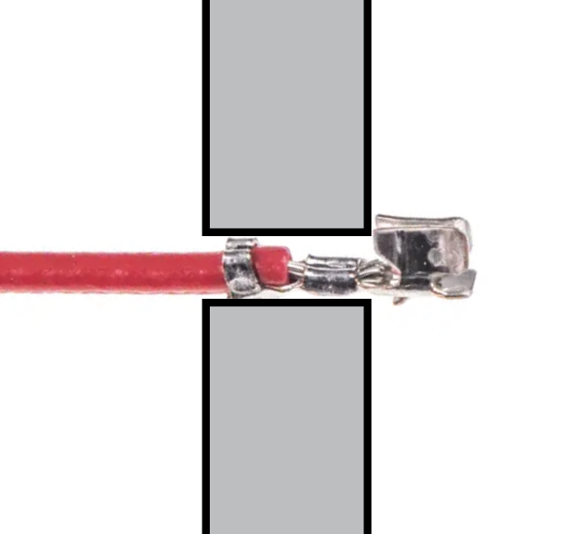

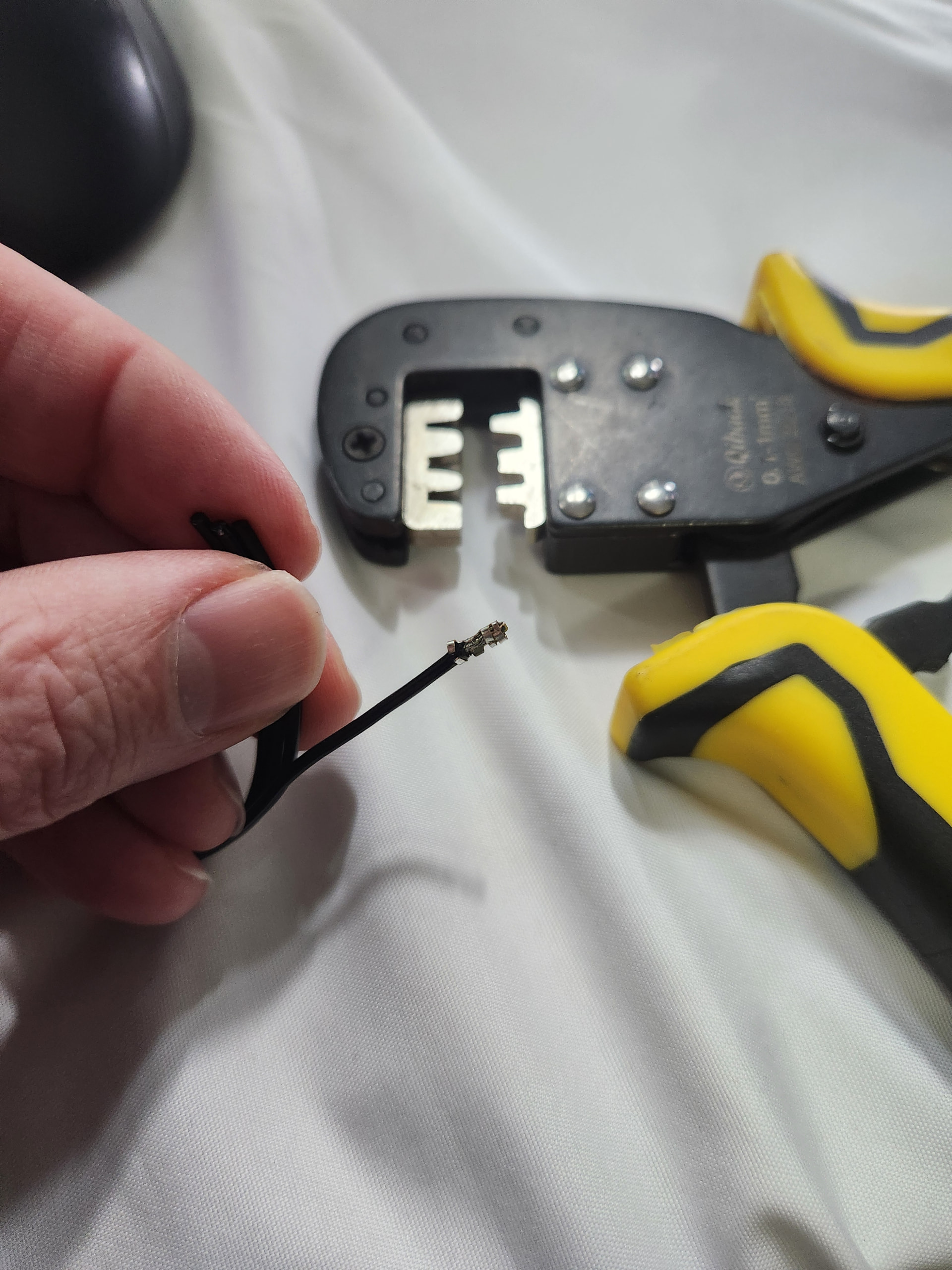

I need a legit guide on crimping jst connectors. I have the tool but i keep destorying the small connector cage. :expressionless_face:
Lining up the metal piece in the tool before you insert the wire into it is crucial.
Sometimes it lines up but the tool doesnt seem to have a specific region where it feels right
Do you have a photo of that connector before it’s crushed? Which JST series is that?
On the tool I use (which I imagine is similar to others?) I have to put the end of the connector sticking out the side of the crimper so it doesn’t get crushed, and only the parts that grab the wire are inside the tool. Shitty drawing but like this
Ok i see that much better now. Thanks.
@b264 took me awhile to figure out its a “z” type
Crimping jst is my least favorite thing in diy to do. And the thing I finding myself doing the most. Practice makes perfect…
