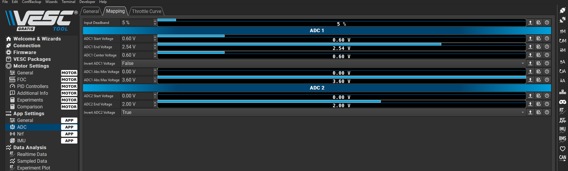

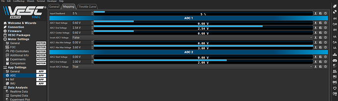

Do you have a multimeter and a link to your throttle or a manual for it? The first thing I’d check is the resistance as you turn the throttle. If it’s something like this: Domino Potentiometer Throttle , you should get a smooth change in resistance from 0 to 5k ohms as you turn the throttle. That would at least let you know if the throttle is operating normally. It sounds like, most likely, you just need to map the throttle. There should be a mapping tab under ADC like this:

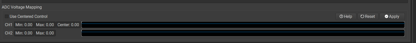

Oh also, at the bottom there should be this:
You can use that to see what the signal is from the throttle live and have those values applied once you’ve run through the full range of throttle.
I’d like to add that you will probably need to click the RT APP button on the right side if no values are showing in that field.

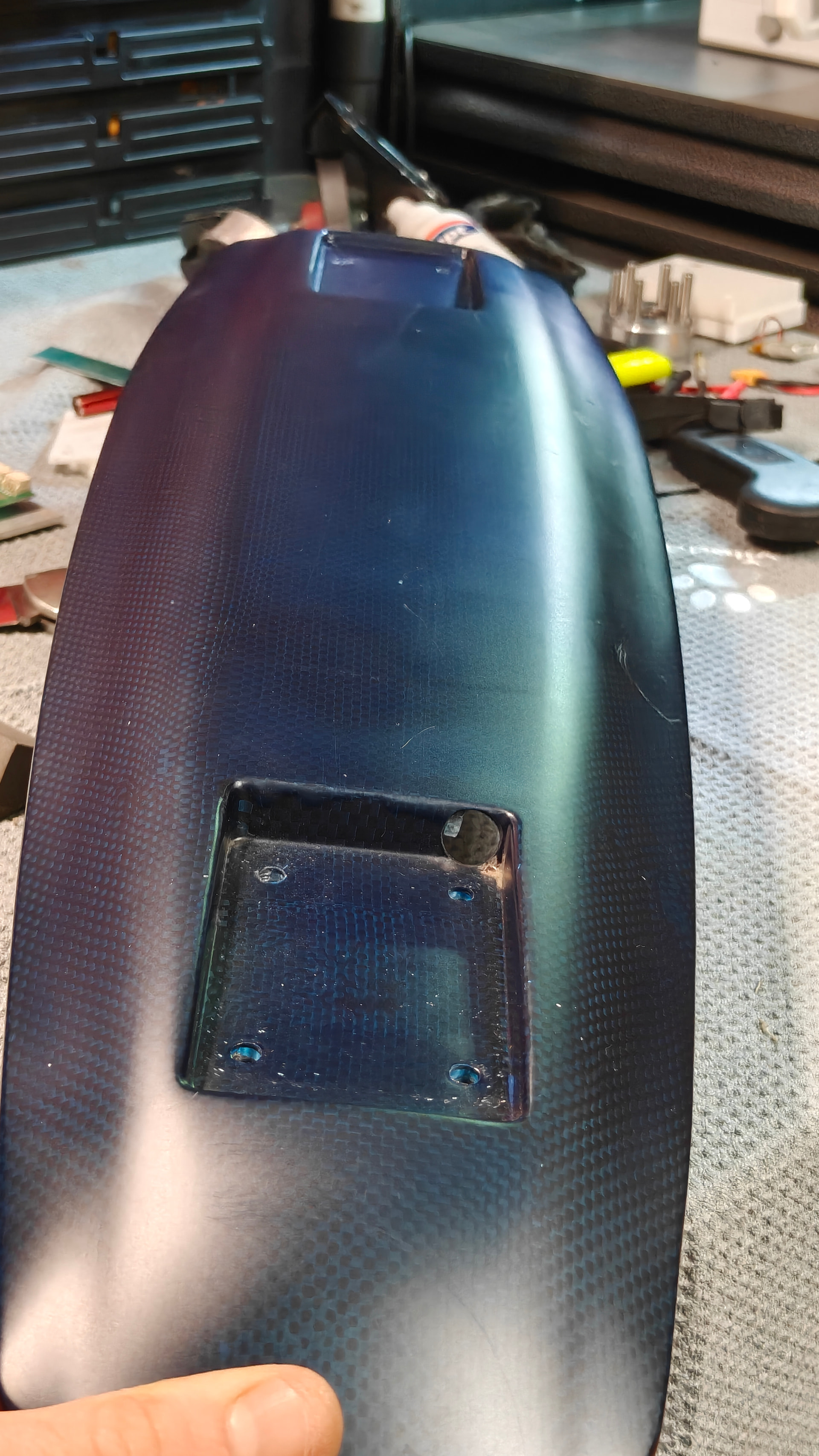

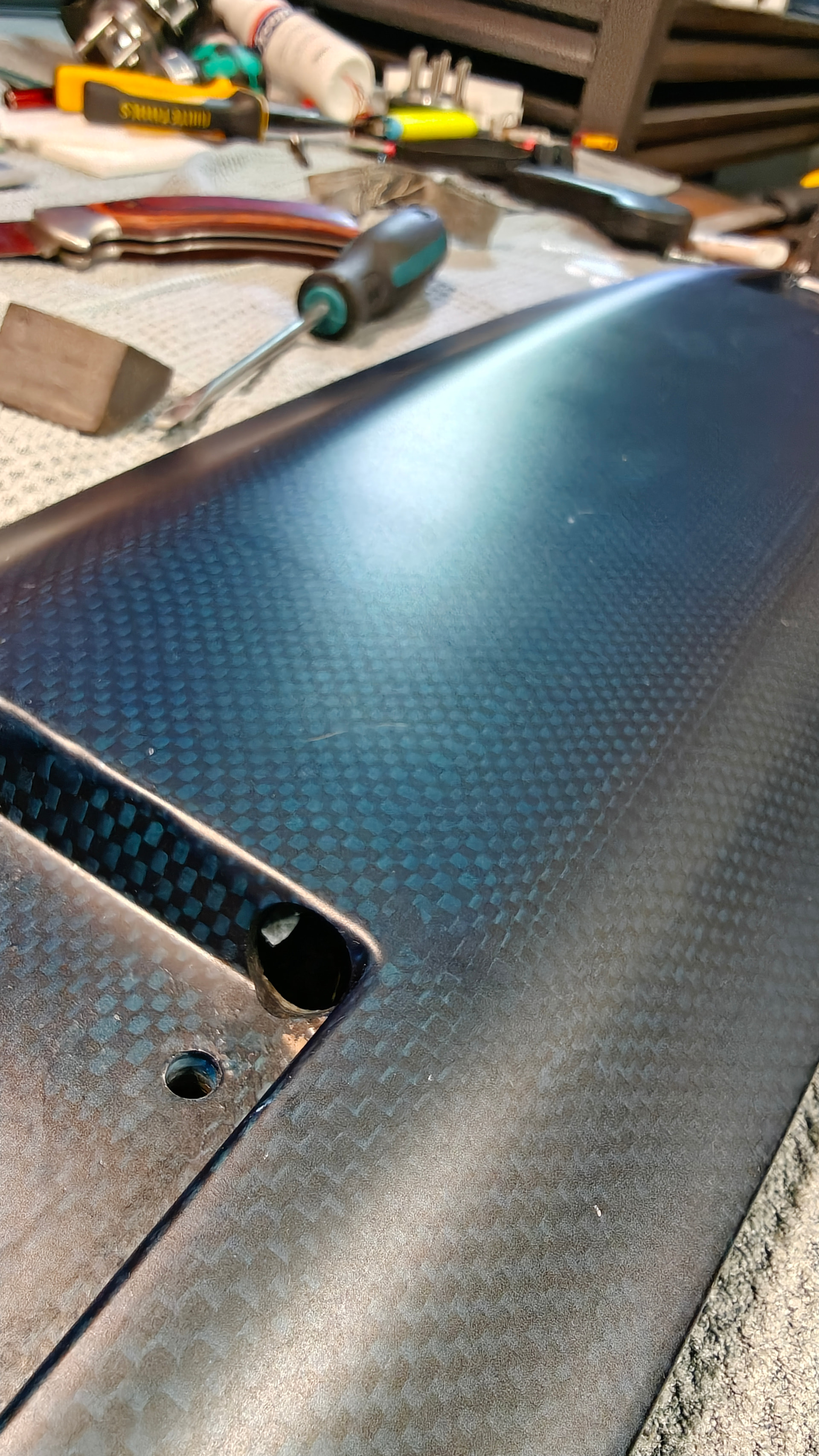

What would be the way to bring out more colour out of this and give better protection?
Test a spot by getting it wet, if it looks better wet a clear coat would help make it shine through better.
What an interesting way to check, it does look better once wet, any recommendations for the cover coat?
  1. Sand it with 1200 grit, wet.
  2. Buy a box of piss.
  3. Go to a paint and panel shop
  4. Find a worker with a beard, lunch time could be the best opportunity. Ask if he’ll spray it with the the next job for you.
Eh its a skateboard
  1. scuff it up with scotchbrite
  2. Buy a cheap rattle can clearcoat
  3. Spray it a couple of times
  4. Build it, skate it, scratch it, get it dirty

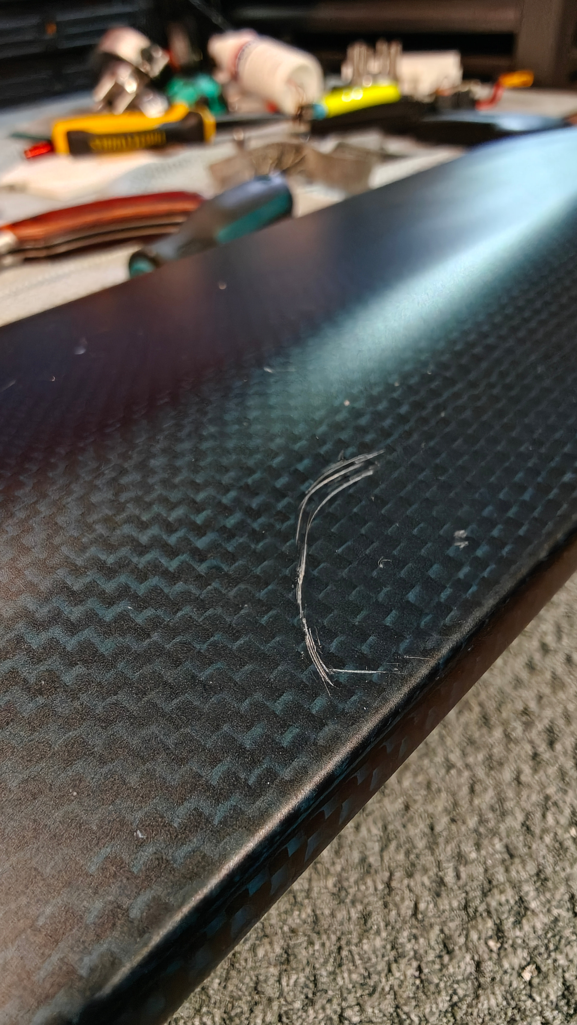

I where a chance it’s not actually carbon, but maybe like a skin? How could I test? Where is one part of the board, slightly unfinished and the “carbon” is out a tiny bit, seems like plastic, not carbon.
It looks like real carbon to me, based on how the pattern of the weave changes right before the recesses for the baseplates, and the hardware holes look to have a 2mm thickness of it just above the blue core material.
I’d just take a gloved finger and some superglue to that scratch, if I bothered to do anything at all.
I second the rattle can method, id take some 400 or 600 grit to it wet to scuff it well and clean the surface - give it an iso wipe - mask off what you don’t want overspray on - then wipe it again - then wipe it again - then spray it. Personally i have had best luck positioning it so drips will only appear in masked spots and doing the first coat light - second one heavy enough to self level. Then let it dry in a warm area after the worst of the vapors flash off.
I also have fewer lint and bugs landing on it if i make a cardboard cover with tape and hot glue to prevent anything falling on it until it has firmed up a bit - the cardboard can make dust itself but a couple light sprays with whatever partial cans i have sitting around locks it down pretty well to limit that
Honestly just a little cleaning and a quick spray or two to shine up the existing clear coat without getting too complicated will look great. Will likely hide that scratch well too. Then when it gets new scratches hit it again.
