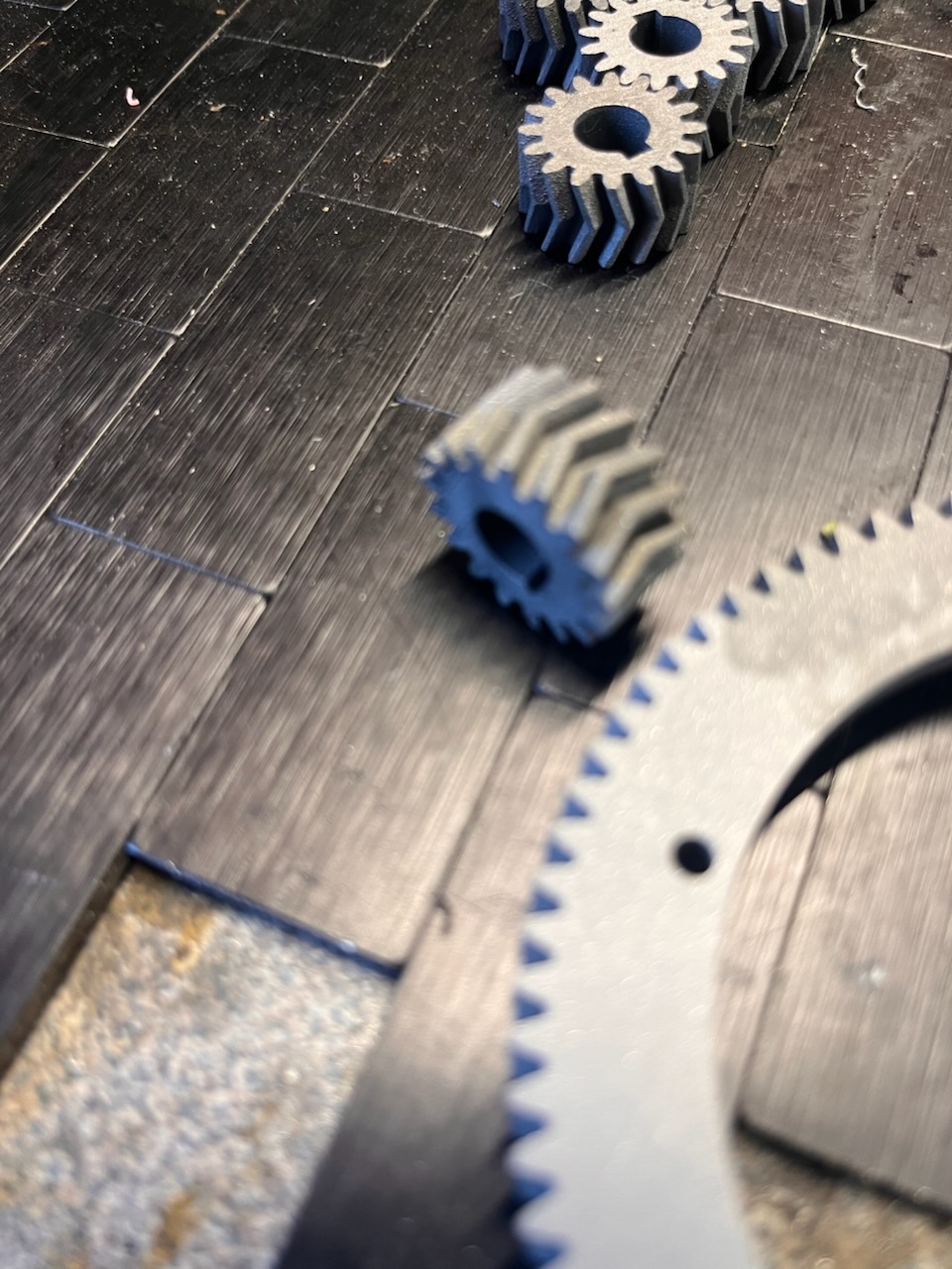

Isn’t the surface of the slm gears rough? Do you have to cnc the gear after it is printed? Can you print herringbone gears?@SirVesa
It’s a little rough but not bad at all. They aren’t post processed at all. Herringbone is possible as well.
Before they leave the factory they go through an aging process which is effectively hardening (500c for 6h if i remember it correctly). It’s different from the surface hardening that we do to chromoly gears, and technically surface hardening is more suited for gears, but whether it actually matters in practice still remains to be seen. What does matter is that they are hardened so wear life should be good. Will let Jake to chime in with more details

Yeah it’s a little rough out of the box. You could probably use lapping compound to clean it up but after an early grease change they look fine. These haven’t been used yet. Herringbones are the only gears I’ve actually tried. Definitely still in testing phase but they’ve been great so far.
I’m very interested to test SLM Mod 2 pinion gears. The ones I got from Ebay didn’t last at all. And I’m also curious if harder gears sounds louder. :thinking:
