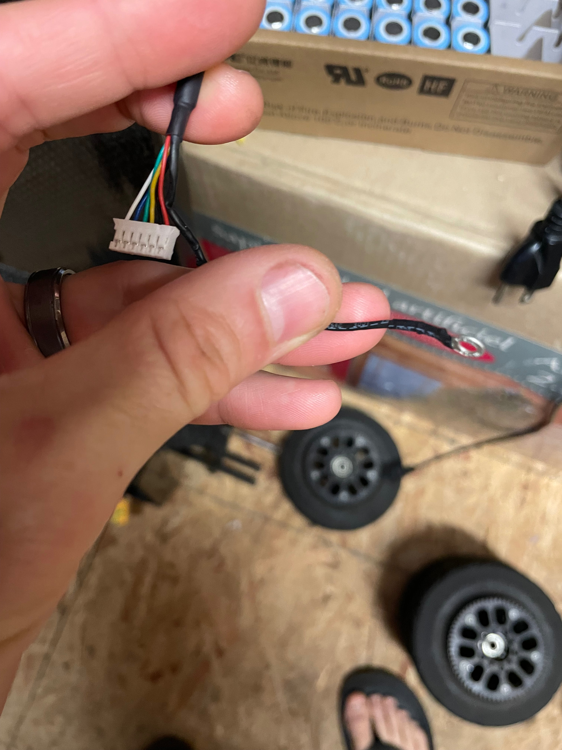

The new 6495 motors have this 7th wire. What does it do, and where does it terminate?

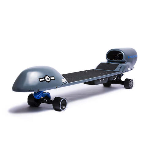

Lol what the hell is this? April Fools maybe? XD
I assume the cables screened. If so, I’d connect them to my heat sink / esc casing. Is this what others would do? I don’t know.
I remember seeing that a few years ago already… Don’t remember seeing a single one of those in the wild though. I would guess it’s april fools, but since it’s not the first time I’m seeing it, idk
Supposedly they’re for static charge or something while riding. @Tony_Stark had a post about it somewhwere. Most of us just cover it with Tesa/electrical tape and tuck it away.

I had a feeling it had something to do with static charge. Got it tucked away currently…
It’s real, red beard rode it at the damn. Just a marketing stunt though more or less I would imagine.
They should have removed the hub motors from their Jet board, if they wanted true believers.
