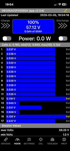

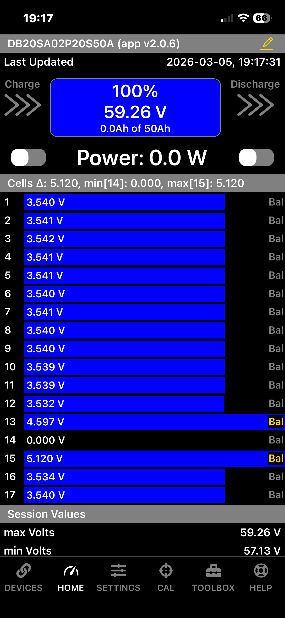

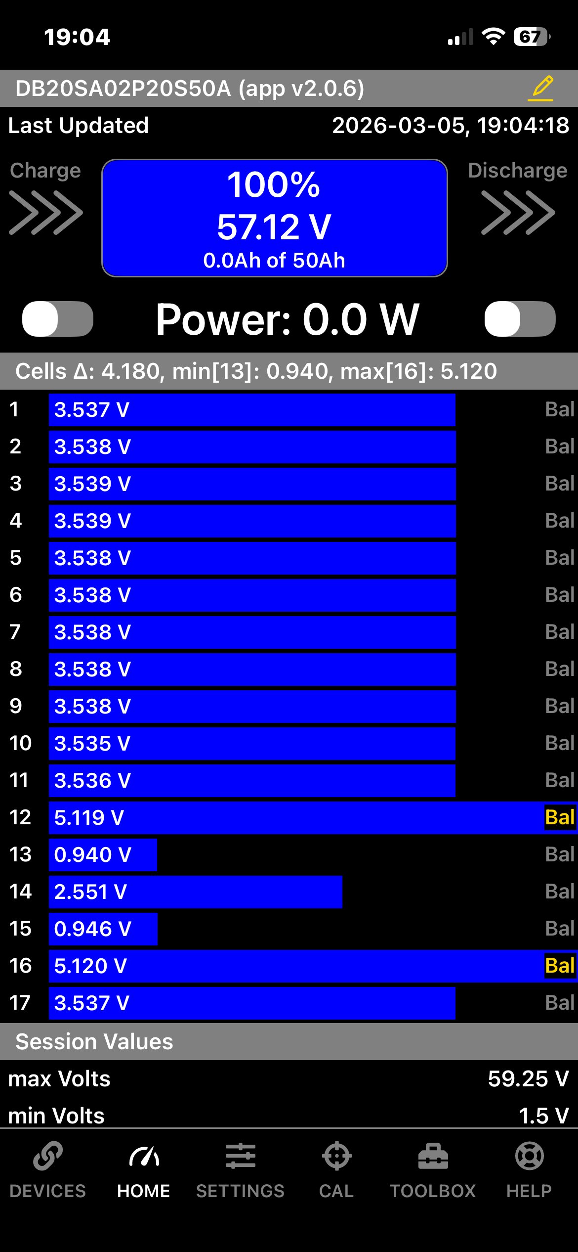

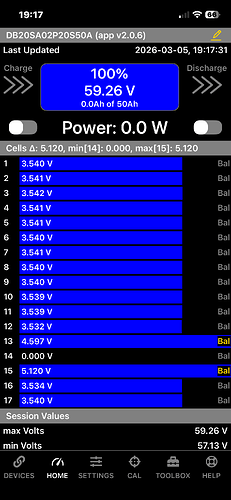

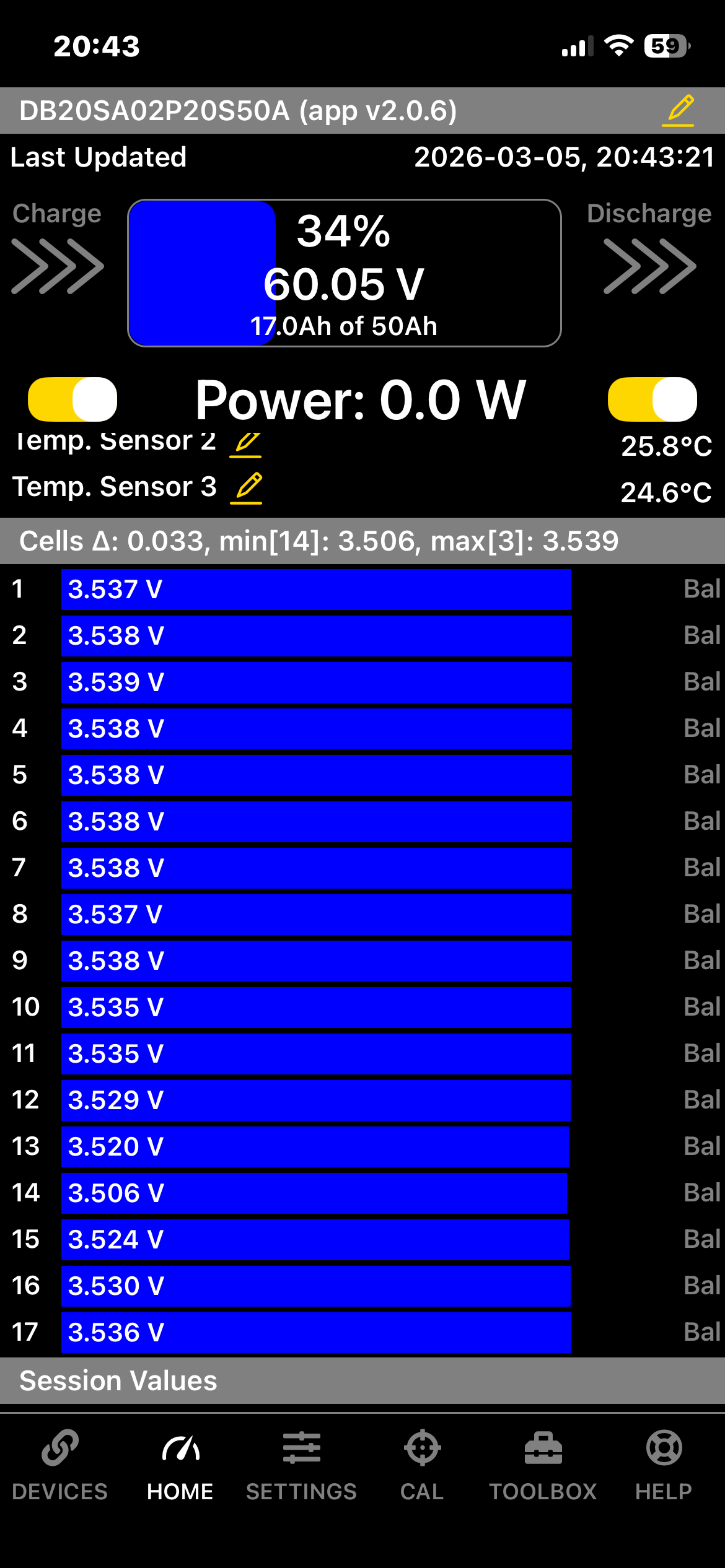

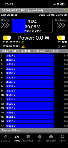

This new pack changing about 20 minutes between these 2 pics
It looks very much like your balance wires are incorrectly installed
Perfect thank you
