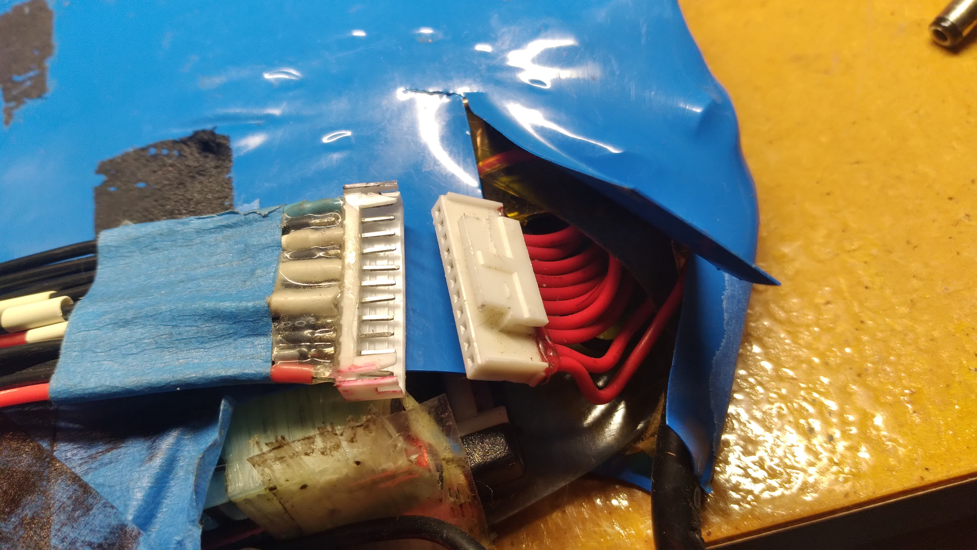

I have not used a hobby balance charger before.
Well i tried once on a gifted one, and after downloading manual and scrolling and beeping and scrolling and cursing for several minutes I got so irritated i nearly busted out the sledgehammer.
On my 10s battery balance wire adapter, in order to plug it into the 7s ‘capacity controller’ I used a 7 wire 2.54 jst plug for the first 6 p groups, and a 5 wire jst 2.54 for the final 4.
Group 6+ is group 7 - so i doubled the wires on that connector pin so the main negative on the 5 wire connector is the same electrically as the last red wire on the 7 wire.
I don’t know how your double 6s lipo balance charger will behave when the 6th group + is group 7- so perhaps just do 6 at a time to be safe.

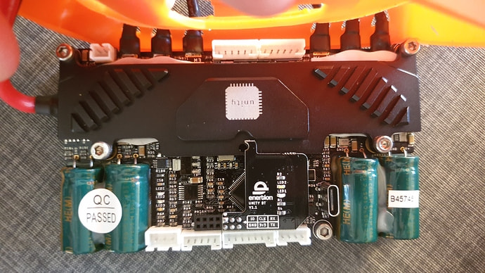

Does anyone have the swd port pinout for focbox unity? I can’t seem to find it
I did not find such a setting in vesc(
Where in so-cal you located? Ray has a shop in La Jolla, CA that services boards. La Jolla Ebike and Skate.
I think you have to remove the plastic cover
Ah I see it now. I did remove the cover previously, didn’t think to search on the bluetooth module though :sweat_smile:
Thanks!

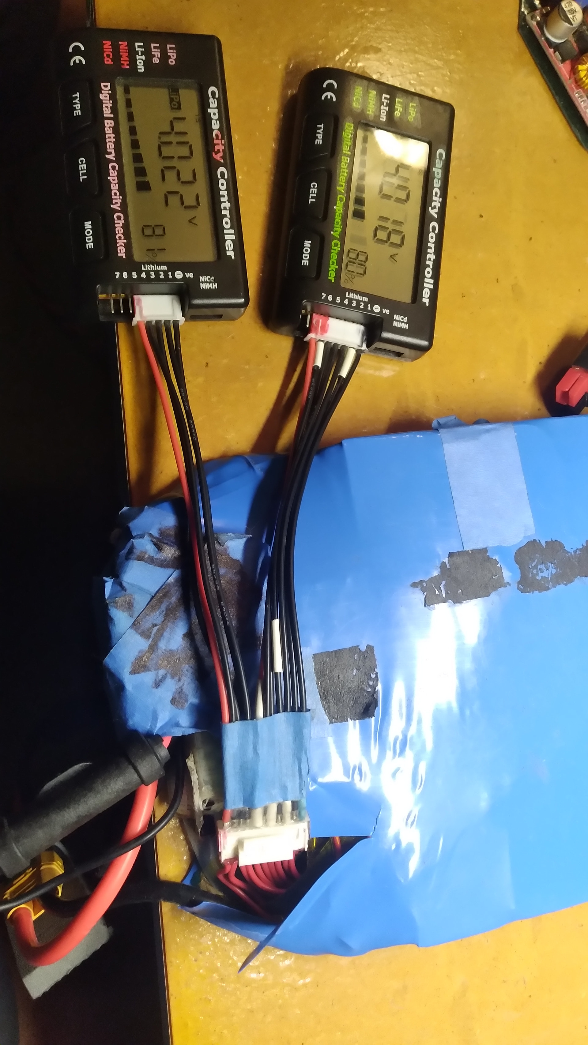

This is what i will try. Two 5s sets with the main negative pigtailed off. Thanks i’ll let u know if i succeed.

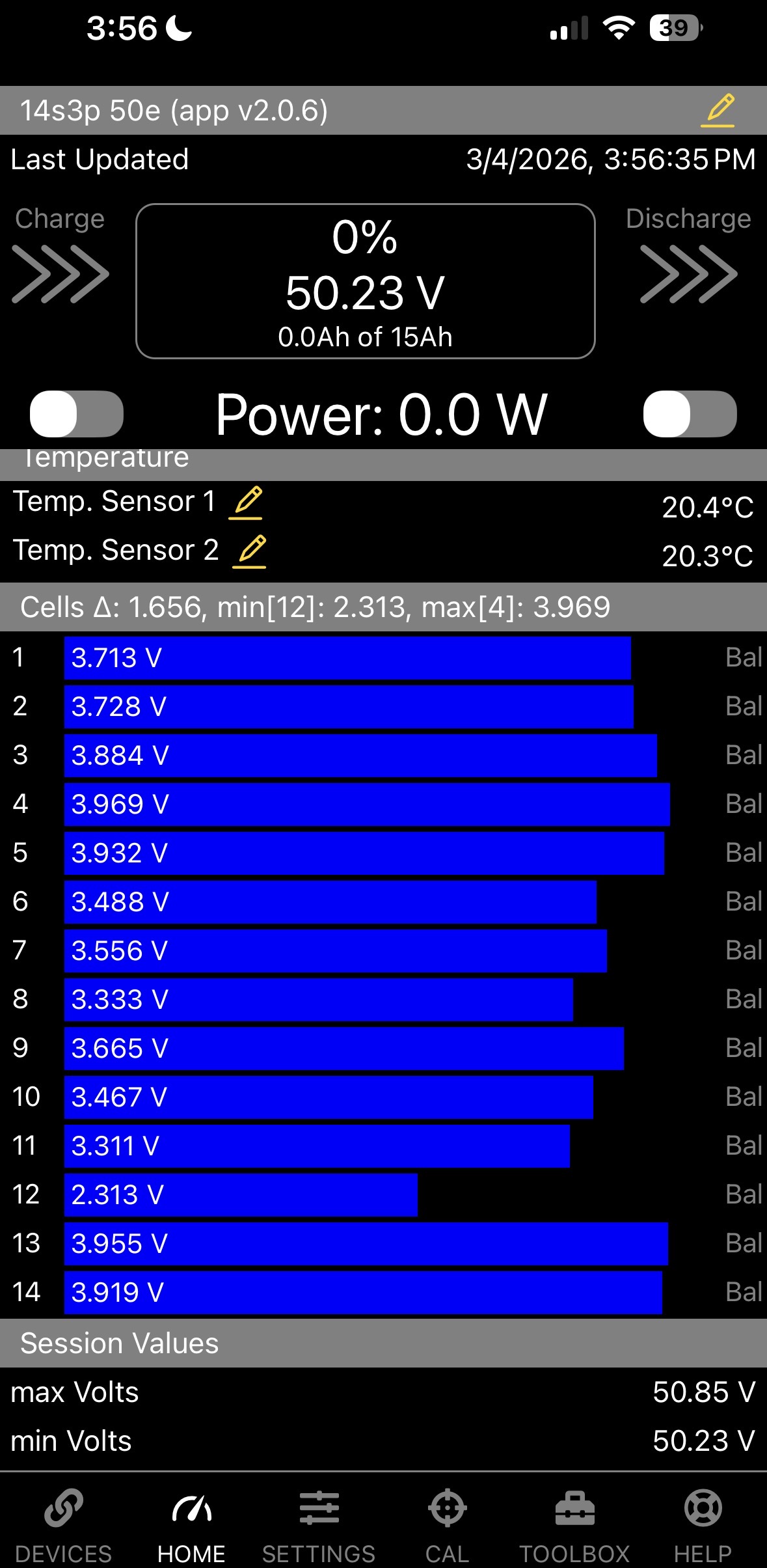

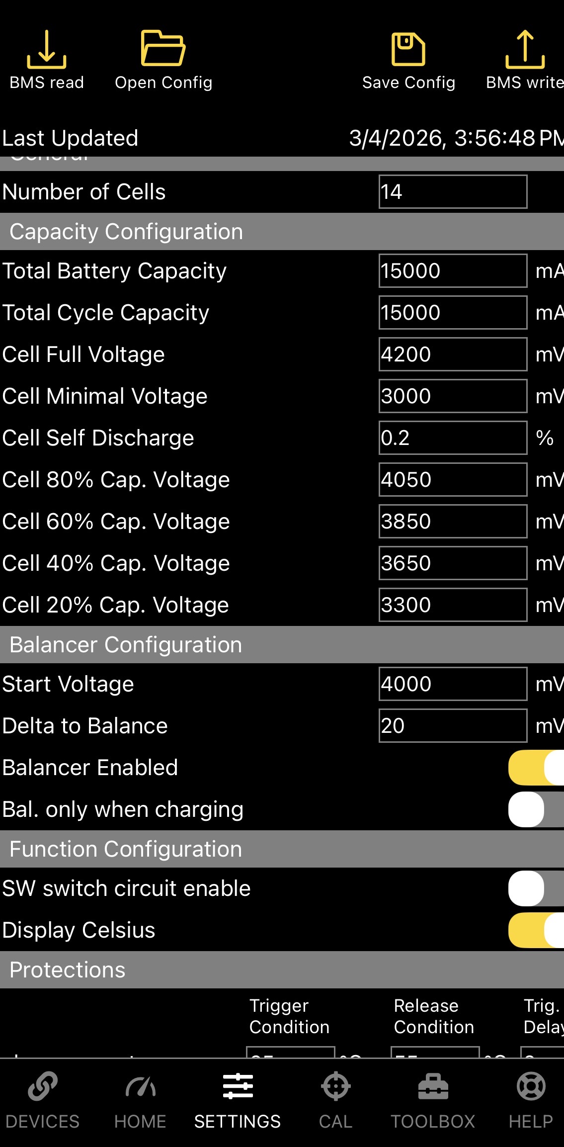

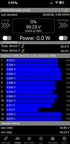

This is after about a week of doing what they said, so the cells could balance. Looks like it just made it worse… how can I dispose of this, or would anybody want it for the cost of shipping :joy:
