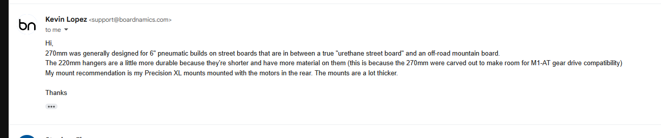

Those were even wider if I remember right… I think 280mm. Pretty strange to have caliber style trucks not intended for thane wheel use
Ah, found it. Looks like it was for the AT version.

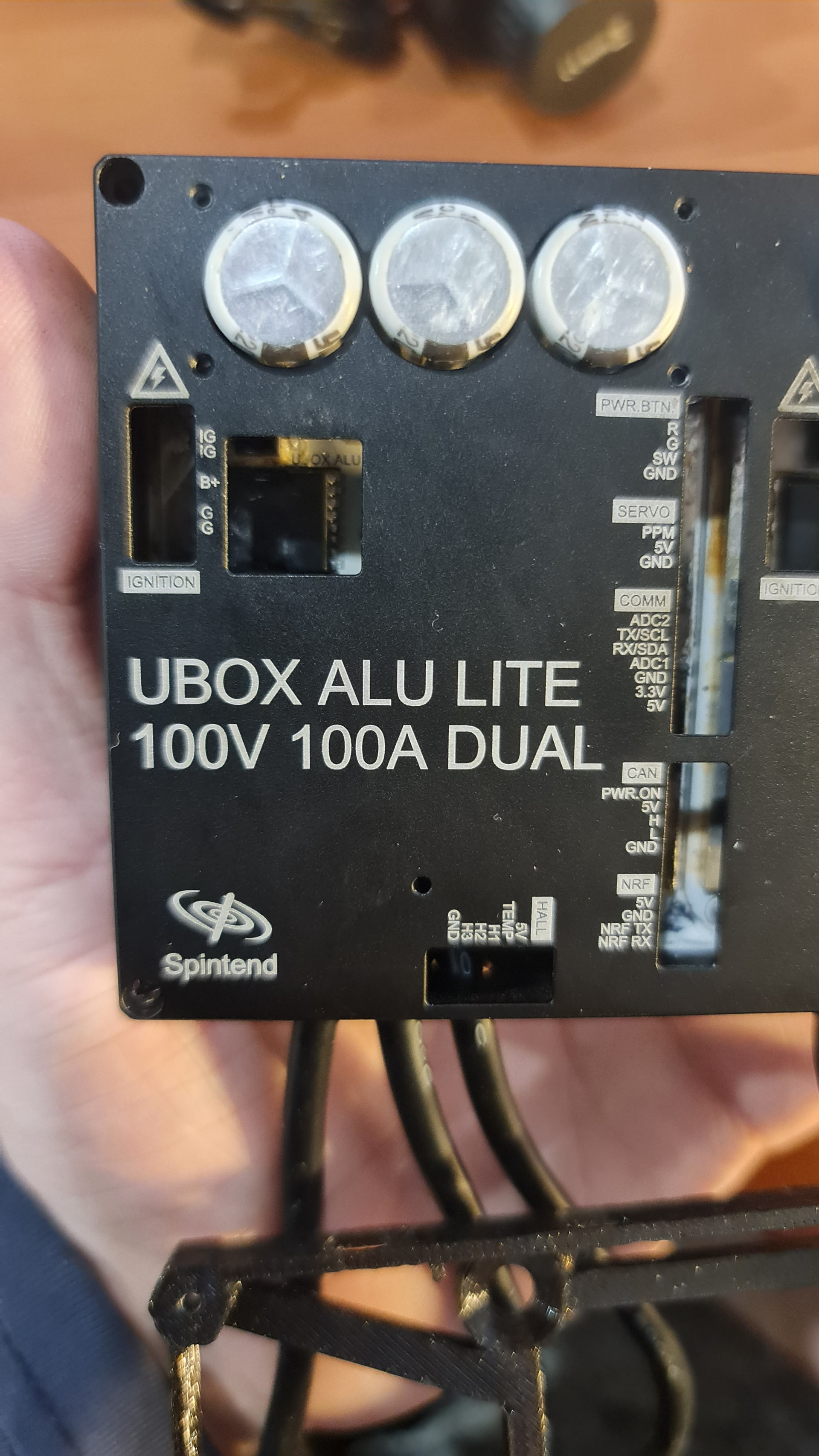

Hello everyone! Does anyone know how to turn on VESC by using the motor roll? I use spintend 100.100 lite

If your vesc supports this function, you just push the esk8 fast and it powers on
