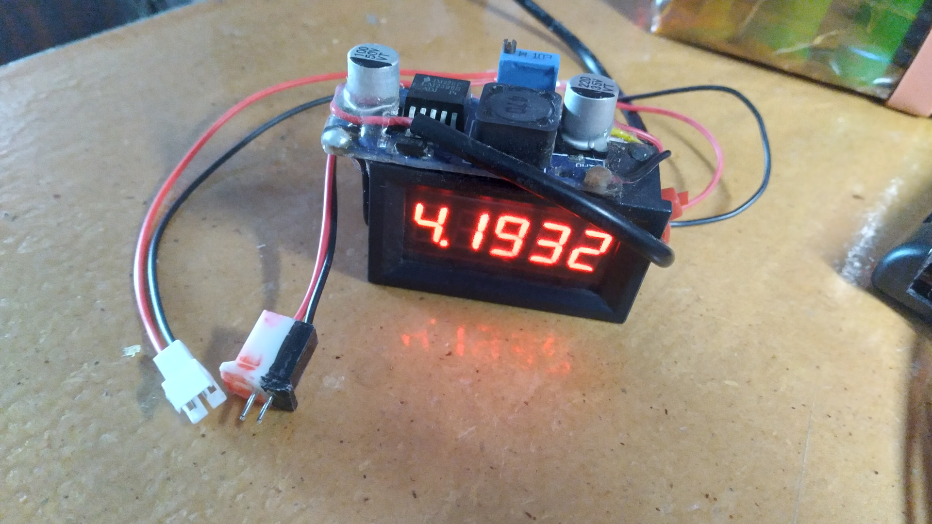

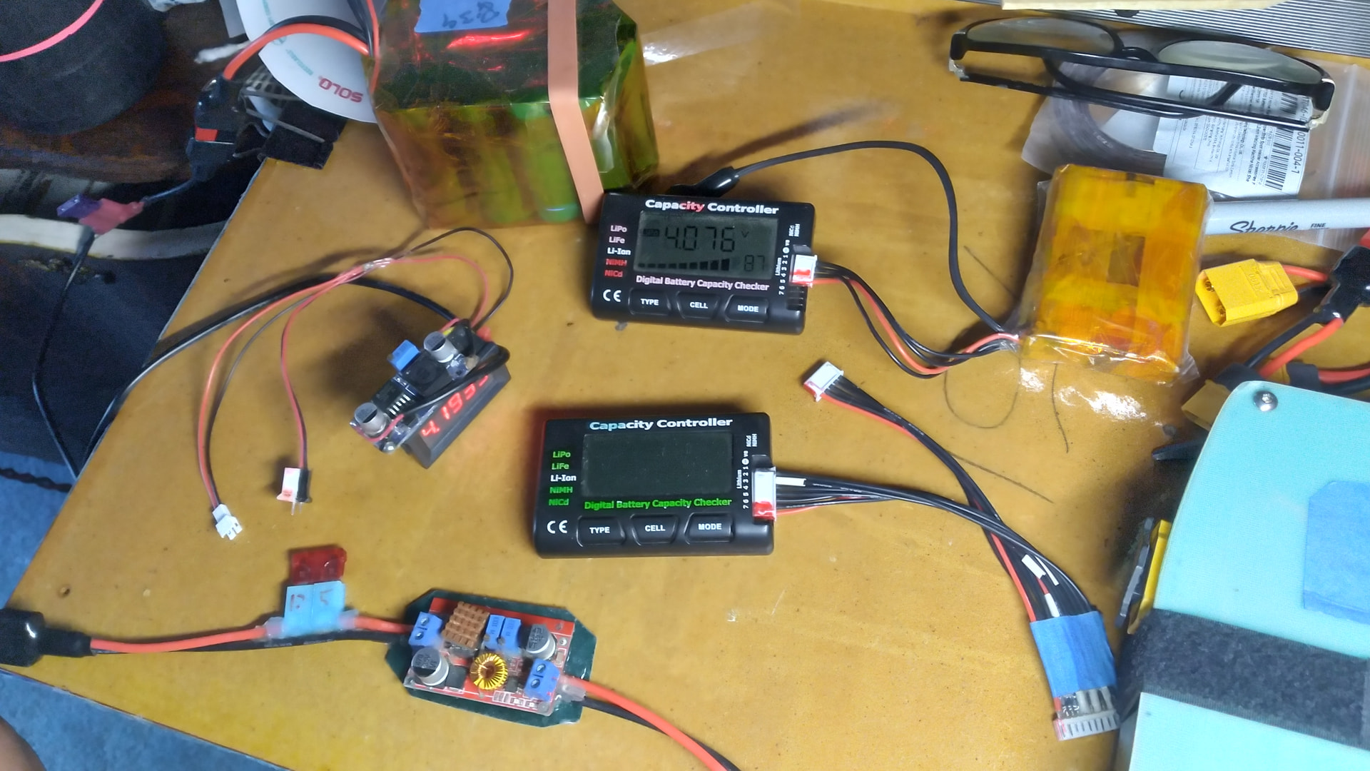

This is my manual balancing device..
It is a LM2596 based voltage bucker / step down converter, attached to a 4 decimal voltmeter.
I use a 3s battery to feed the converter 11.1-12.6v and output 4.1932v, in this instance.
I have two outputs from the LM2596 bucker, one is a JST PH with 2.54mm between the pins, and a JST- Xh with has 2.0mm spacing.
Most BMS balancing plugs are 2.0mm spacing.
I will insert the JST connector’s 2 pins into the corresponding balance connector receptacles of low P group(s)
This is a pretty slow process as there is not much pressure difference between say 4.12 and 4.19v, and the closer that 4.12 P group gets to 4.19v, the less voltage difference so less amperage flows.
I have a clampmeter which can only read as low as 0.05 amps, and it will usually read more than this initially when I first start manually balancing, but then later, after a period of time, it will read 0.00 when, there is still amperage flowing.
When it reads 0.0 amps, I will then remove the connector from balance plug and check the low P group’s voltage. If it is still too low, return the connector, or keep it off and move to another potential low P group.
I Aim for no more than 0.030 volts difference between P groups, but I don’t get bent out of shape if it is 0.035 volts / 35mV
If I am impatient, I will raise the step down converter’s output voltage as high as 4.25v for more voltage Delta and thus more amperage flow, but if not pulling it off in time, that low P group might then become the highest P group.
So there is some vigilance required in this manual balancing process when ‘injecting’ 4.20v into a low Pgroup.
Set a timer on your phone rather than thinking you will remember.
If I had to rebuild this manual balancing device. I would use a XL4015 based voltage bucker/ step down converter onto this same 4 decimal voltmeter.
There are versions of this bucker, usually with a red PCB, that have both a voltage adjustment potentiometer AND a current limiting potentiometer.
This 5 amp red XL4015 based bucker/ step down converter( shown in Pic below with a copper heatsink on top of the XL4015 chip) would be beneficial when one P group is very low and can then accept more than 3 amps from the 3 amp limited LM2596 bucker.
Do NOT try and adjust output voltage with the JST connector hooked to the low P group. Adjust it to the desired output when unloaded, unhooked to any battery, then hook it to the proper 2 receptacles of the balance connector.
Do pay careful attention to polarity, and an inline fuse on output is a wise precaution.
If probing the balance connector for voltage with a digital multimeter, be extra super careful so the probes cannot touch each other.
I have 2 ‘capacity controllers’ which display individual P group voltages for upto a 7S battery for a connector with the larger 2.54mm spacing. This is safer than trying to probe the balance connector.
I made a 2.0 to 2.54mm adapter to easily plug my 10s battery’s bms balance connector into 2 of these displays.
There is a more expensive 8 cell blue version of these displays which claim to have passive balancing ability.
I cannot confirm that ability.
Everything battery has the potential to go all sparky melty and smoky and worse, if not respected.

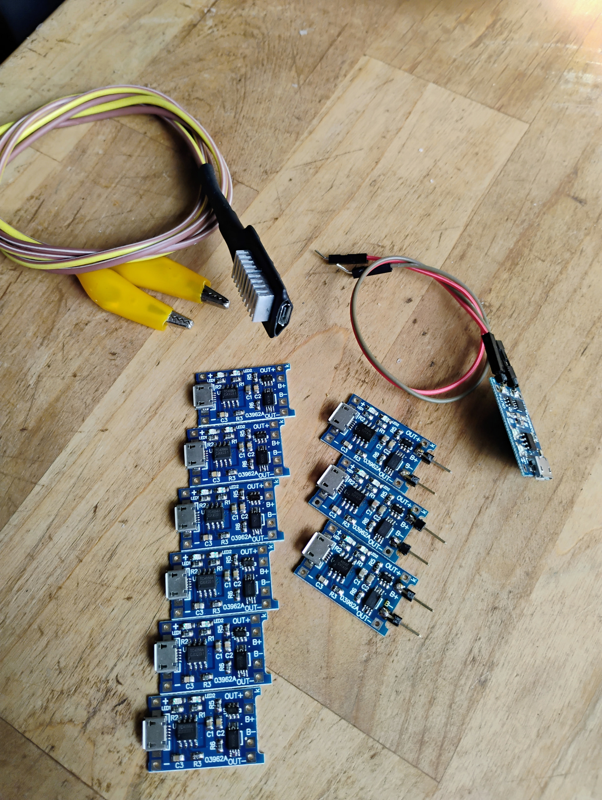

Lately I have been using the little dirt cheap TP4056 lithium charging modules, like ~$1 apiece in quantity, they seem to regulate to 4.2v fairly well, altho I usually just keep an eye on the nominal voltage I am trying to balance to.
Depending on the battery, I either use the alligator clips directly on the P-group tabs, or plug jumper wires into the balance harness.
You could even solder pins to the module at the right spacing, and plug directly into the balance harness.
I put a couple heatsinks on the alligator clip one, just to help dissipate some of the heat trapped by the heatshrink tubing.

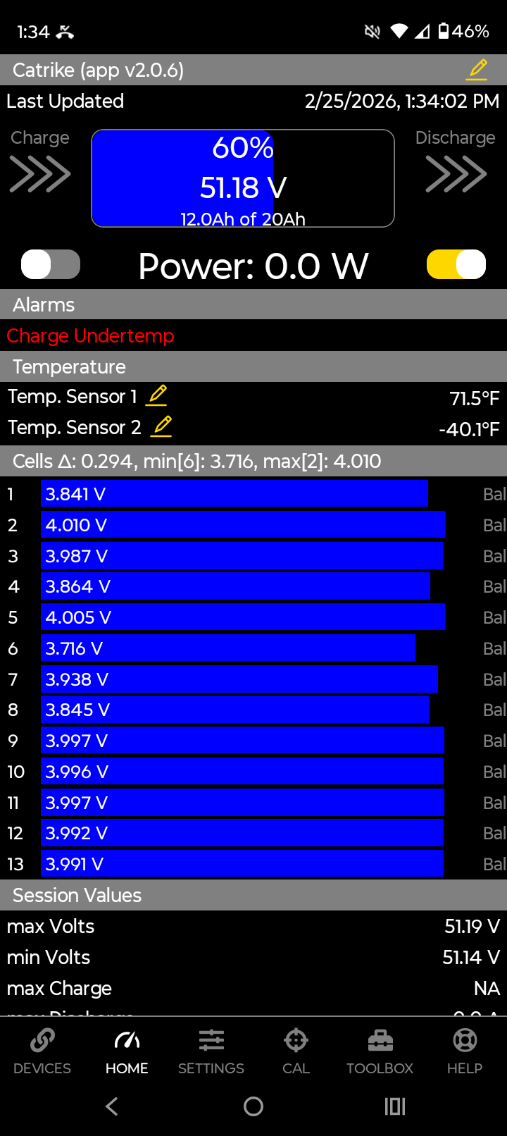

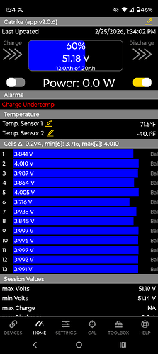

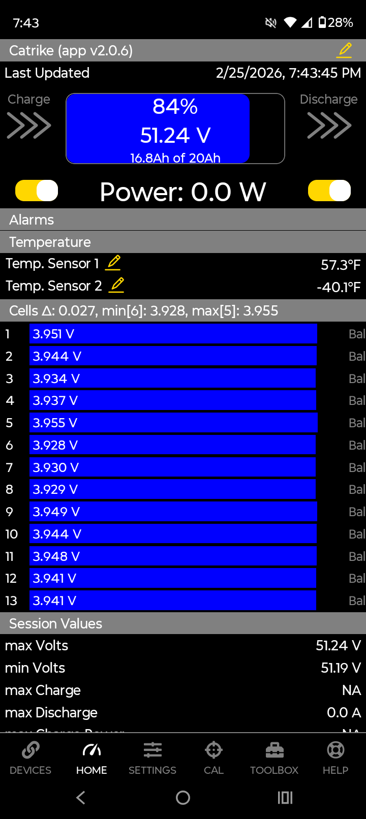

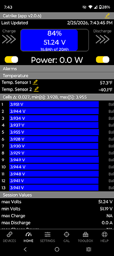

Here is a before and after pic of a 13s4p ~300wh battery I balanced manually over the course of about 3 hrs:
After:

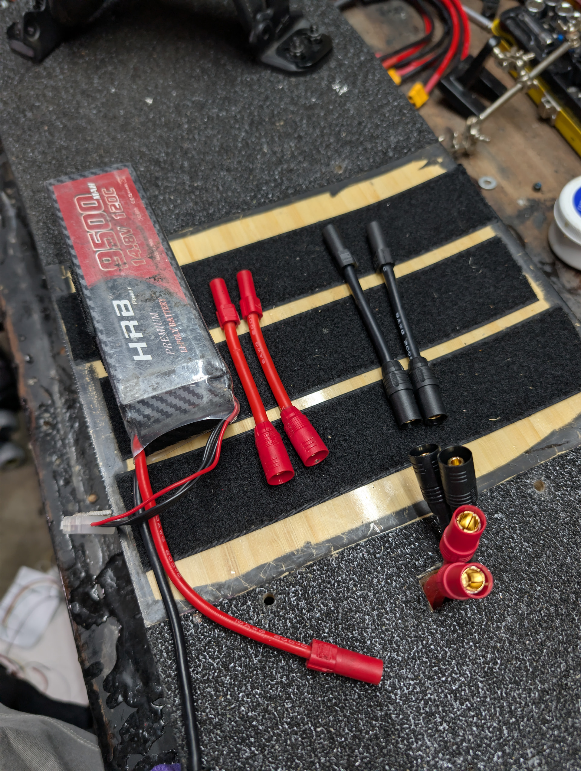

sanity check.. 4wd over can. Hotswapping lipos with as150’s. As long as -ve is connected first all good or am I missing something.
Hotswapping, as-in you are swapping the batteries while you’re riding? ?
Between races.
Hot swapping generally means replacing, adding, or removing a component or device while the system is powered on and running / fully operational.
They’re still hot when you swap them
