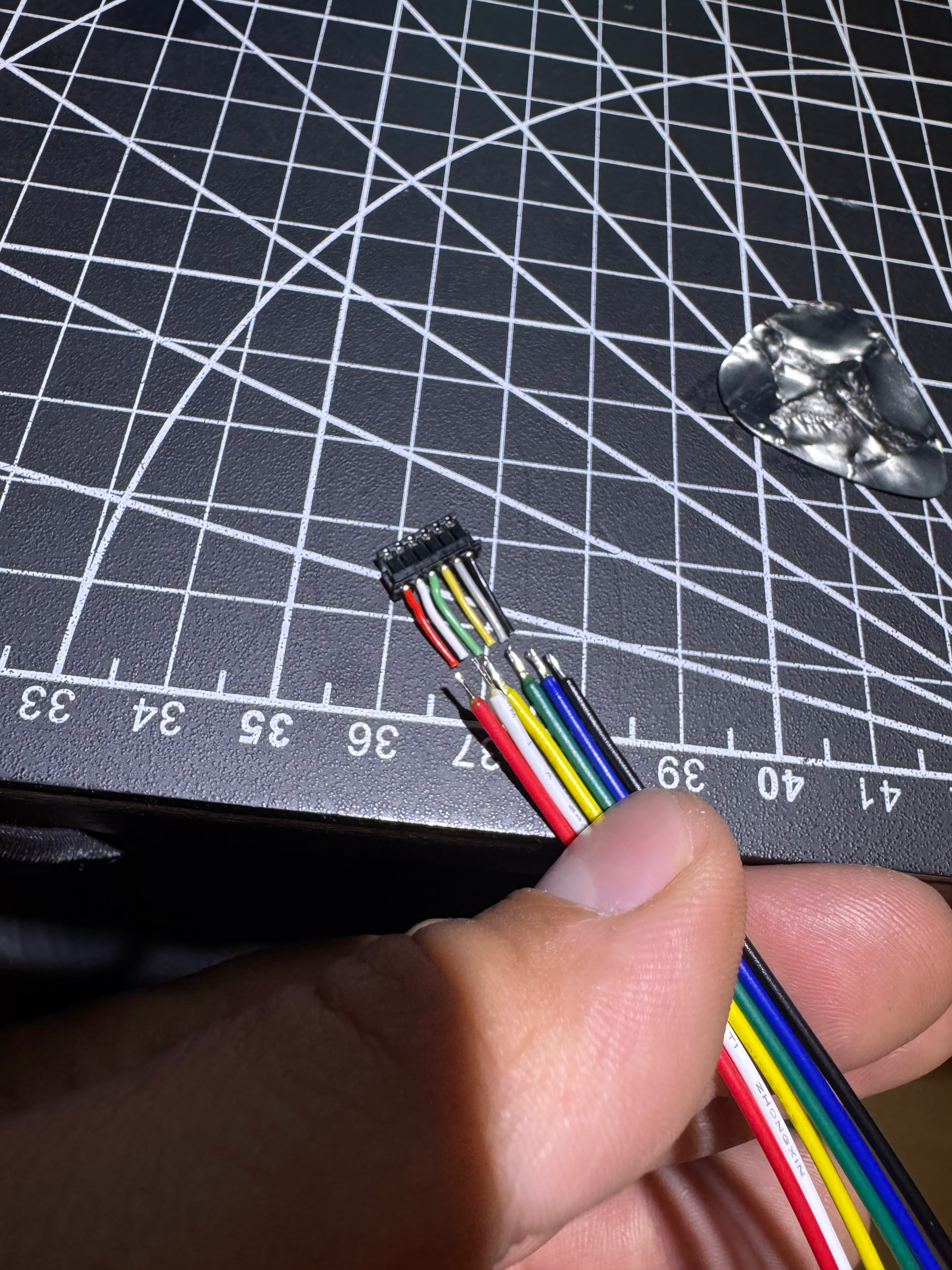

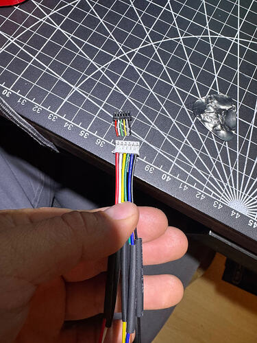

Splicing hall sensor wires for my g300s → hobbywing 70125s
Is the splicing the exact same as it would be as shown?
I haven’t found the pinout that I was hoping existed on hobbywings website

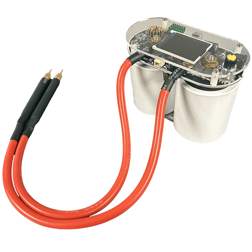

I’m want to make a few battery welds, is there in 2026 a cheap spot welder that is worth buying ?
Are the AliExpress 30-60 bucks one actually usable today ? Or are they just a gimmick that will make me cry first time I’ll try using them ?
There are solid reports of the one BatteryHookup sells.
