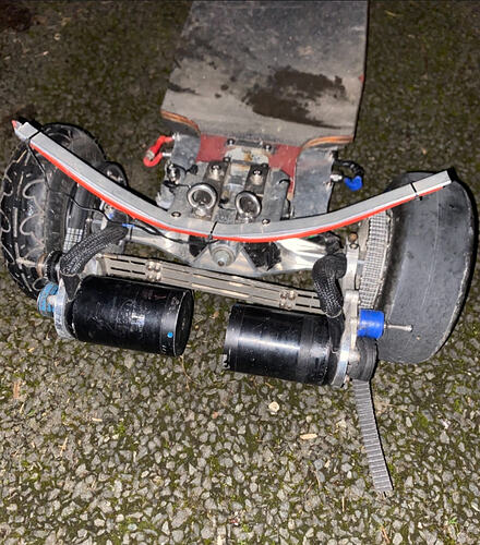

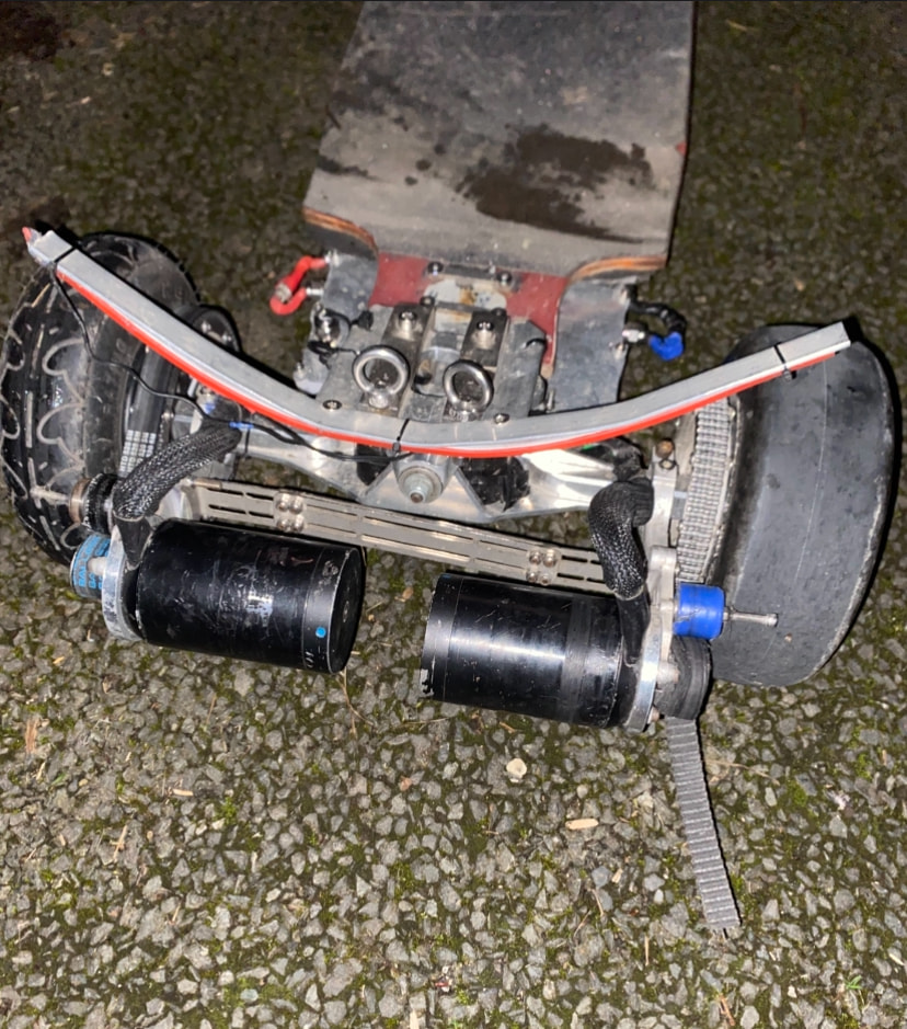

Does anyone know if it’s safe to unplug all the phase wires from one side of a vesc for efficiency or a broken belt?
I thought I could set current on that side to 0A or 1A but the vesc wouldn’t allow it. I don’t think allowing high rpm and overriding duty cycle limits would have been good for 63100s @ 11k rpm.
When I was miles from home with a broken belt I came up with
wrapping the whole belt around the pulley so it jammed into the idler and wedging the end into the motor mount brace for extra strength.

I’d be afraid to unless I had a way to cover them. I’ve not done it, but I think you’ll be fine if they don’t touch anything. If they short I’m pretty sure that will almost 100% instantly blow the ESC. Someone on here can probably tell you an easy setting to just disable one side, but I’m not sure off hand.
Just take the belt off. The motor spinning won’t hurt anything and it uses very little power without a load on it. The sound will be disorientating and annoying but it works just fine. You’re likely to get some torquesteer with just one motor on wide hangers.
This is fine if you’re not in high voltage, free spinning at high voltage is scawy.
Scary sounds but you just have to ignore the noises.
I tried that but when one motor spun very fast the other stopped trying. My first guess was I accidentally turned on traction control but it was off, so it must be duty cycle current limits affecting both from just one hitting high rpm. 170kv 16s is a bit high, probably fine for reachers but these get hot and shaky at full 11k rpm.
Should I have re-ran motor detection and set it to something other than esk8 that does cap duty cycle?
I have the receiving side of the bullet connector on the vesc so they won’t short to anything but I would be worried about the vesc trying to put current with nothing there.
For me it works fine, do you have the no limits firmware?
When i don’t want one side to work, i also set to zero the watts limit
Are you sure you didn’t just let off the throttle because it sounded top speed? You have to push it more, the other one will go. Ignore the motor at full speed, it’s using hardly any power and just making annoying sounds. It’s disorientating.
That’s another way to do it. I have the spintend no limits firmware but I think that relates to maximum limits not minimum. I checked minimum motor current and it was 0.25A.
Yes I am sure. I couldn’t even get it to go without me on it. It’s not something that we need to figure out though, I think the power limit will probably work.
Yeah freespinning did not work for me either. My method was canbus.
With ubox you can either use the remote if you have the spinted or uni, or power button method (click it 7 times). Orange light confirms internal canbus is disconnected. Then redo motor detection for the motor you want. There might be another way in vesc tool also i think turning pairing off works for other vesc types.
Unfortunately I don’t think my Ubox has that feature, it has a physical switch for canbus instead.
