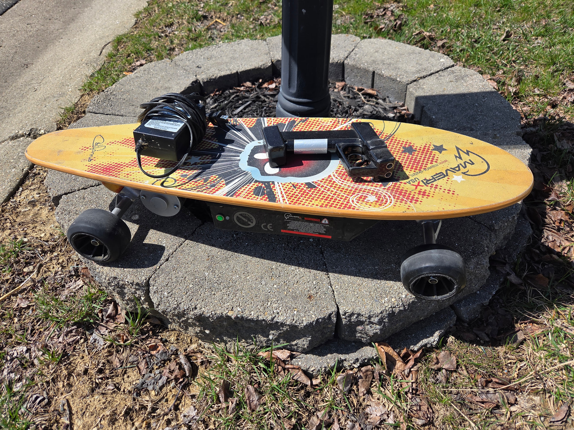

https://imgur.com/a/oZTJbS0 here’s a few photos of the hub, any help would be fantastic.
I believe you need to put something in those 2 empty holes on the silver rim and twist it to get access
I gave that a shot with the limited tools I have, but had no luck. I’m not sure if that plate is meant to rotate, but I’m just guessing. I’ll give it another go this weekend when I have access to better tools. Do you know of any company that sells 750W 90mm hubs for 12s packs? I might just need to buy a new pair for my board.
Id add a disclaimer that you should really know how to foot brake if you’re gonna ride a esk8 like this. At this point in time most esk8ers expect their board to be able to fully stop them with some urgency and without foot braking.
Ya, totally agree here and at that width you will absolutely have to make a spanner to do it - nothing not purpose fit is going to get the leverage you need. If you have a piece of bar or 2/4 sitting around you can try what I’ve done for explosion proof fittings in the past with some success (involving a lot of cussing and a little heat)
Make or use a vice or clamp that will attach to the black painted part of the hub - drill a hole in something and screw it down to it using those small screw holes in the black flanged part of the hub - make it as secure as you can. And don’t damage it.
(Just remember - it’s already broken so you can’t really break it. You can only maybe get lucky and fix the unfixable.)
Then take a lever sized 2/4 or whatever and mark the spacing of those two spanner pin holes on it - find a bolt or screw where the shaft is pretty close to the same diameter as the pin holes and drive it through the 2/4. You want the ā€œpinsā€ you add to this 2/4 spanner to be as accurate as you can - they should fit as snugly as possible in diameter and depth- and also the 2/4 needs to rest flat on the hub when they’re lined up.
I would try warming the hub but not cooking it - just a little heat and trying both directions to loosen it - ive seen these be left hand thread but obviously try right hand thread first (lefty loosey)
If that doesn’t work get a hack saw or band saw and open it up just to see if you were right about the magnets :grin:

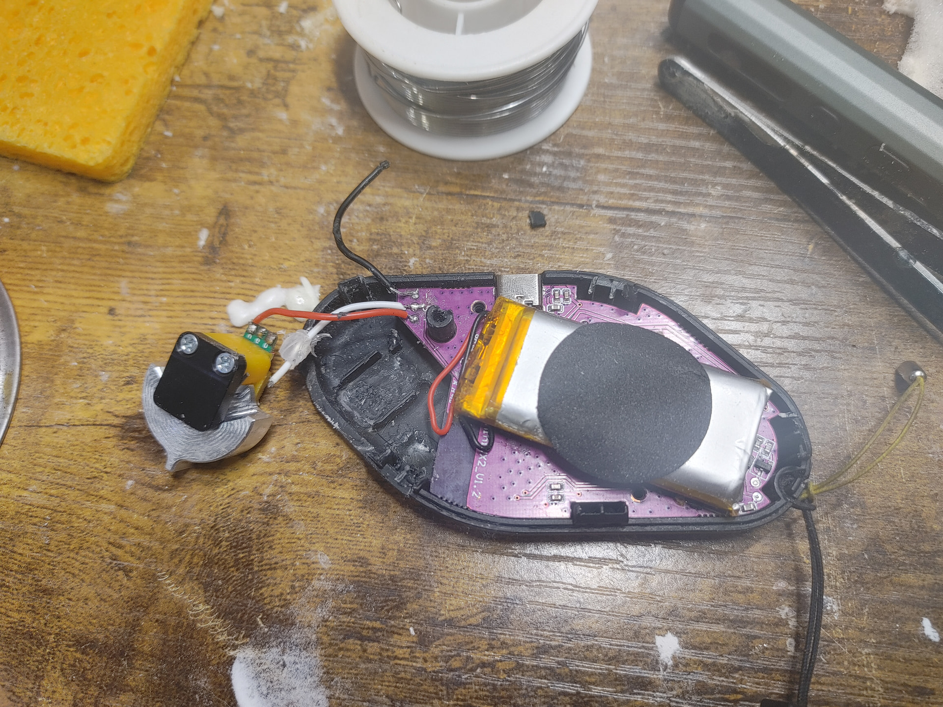

Does anyone know if the vx4 pro model is supposed to be able to pair to an original vx4 reciever? I almost lost my og remote and could not get the pro one to connect.
It might be because you need to put the vesc in pairing mode using the vesc tool but it’s been so long since I’ve paired my current remote that I dont remember.
Also anyone know if you can flash the pro to use the software on the original? I really don’t like the display being so messy and I can’t get it to switch the display even though it’s supposed to be an option.
Update: aside from some broken clips and the wires breaking it is fine. Not sure if the buttons are harder to press or if it has been like that for a while. I also can’t tell what scratches on the front are new or old
