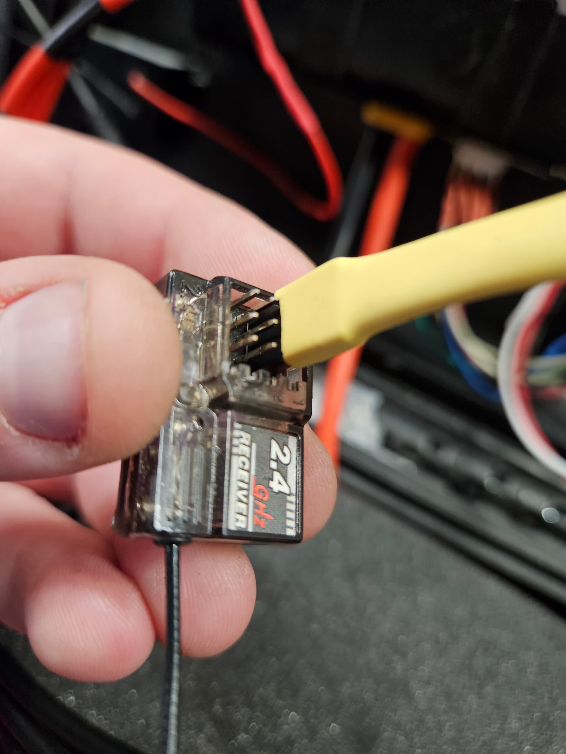

I am experiencing a continued throttle after a wheelie on my trampa. Currently I am using a amazon mini remote.
My vesc is a stormcore set conservatively at 65 motor amps per side, and 30 batt amps per side. The battery is a 12s3p 40t with a discharge bms capable of 60 amps.
Am I throwing a fualt on the stormcore or possibly the bms? Or would this be a remote/transmitter issue?
This seems to happen randomly but only after wheelies.
Thanks
I’d check the wiring of the receiver to make sure everything is good. Sounds like it might be a half broken cable there

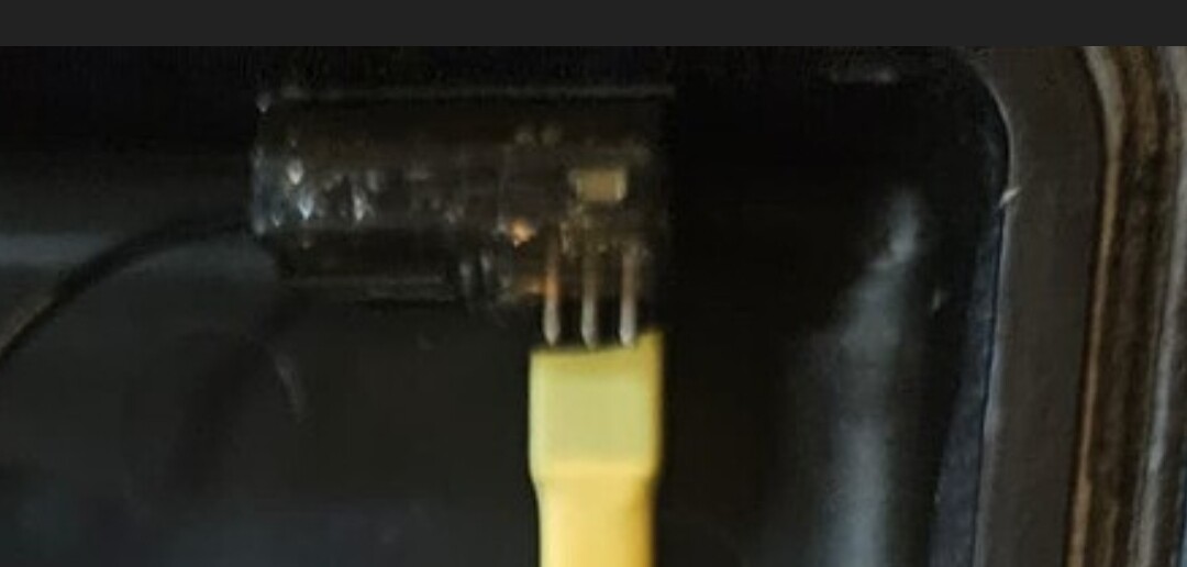

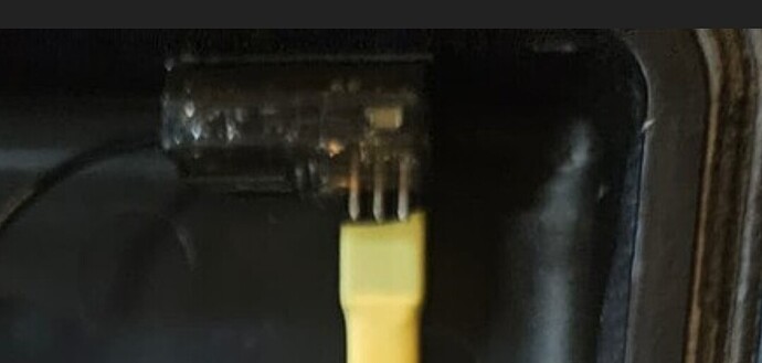

Thanks, ill take a look. I am fairly confident in the jst plug. Its one of those 2.4ghz receivers with the 3 prong. It is probably wiggling loose. Is it a bad idea to silicone it?
Probably have to do a continuity test on the cable to be safe.

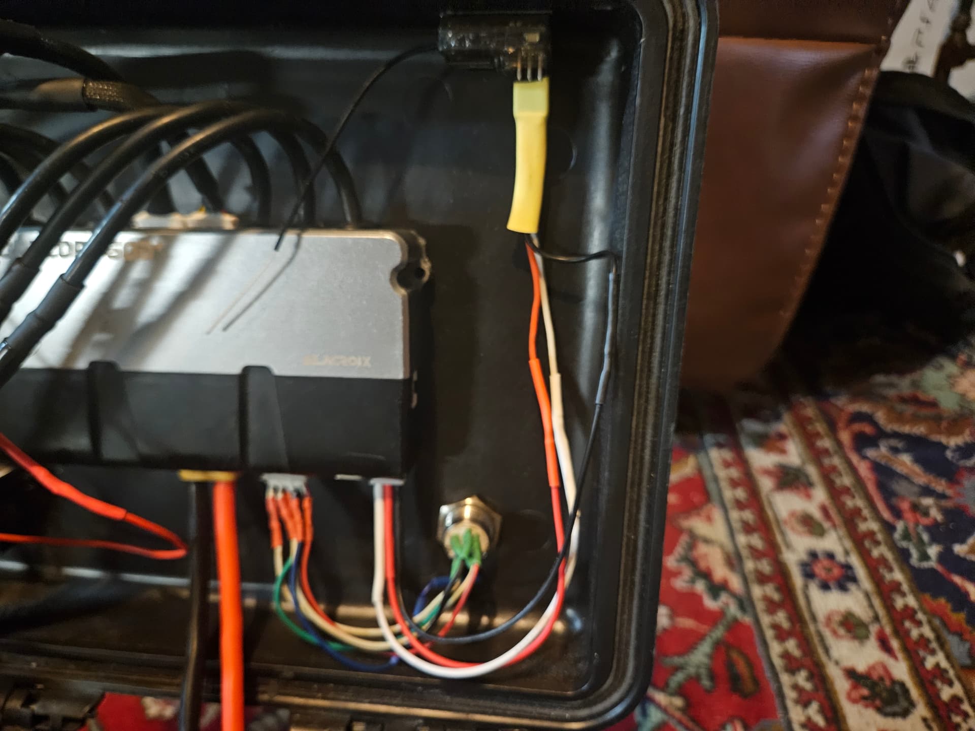

What would happen if the antenna was near/covered by the stormcore?
That looks like it’s pretty much not connected at all.
Adding glue would be a good idea to make sure it doesn’t disconnect
A broken or loose white wire can cause exactly that symptom. That symptom may also have other possible causes. Sometimes they will still work if the white wire is broken but still in physical proximity, but exhibit weird effects like that, and a wheelie can physically shift things around, causing it to happen at that time.
The heat shrink doesnt go to the end of the plug, because the pins interfere with the thickness
Its plugged in as far as she goes
Ooh it’s the other ports that made it look like it’s barely attached. Nevermind what i said then, you can still add a dab of hot glue on there though.

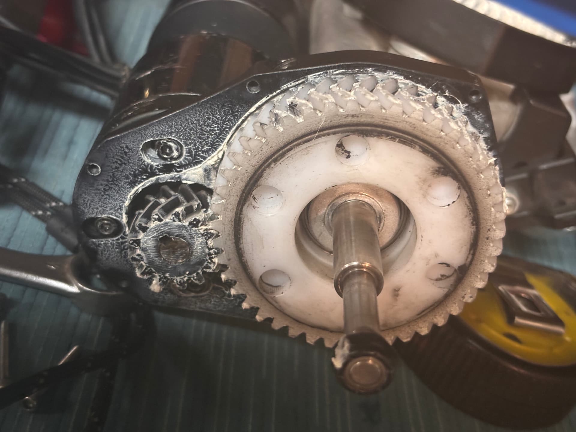

Can anybody identify these herringbone gear drives?

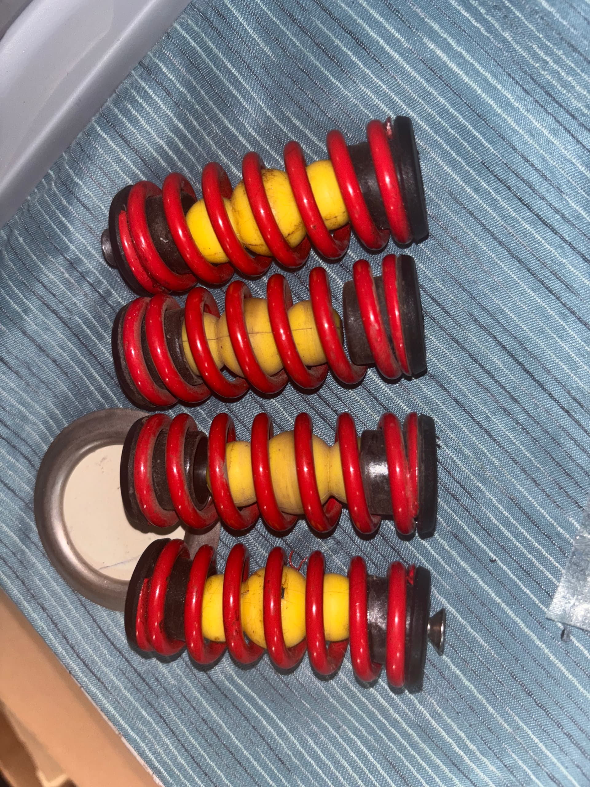

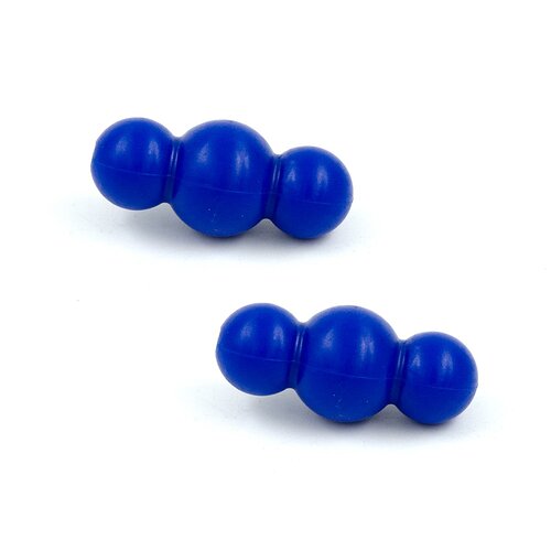

Or these trampa shocks
Looks like these to me
