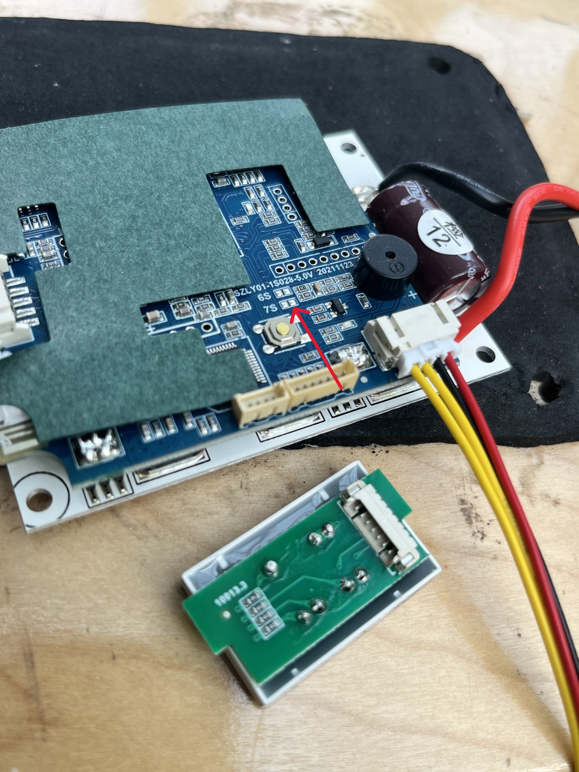

I think the current board is dead, won’t start up at all
I think the issue is potentially the Lingyi ESC is for a 10s battery pack, and I’m using a 7s ?
The translated specification was vague !
Yes very much so. The esc thinks the battery is depleted and won’t do anything.
That’s likely the problem. You’re probably running against a low voltage error
There are 2 contacts you have to bridge with a dollop of solder for it to work on 6 or 7 S. Near the squiggly antenna, if this is the dual motor version.
I don’t know about the single drive Lingyi

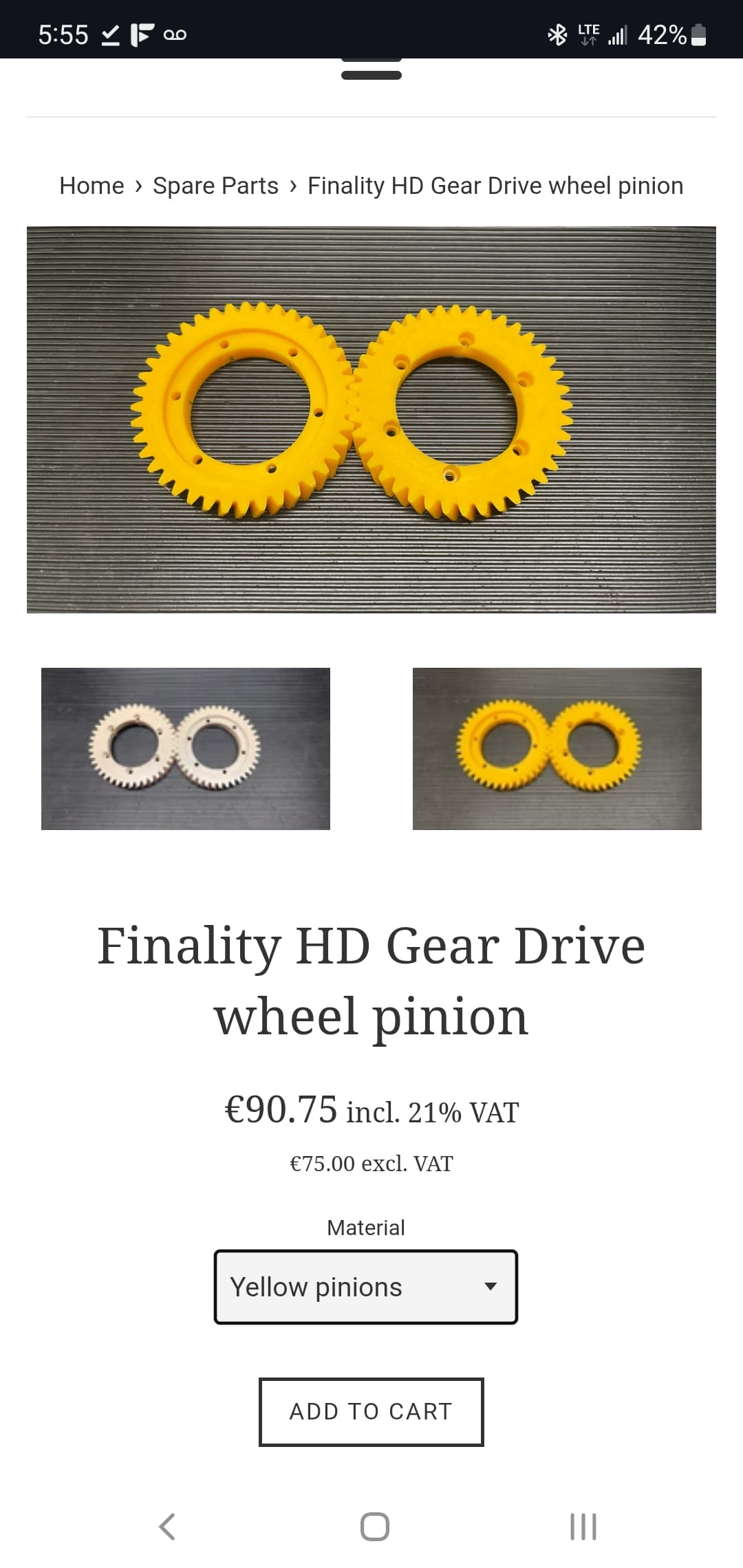

Is 3d servisas still going? I emailed regarding parts for gd purchased 2nd hand from here, no response yet. Just curious if he has stopped selling parts, or if my ignorance on which one of his gd’s i have has prevented him from responding, any insight would be appreciated?
I ordered replacement gears for a gear drive a bit over a month ago with no issues. They took a bit to get here, but that is to be expected with international shipping. I didn’t try to contact them, though, just placed an order.
Thanks! …. I’ll get the soldering iron out and hopefully we will be up and running !

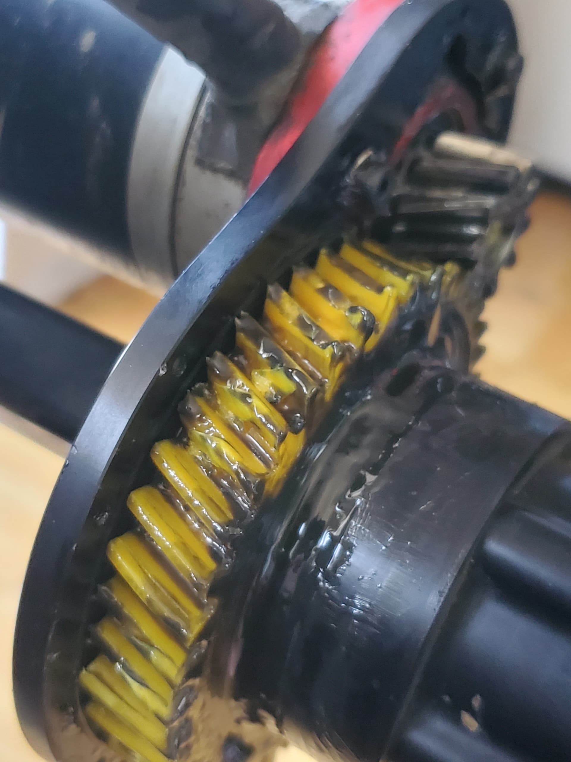

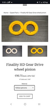

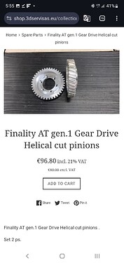

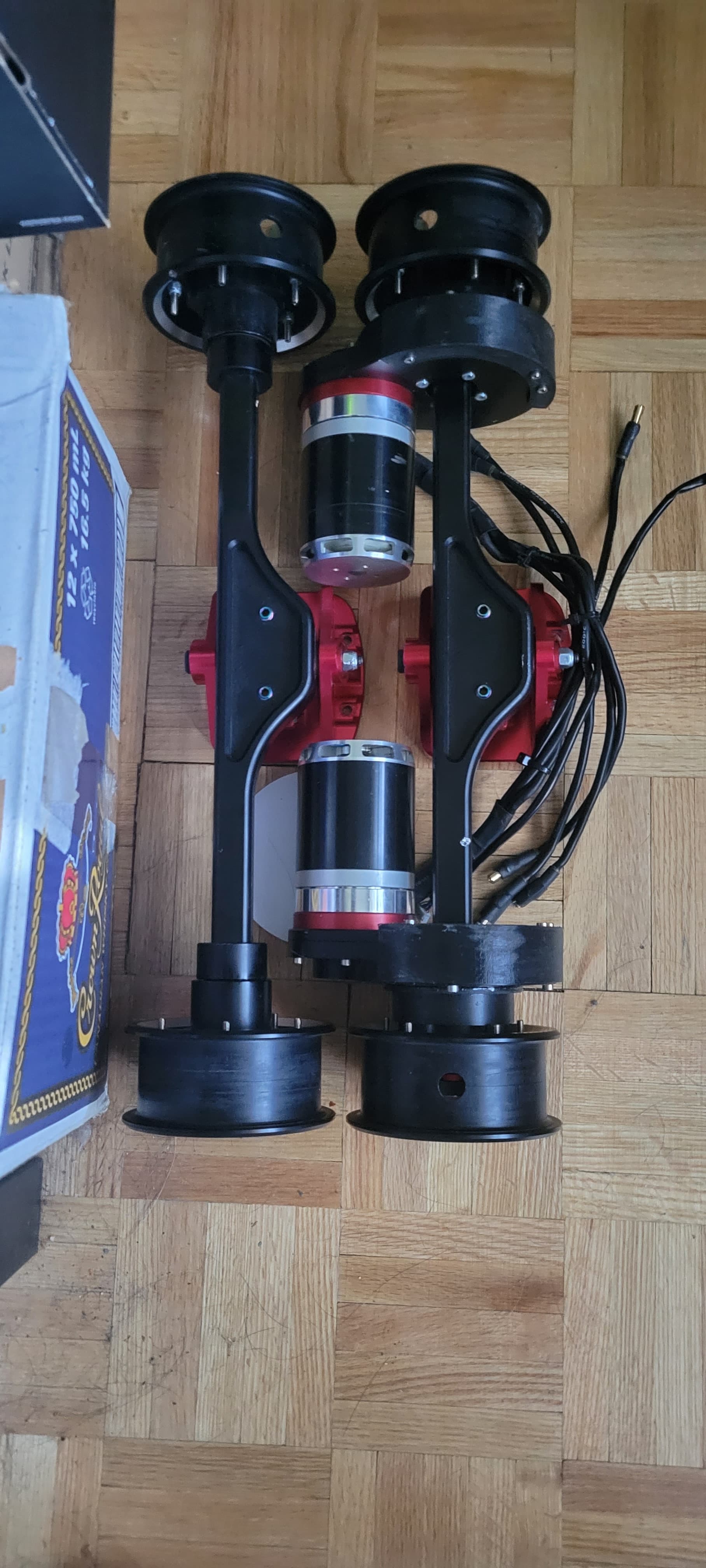

With that in mind, anyone know what ver. These are?
And i assume the metal gears are different, but i am curious as the more louder the more better. Otherwise i was planning on grabbing the peek gears?
And do i need seals or can i reuse if theyre in ok shape? Might grab a set and some bearings if im making an order, but just out of curiosity?
@3DServisas
They are on the forum of at least used to be. @3DServisas

I reused everything except the gears. I’m not really sure what those are, though. They look a bit different than my HDs, I think, but idk if that is just because of the wheel hub. It would be easier to tell if you removed the wheel hub. Also, one of your pictures has a shield covering most of the gear drive, which doesn’t help. Usually, the HDs have an aluminum piece that you put a TPU adapter around to attach to the wheel, and I don’t see any of that. The gear does look similar to the HD gears, though, so I’m not sure.

Yep, that’s sorted it
Many thanks , all working now
