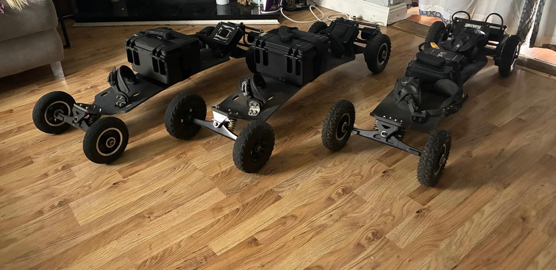

There are 3 old Trampas *near me going for around €800. Also some spare motors, turning sk8 motors and an MBS deck included. I think one is 10S6P another is 10S16P.
I wouldn’t take money before collecting them but would anyone want one *for €300 ideally someone in Ireland, @mr.shiteside you can have a discount. And does anyone know how best to ship batteries?

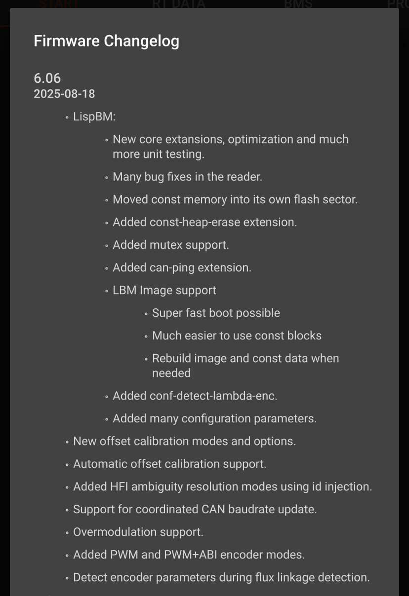

Has anyone tried the new update and knows what some of the “configuration parameters” and things are?

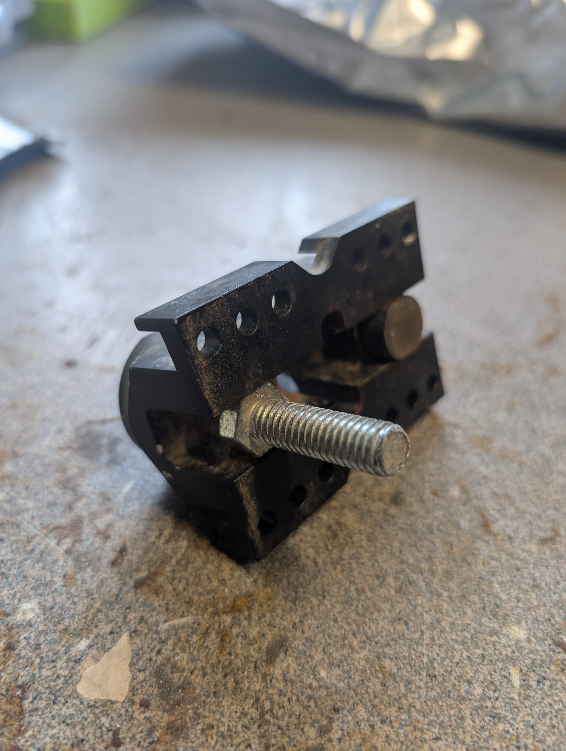

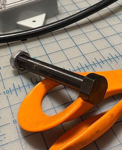

Revitalizing some Apex type PKP baseplates - What are these type of kingpins with an oblong head called and where do I look to get them? My initial google search just pulled up the hex head and press fit type.
I need four of them too. @BigBen mentioned having a small batch made but not sure if it’s still in the works.
Ah I see, didn’t expect them to be custom - if they’re not out there to get easily hopefully a regular hex head will work or at least be wider, not thinner than needed at the head so it could be ground down - anyone done that swap?
I just checked Trampa’s site. They use a 3/8 bolt on their IR trucks. Sure enough it fits perfectly in the Apex baseplate. Should be easy enough to get one that’s fine thread grade 8 or stronger at the right length.
Thanks! I didn’t have any hex 3/8 bolts to do that test - 2 3/4 inch is the length needed for mine - to note for anyone who might read this post mine are Moon prototype PKP baseplates not Apex ones so they might have a different spec on length.
