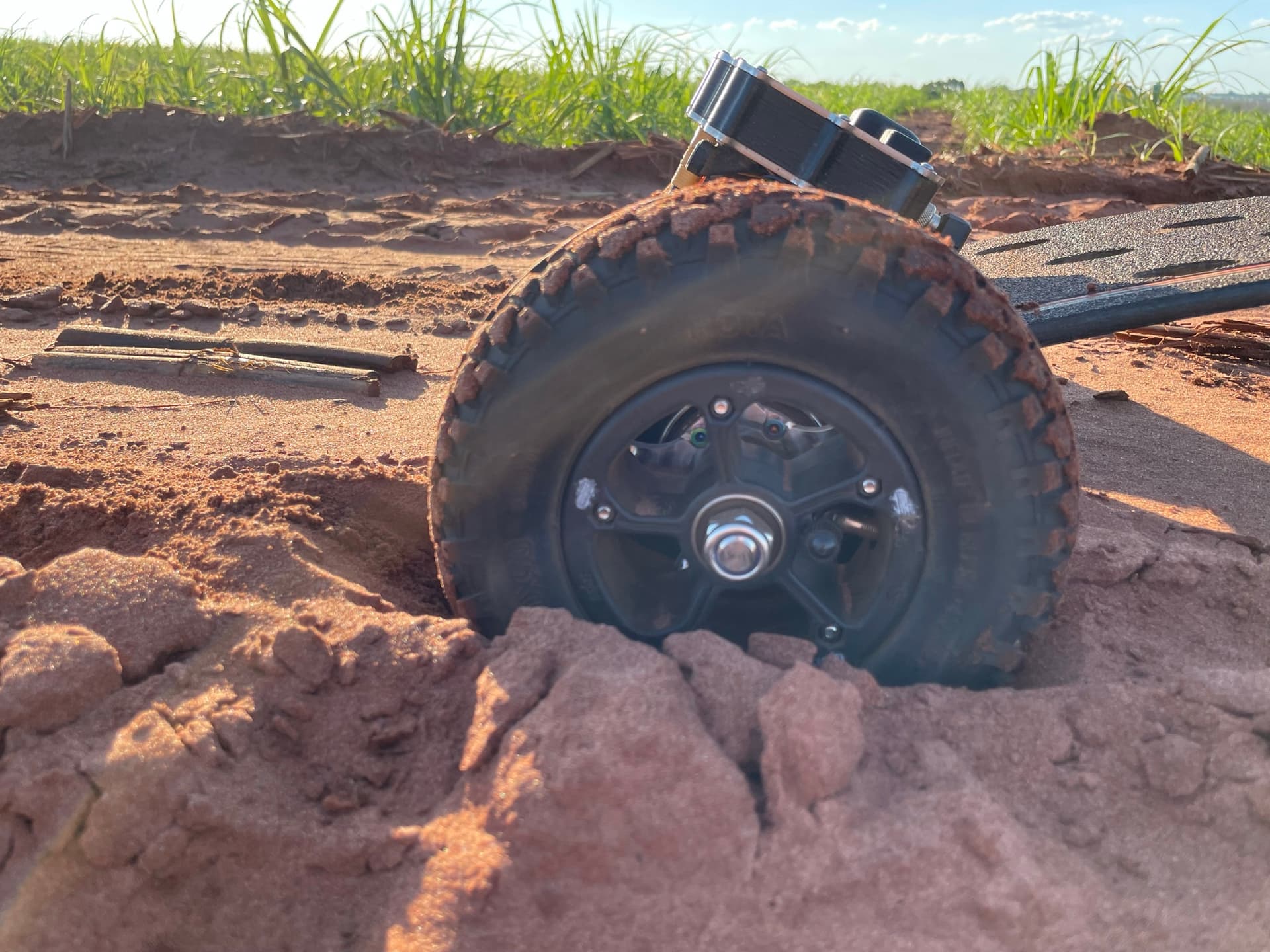

Been riding it when I can and it’s really nice, at first I was thinking the Hypertrucks might be too wide for off road use, but didn’t seem to be a problem, and on sand, it’s even better, the width make it way more stable and you can keep the board straight and just focus on not getting bogged down, which not always works, let see how the 9"s handle that
The motors have plenty of torque, I’m running then at just 60 A, which should give me around 18 N.m of torque on each wheel, the previous setup in theory gave me 22.5 N.m, but there is no comparison.
I could get stuck like above and the wheels wouldn’t turn even at full throttle, now I can dig myself deeper and deeper and make a sand fountain without even going full throttle

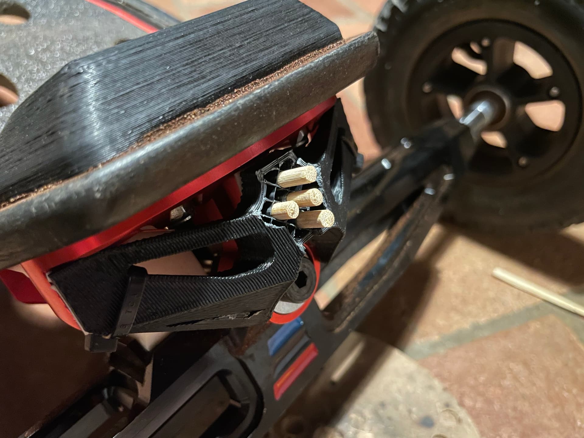

All that aside, got my first damage already, light support broke because I forgot to change the perimeters and infill when printing, and since my printer is also broken and I can’t figure out why, I put my title to good use and repaired it using rubberized CA glue plus barbecue wood sticks as dowels
