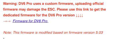

can anyone confirm this is okay to use on the DV6? VT is warning me I’ll for sure damage my HW if it’s wrong

MakerX uploaded the “5.03” DV6 FW on their web
https://drive.google.com/file/d/1-OFkWbNUdvaoxpzLMdFi-aAycK7J7GMT/view?usp=drivesdk
That is a bin, not the source. I wonder where the sources are.
Indeed they uploaded it and must make the source available, but this is only for the PRO. The regular DV6 can use the official version I linked above (is the one I’m running right now)
Ask them for the source.
It’s not optional; they are legally required to comply.
That new binary they uploaded is not reading as version 5.03 in the new BLDC tool 3.01 either. I have flashed it successfully on a DV6 Pro using an ST-Link V2. I confirmed it is being successfully flashed by intentionally writing all zeros (temporarily bricking) and confirming sad boot, then flashing the new bin they uploaded. The VESC tool still reports it is 5.02
